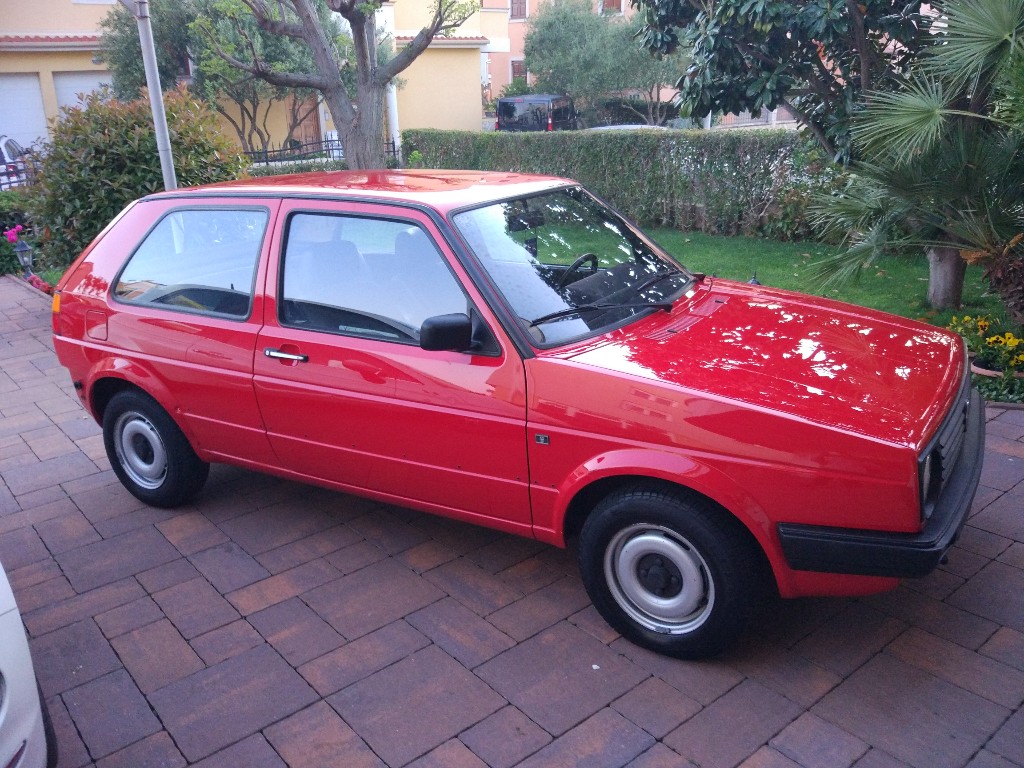

    Hello all. Here is my Golf mk2. Bought him 2 year ago. Original paint , 1.6 5 speed engine , 85000 km.
    Soon will do swap 2.0 8v 2e.
    This is begining

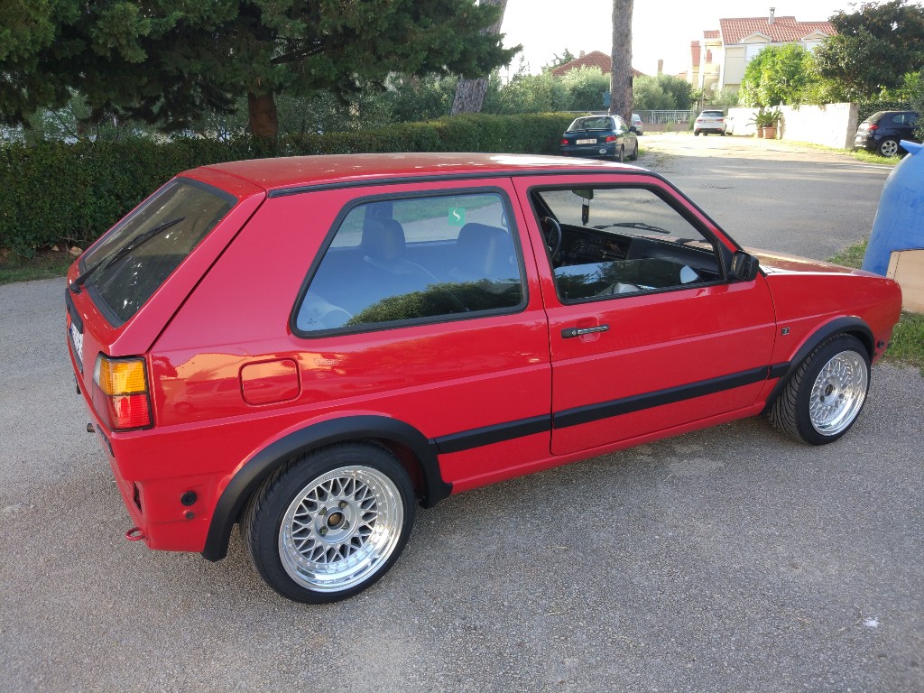

    First car is polished and get some stuff. Body plastic is refreshed.
    Wheels on BBS RM Front 8x15 rear 8.5x15. Tyres 195/45/15
