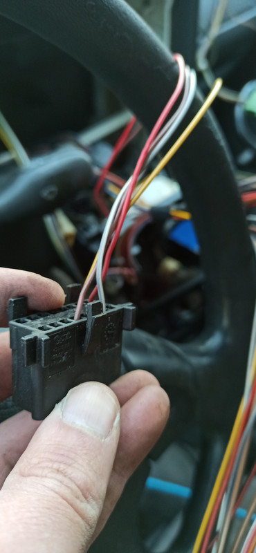

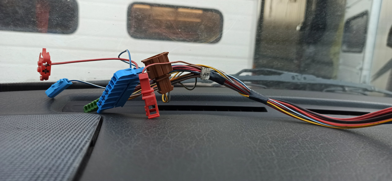

    everything is working well. last thing which i need to resolve is obd.
    i find connector near the steering wheel.
    this black connector
    and then wires go in two directions
    and this is end which go to fusebox
    rub you mention to me some jumper block how is look like?
    ah ok so no jumper block for yours, just the 2 pin brown plug near fusebox with the grey/white and yellow and your red/white live and brown earth go off and are tapped to the ciggy lighter wiring somewhere. split the loom down and pull out those wires, cut the power and earth where they're tapped in and splice the ends into the mk2 ciggy lighter.
    then all you do is plug the brown 2 pin into the engine loom brown 2 pin and you're done :)

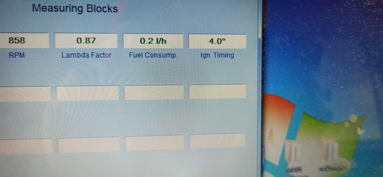

    thank you is all working now. vagcom is connected there is few basic information but good to scan for errors and delete them.
