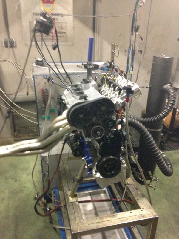

  8. MasterMike New Member
    Jun 11, 2016
    37
    Hellevoetsluis The Netherlands
    Just some random pictures of my engine during the build.
    So you can have an idee from all the work been done

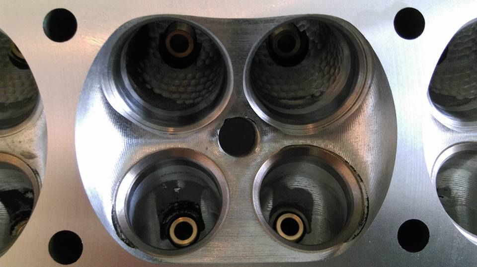

  9. Toyotec
    Thanks for sharing the pictures.
    As you mentioned NG-Motorsports, who many of us know are the same company used by 16Vampir and Boba Kettler in their 1100+ bhp EA827 16vT builds, did NG motorsports give you the option for the Golf ball type porting in the intake? Or was that idea not entertained as you wished to keep the build spec close to the kit car engine?
    Pic from NG-Motorsports FB

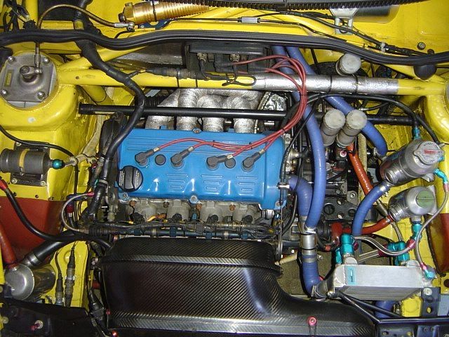

    I like the custom air box being created as well.
    [​IMG] :thumbup:

  10. MasterMike New Member
    Jun 11, 2016
    37
    The head as been at NG-motorsports for about 3 years ago, then the golf ball porting was not a big thing.
    What we wanted to do was keep the specs near to the specs of the kitcar and see what power numbers it was going to make compared to the previous big port engines that were build by KMS.
    The original kitcar head was not brilliant ported either!!
    At the end this head flowed better than the bigport heads, and with an higher airspeed for the lower engine speeds the kitcar (rally) needs compared to the STW and other track related engines.
    At first I wanted to build an closed airbox, but you loose too much sound from the itb's.
    So I will try this trumpettray with an ITG airfilter and build an airscoop over the radiator till under the itb's.
    And later when needed build an airbox

    That does make sense as it was only 2 years ago NG started to advertise the 'Golf ball' effect.
    My reason for asking was, such intake porting has caused a buzz of debate from engine builders here, regarding it's effectiveness on turbo cars, as there is a general view it is more beneficial on NASP cars as yours.
    Maybe not as good as now, as companies such as NG-motorsports are able to perfect airflow and cylinder tumble/swirl motion, thanks to CNC machining. Back in the day that head did the job as show in the clip!

    What you describe re air speed, has also been observed when small port heads, ported or unported, are used on turbo applications as well. I am of the opinion this was one of the reasons VW/Audi reduced the size of the ports on 20v and 30v engines. Customer low down response is taken pretty serious by OEMs.

    Your idea for a custom airbox looks to end up looking something like this
    [​IMG] :thumbup:

    It is known that it is best not to polish the intake port but to keep a certain grain in the surface.
    The air tumbles over the surface creating rollerbearings of air, creating low drag of the aircolum.
    In the clip you see the mk4 kitcar, but I don't like the sound of this car. Maybe due to soundregulations on that track.

  20. HPR
    HPR Administrator Admin
    Aug 11, 2009
    1,827
    With a Port Injected engine the intake ports are made coarse to avoid wall wetting, as this goes at the cost of airflow
