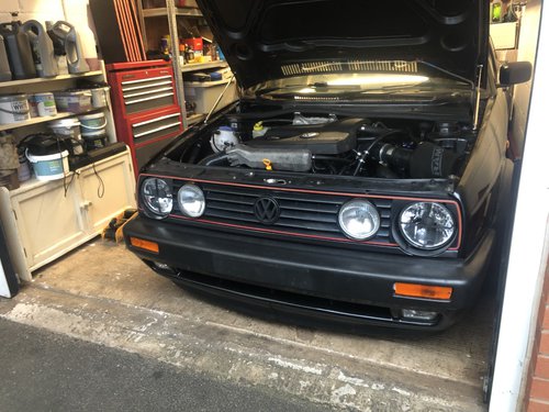

    Anyway I got the old girl out the garage on Saturday morning!
    Started off with all the basics like fluid levels and tyre pressures, all good! Noticed near side sidelight was out... gave it a wiggle and it works again?!

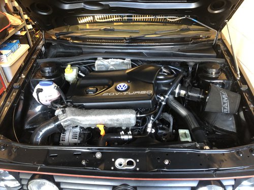

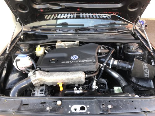

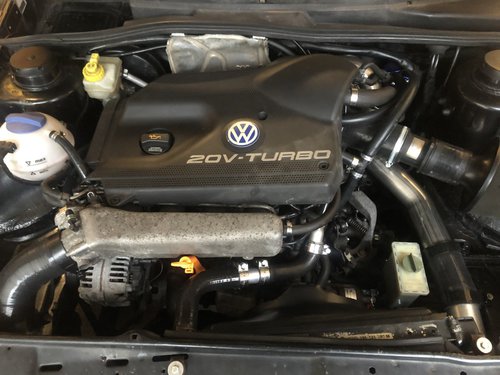

    Had a list of niggles that I wanted to sort, starting with the radiator coolant pipes which I had just bodged when I first did the conversion, also added some nice t-clamps. Did abit of piping and cable tidying at the same time. Ran the car and topped up coolant.

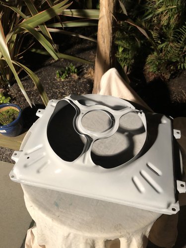

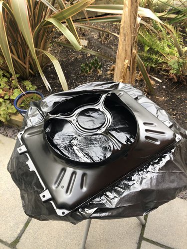

    Took the radiator surround out aswell for a quick rub down and then sprayed matt black

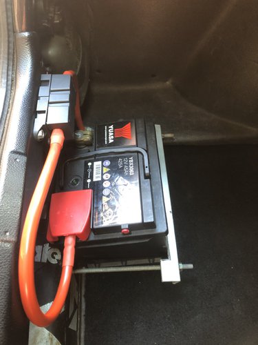

    Next was to make a new battery cable with the 40mm I purchased a new weeks back. Also added a mega fuse holder with 150A fuse in the boot. Car now starts instantly which is what I was after!

    ooh i quite like how you have mounted the battery in the boot! did you just put a couple of riv nuts in to the metal at the back?

    Not trying to criticise, but I'd add a brace to hold the battery "down", not just clamped against the rear, unless you already have?
    Or another option would be to put that angle ally on the top edge of the battery, I've seen lots of OEM installs like that.
    I only say this as i volunteer as a motorsport Crash/Rescue official, and the inertia behind a weighty item such as a battery, in the unfortunate incident of a crash, is crazy and makes missiles out of them.
    You literally can't strap stuff like that in too securely.
  8. jshep73 Forum Member
    Jan 5, 2015
    83
    Bristol
    Thanks Tristan - top advice
    The battery has been clamped like that since I bought the car 6 years ago. It is clamped up tight as heck with no play. However now you have said that I will come up with some sort of brace.
    My photo was just to show new power cable and fuse!

    I'm very impressed with the wiring tbh, hardly anyone bothers with the big fuse. Top job fella. Neat.

    Apologies Craig, didn't see this reply! Just a couple of nuts and washers

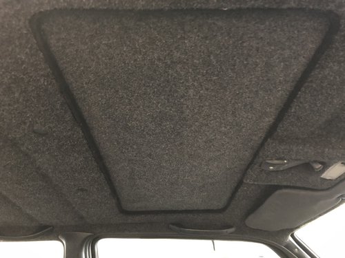

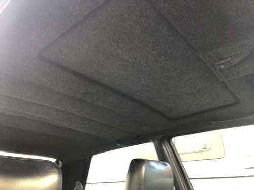

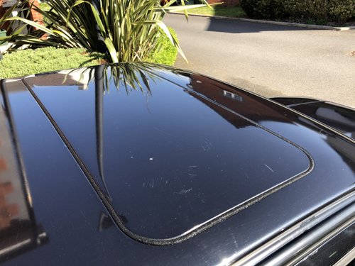

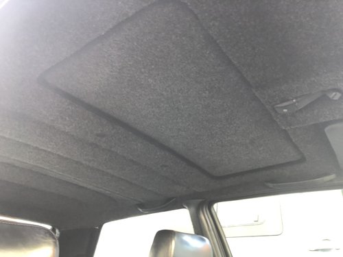

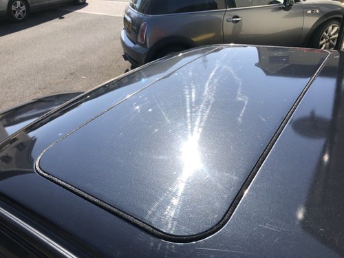

    This was actually done a few weeks back but I took some photos to prove it! New OEM sunroof seal which wasn’t cheap but now there is no water on the seat after a wash; so I guess it works. The job itself is fairly easy after watching a couple of how to videos. Took a few hours in total but that included cleaning up the sunroof area whilst it was out and also running steel cable down the drain holes to ensure they are clean. And as usual when doing a job it leads to others – I decided to cover the headlining and sunroof to match.
    I always see people on forums and FB groups asking about this job but it really is simple. Undo everything attached to the roof lining, slide it out the back and cover it with 4 way stretch carpet. Pleased with the result, looks factory (to someone that doesn’t know what the factory head lining should look like).

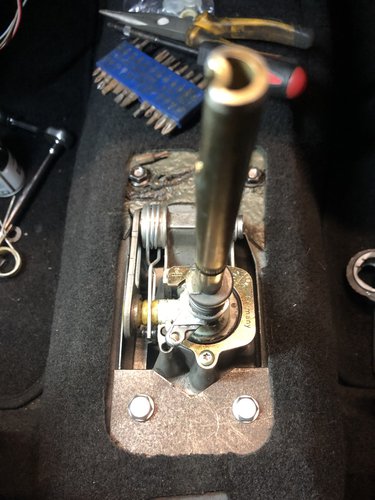

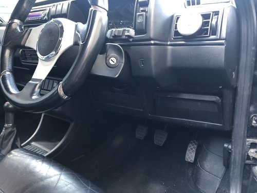

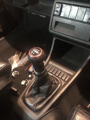

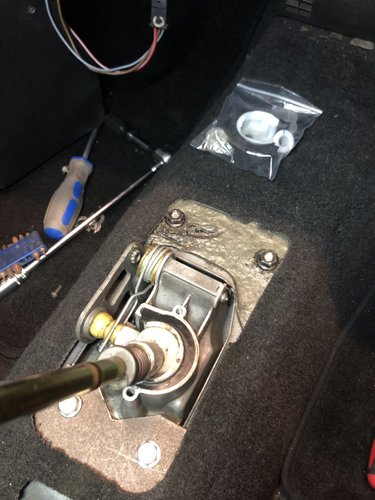

    For some reason since the conversion the gearstick would not centre itself, it was ok in the donor car (02J gearbox/tower/shifter/cables). Did a bit of research and looks like it is the spring that centres it, pretty obvious once you start looking and moving the gearstick etc. Ended up buying an OEM spring/bush kit which is very easy to fit and has worked wonders on the general feel of the gearstick and shifting feels very tight now. Also fitted a gear knob with a red surround as I really disliked the chrome one!

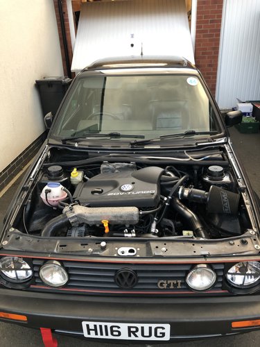

    Thought I should mount a fire extinguisher as it is an old car and after all everything has been installed by me!! After looking at a few mounting positions I decided with the simplest for now…

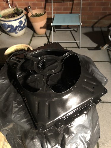

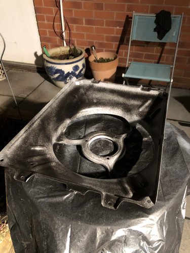

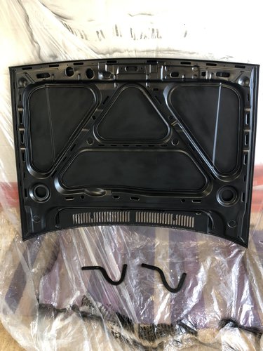

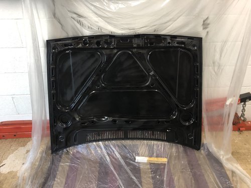

    Finally got round to spraying the underside of the bonnet. My bonnet is clearly not original as it used to be red… Can’t believe it has taken me this long to tidy it up!!! I don’t think much of the bonnet hinges, both of mine had so much play side to side. Fixed with a washer but as they were off I had to spray them up of course! I hung some dust sheets up in my garage and did 3 layers of matt black.
    Photo above is wet paint which looks patchy but once dry it looks decent, matt black spray paint is very forgiving even on large areas.
    Just noticed I haven't got any photos of the bonnet back on.

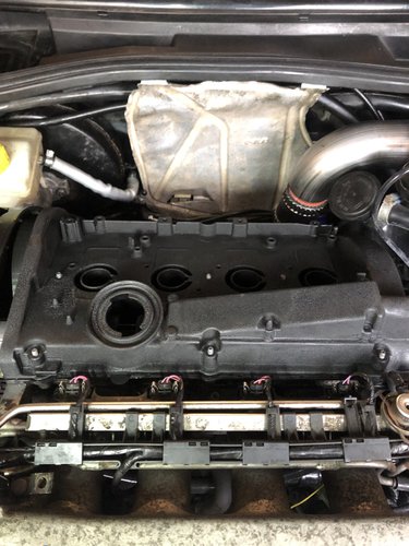

    Managed to do abit more last week. Replaced the rocket gasket and then decided to spray the rocker cover. Tried out the VHT wrinkle paint that I have seen alot recently, counterintuitive to use though as you have to spray it on thick
    Especially as I like have the engine cover on anyway! [:$]
    May do the intake manifold with the same stuff as I have another can. When I have a spare 10 hours anyway :lol:

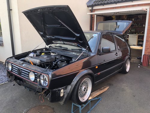

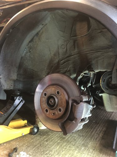

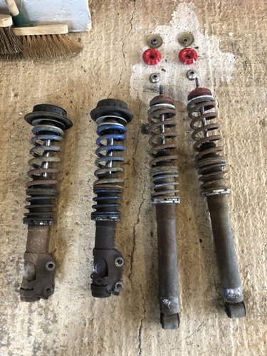

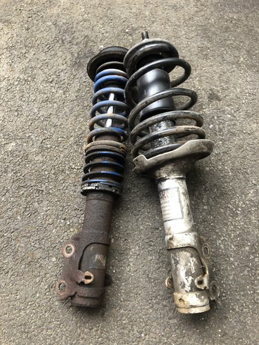

    Finally did something about the ride height!!! Someone was selling a H&R setup on FB so decided to go for it. Bought new mounts and plates and got the job done fairly quick once I had the correct tools. For anyone that doesn't know you need a tool for the rears to hold the shock as you undo the bolt, then you need another for the fronts. Then you also need a 19mm go-through socket on the fronts for the top nut.
    I would advise not jacking your Mk2 on the jacking point nipple as above if you have not repaired / strengthened it!
    FK coilovers removed
    End result is Golf Mk2 Country...
    Night and day difference. Almost like a normal car now!

    No comparison with fk and H&R!

    I would advise not jacking your Mk2 on the jacking point nipple as above because it’s not a jacking point ;)
    Looks good tho, good to see you enjoying it!
  17. rubjonny
    it bloody is :lol: just dont use it becasue its probably rusted away underneath

    What dya mean?! It was intended as a jacking point wasn't it???

    Indeed! Hard to beat proper struts. Car is a joy to drive now
