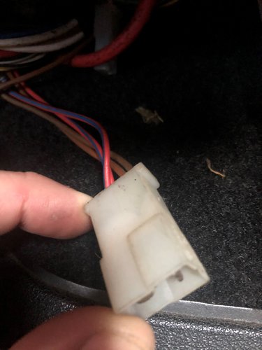

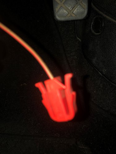

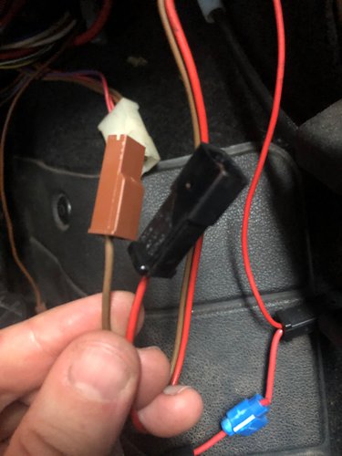

    More unidentified connecters around the fusebox if anyone has can assist...
    Only 2 terminals, but 4 wires
    A pos and reg that goes into the door pillar
    And this single wire with odd connector.
    Updates to follow on the car.... Including; exhaust, clutch, grill, and hopefully an MOT!
    2 pin is headlight range control motors, ignore
    1 pin red is live for interior light and goes to the matching plug on rear wiring loom
    1 pin brown is earth for interior light and goes to claw
    1 pin red/brown is key-in-ignition live for the radio from pin SU on ignition switch to a wire on the dash harness
    Vinnie and erreesse like this.

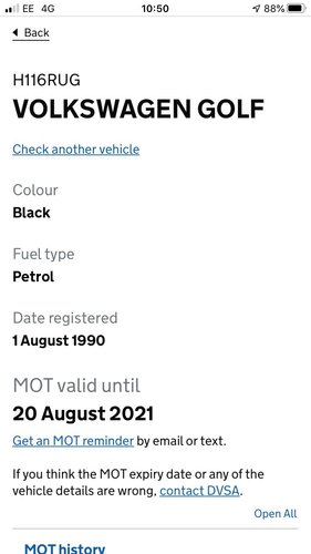

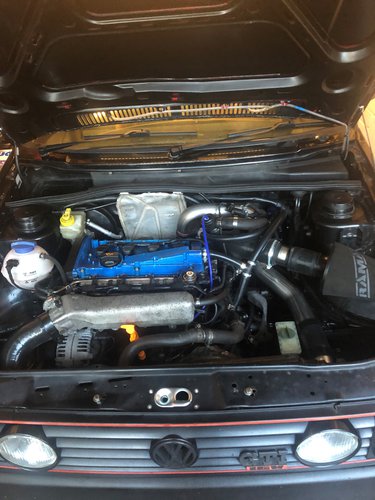

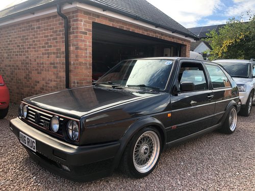

    Well, the conversion is officially finished!
    MOT last Thursday. My regular place was booked up for 2 weeks so tried a new tester... Was fairly confident of a pass, however on the way the nearside indicator did the doubleclicking thing - Probably the front bulb as I put clear indicators on for the MOT. Little bit annoying.
    Anyway got a phone call to say if it was only the bulb he would have passed it, but the offside front wheel bearing is very bad! Strange as I didnt feel it and it's not been an advisory before. So I went to the garage for a chat, the MOT tester has a Mk2 and all the lads have Beetles, Transporters etc. He said if it is really bad the hub could be damaged and need replacing... or the driveshaft nut could be loose. I took the cap off the wheel and NO DRIVESHAFT NUT!! Idiot.
    Anyway I found the nut in my garage and picked the car up Friday morning. Spoke to a different bloke this time. He said I must have paid alot for the professional engine conversion! I said I did it in my garage! He seemed impressed that I could manage that and not check the car has driveshaft nuts on.
    So quick re-test and job done! Very chuffed that there were no issues with any engine / conversions parts that I had touched.

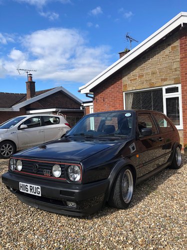

    So put a few miles on it over the weekend. Engine pulls well, gears feel solid. No leaks, no overheating. Very happy. The only issue I can think of is the slightly notchy steering. I don't think the steering wheel is physically sticking on something, it's notchy for another reason. I am running the Mk4 power steering pump but I have red fluid as per mk2 spec. What's the best solution here as the pump is mk4 but the rack is mk2???
    Couple of photos of me letting my girlfriend take over...
    Booked into Badger 5 for some mapping next month because currently car is a poultry 150bhp standard.
    Future plans include brake and suspension upgrade, maybe over the winter

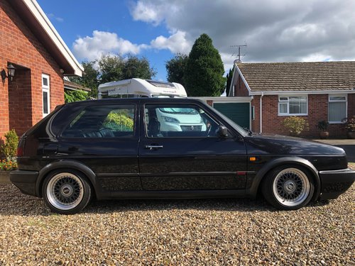

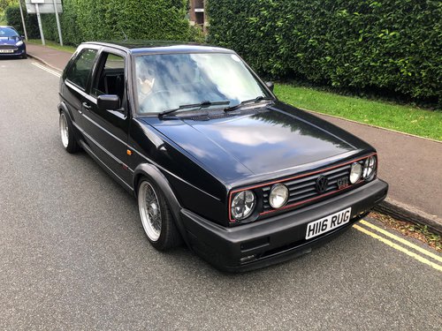

    So I've put a couple of hundred miles on the old gal in the last couple of weeks, car is getting more attention than ever from random people!
    A few photos what I took...

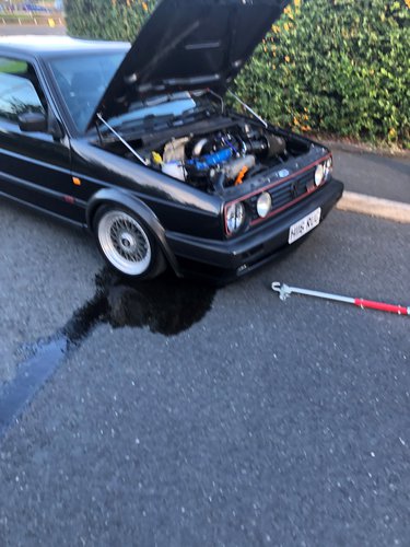

    Saturday I went to pick up a pal to go the pub, turned into an industrial estate to cut through it and BANG. Looked in the rear view mirror and I was loosing all my oil. Smashed the sump already!!! About 200 miles it took me
    So that was a joy. Towed it back to my mates driveway and went to the pub. Whilst there I decided a shallow sump would be the best option to avoid the same thing in the future. However the ECS Tuning one that Awesome GTI sell is on a long back order. I am booked into Badger 5 next week to I have just ordered a standard sump and oil from GSF. Hopefully it will be up and running in a couple of days although I haven't jacked the car up yet. Maybe I should raise the suspension and admit to my Dad, my mate, my girlfriend, work colleagues etc that the car is too low. Hmmmm.
    What are my other options? Some sort of engine mount raisers?
    Oh well, onwards and upwards!!!

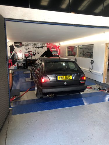

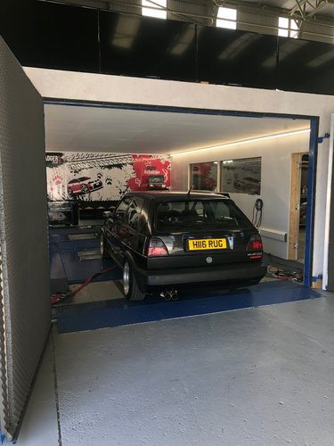

    Haven't posted any updates for a while.
    Couple of months ago the car went to Badger 5...
    Since the engine conversion the engine had been idling at 1200rpm, I assumed it was a vacuum leak that I couldn't find. Bill said he thinks it is the throttle pedal but there was no code showing. This meant I had no boost at all! So Bill flashed a map from a similar spec 1.8T.
    I got the car home and ordered a used throttle pedal, installed it a couple of days later. I revved the car and the boost gauge flew up - time for a drive.
    In short - the car is absolute monster!!! It is so much fun to drive. It pulls HARD all the way to the redline and the exhaust sounds perfect. However it spins wheels in every gear in the wet, I have to drive very timidly! Maybe my Toyo Proxes are an issue. I will be changing them soon.
    Even in the dry the wheels spin in 3rd gear if you are driving hard. I spoke to Bill and told me to put some proper tyres on! And now the car is actually boosting he can map the car so the power is more progressive.
    Anyway the car is in my garage until March-ish time.
