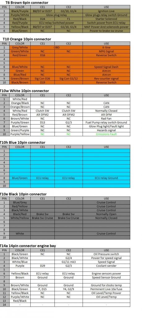

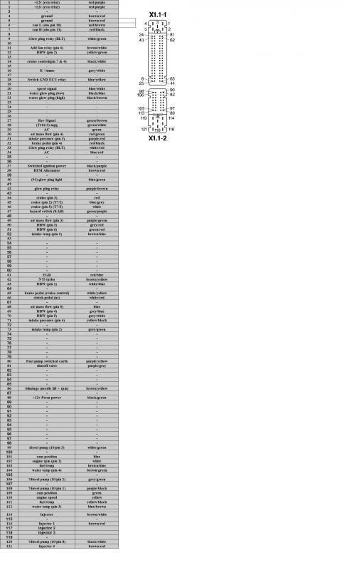

    I have made a spreadsheet of the PD connections for CE1 and CE2 conversions. Like the great info Rubjonny did for the 20vt wiring. And Also the ECU pinout (EDC15), Although this hasn't come out very well.
    If anyone spots and mistakes please let me know and I'll update it.

  13. rubjonny
    only a couple corrections on the plugs :)
    T6/4 - permanent live
    T14a/10 - x-over live (live ignition on but NOT cranking)
  14. scruffydubber Paid Member Paid Member
    Apr 28, 2004
    15
    Dubhampton
    With regards to the gearboxes. There are loads to choose from.
    If you want low revs high cruising speeds look at the bluemotion cars. Alot of the bluemotions use 5 speeds
    If you want 6speed, you can go for a 02s box as an alternative for the 02m, you can then fit it with the original drive shafts and mounts.
  15. scruffydubber Paid Member Paid Member
    Apr 28, 2004
    15
    Dubhampton
    Not on the information and looms I have. But happy to be proved wrong.
    T6/4 goes to ecu pins 1 and 2 which is power switched by the ecu relay, permanent power at the ecu relay.
    I should also mention T14a has a different pin out on the fabia/ibiza/polo. And some cars don't have the permanent power connection at all.

  17. rubjonny
    You are right about T6/4 [:$]
    what ecu code are you looking at for the T14a? On my MK4 1.9 diagram its showing it to ignition switch pin X which is x-over live
    scruffydubber likes this.
  18. scruffydubber Paid Member Paid Member
    Apr 28, 2004
    15
    Dubhampton
    Ah yes does seem to vary. Just seen the same as you say on a ARL diagram.
    I think the ECU edc15 info said permanent live. But I can't remember the source of that info (I'll see if I can find it again)
    A fabia diagram I have it doesn't exsist (although it does exsist on my fabia loom). And a ibiza loom I had didn't have it either.
    Hhhmmm, Any ideas what it's used for?
  19. rubjonny
    the one I'm looking at is ASZ and ARL diagram, for this one T14a/10 goes to ECU pin 88 but what its actually for I cant say :lol:
