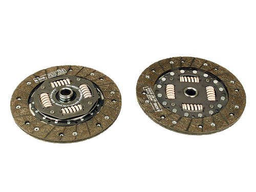

    021141031D_jpg.png Been researching till my eyes are strained lol,appears this clutch plate Sachs number 021 141 03D is for all VR6 powered corrado ,passat,golf with 02A box,I have based my search's on US spec due to the difference in gearboxes used there as opposed to ROW cars.
    Autohaus AZ have a plate with the correct part number for $99usd which is discounted down ,shipping is $9usd to my NZ based freight forward shipper in Portland Oregon...thought that is a pretty good deal and I will buy a new slave cylinder from them @ a further $60usd.
    There will be a lead time but by the time I get other cleaning and prep work its not really an issue.

    Hi,its certain bigger than 210mm and not an 020 box as it is cable shift and hydraulic clutch,yes it surprises me to the clutch is this big.
    Have checked flywheel,thrust bearing and pressure plate and all good to use again,but as mentioned may get flywheel ground,cheers.
  6. Tristan
    1,286
    Ah, well, cable club so, probably an ABF or G60 clutch.
    3,576
    all the corrado use the 02a type gearbox with '228mm' clutch except for the early 2.0 8v which had a smaller one at 215mm but those are like rocking horse.
    so yeah, get a corrado 16v/g60/vr6, mk3 16v/tdi/vr6, various seat etc 228mm clutch and you'll be fine. They vary in torque rating, but as you only have a 1.8 16v you can get whichever kit is cheapest and be off on your way. I'd only use sachs make :)
