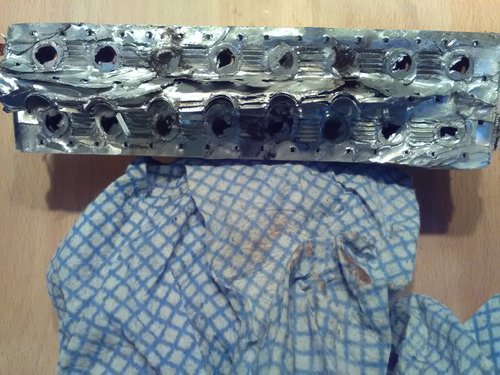

    So with the promise of a dry albeit cold day we cracked on with the replacement of the heater matrix. I won't bore you with what has been reported many times but, we have heat! :clap: In fact, almost instant heat, what a difference.
    Without a doubt it would be an easier job with the entire dash out but it's not too bad with just the lower sections. I watched a couple of Utube vids but they never manage to include all the bolts and screws do they?

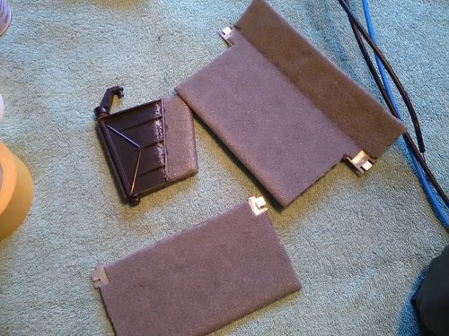

    Did the flaps as well of course. I used the foam I had left over from the head liner.
    Total time taken was 6 hours including new foam and a test drive.

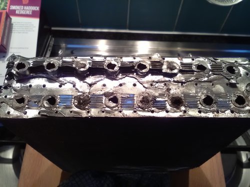

    Afterwards I cut the old matrix open out of interest. At first I cut the inlet outlet end and all the tubes were clear. Then I cut the other end and you can see at least 4 tubes are blocked. I suppose it only takes one tube and it's done.
    Air flow is much better as expected. All in all, very happy.

    For mine would a hosepipe jammed into matrix hose pipework for half an hour improve things or is the blockage rock hard
  14. PhilRyder
    I tried that and I also did a coolant flush with a cleaning additive and it made no difference. I would say that leaving the hose in doesn't work because the water takes the route of least resistance and therefore doesn't go down any blocked tubes, just in and out of the two main pipes. In my matrix the blocked tubes are properly blocked and would need mechanically cleaning out which would be all but impossible.
    I would add that the date on my old matrix showed it to be the original one. Doing this job once in every 20 years is not so bad.
