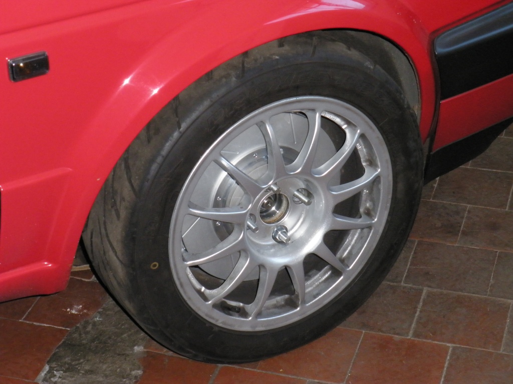

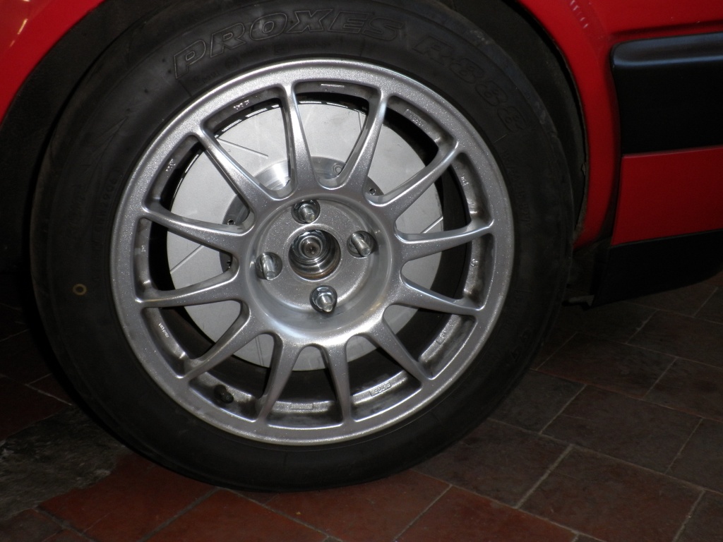

    Widetrack being part of the build, utilising vr6 front hubs (plus axle) with 4x100 drive flanges, and longer drive shafts. The car runs lightweight 7x15 pro race 1 rims, which will be retained. Brakes being a must have on the power potential this car will have.
    Tricky as hell to fit as large a disk as possible onto the 7x15 et35 rim, on VR hub. Pictures below show whats occuring.. :)

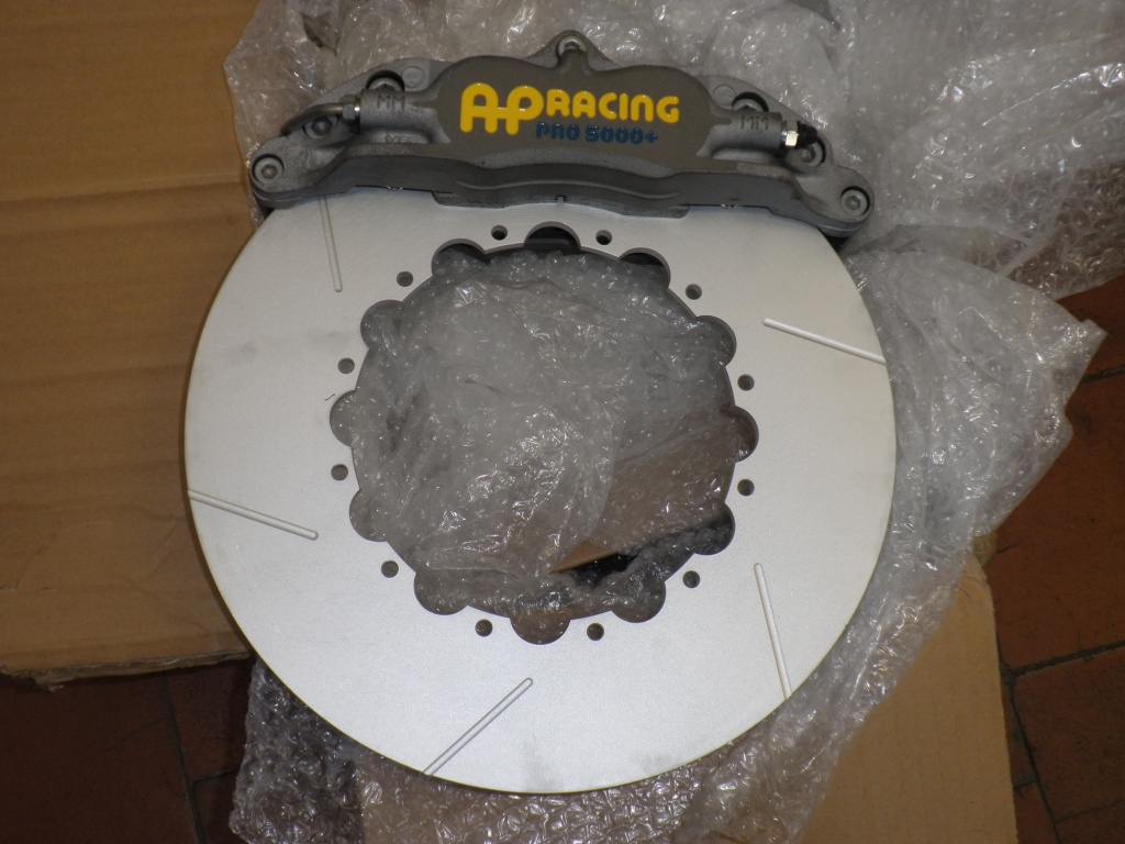

    304x28 2-piece custom brake setup, using AP Pro 5000+ 4-pot calipers and ds3000 pads (same calipers and pads as badgerwagen runs)
    Squeazing these in ther 7x15 et35 rim is proving a challenge, but we look to have just about sussed the geometry
    some pictures below
    304mm x 28mm rotor and Pro 5000+ AP 4-pot caliper

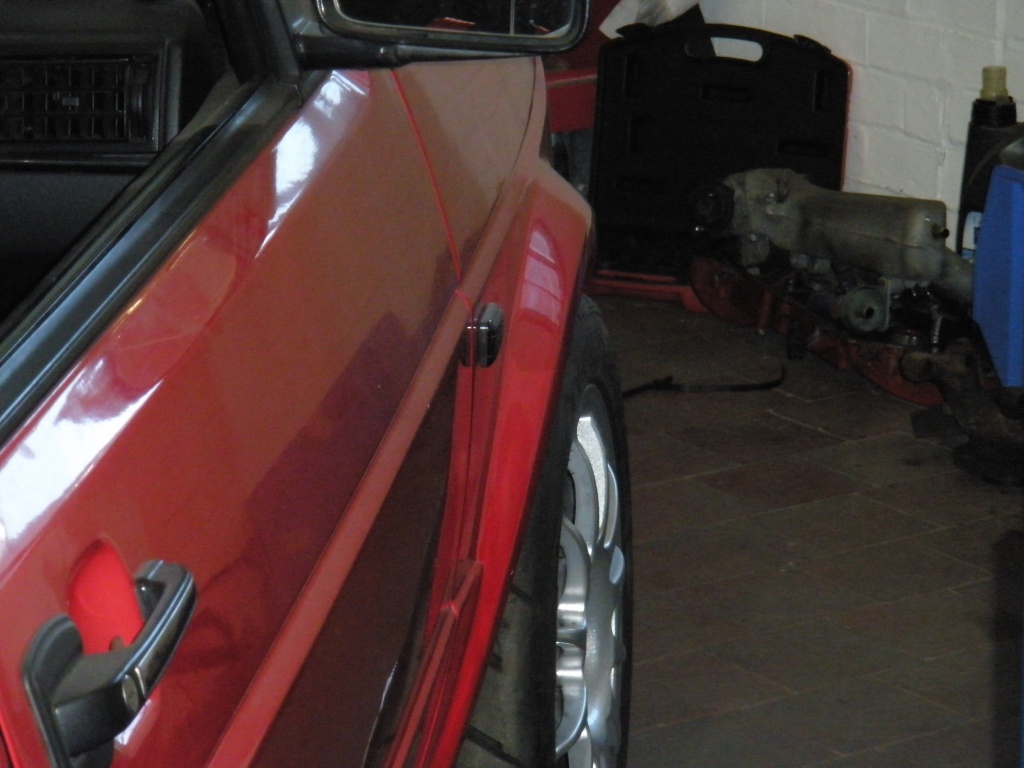

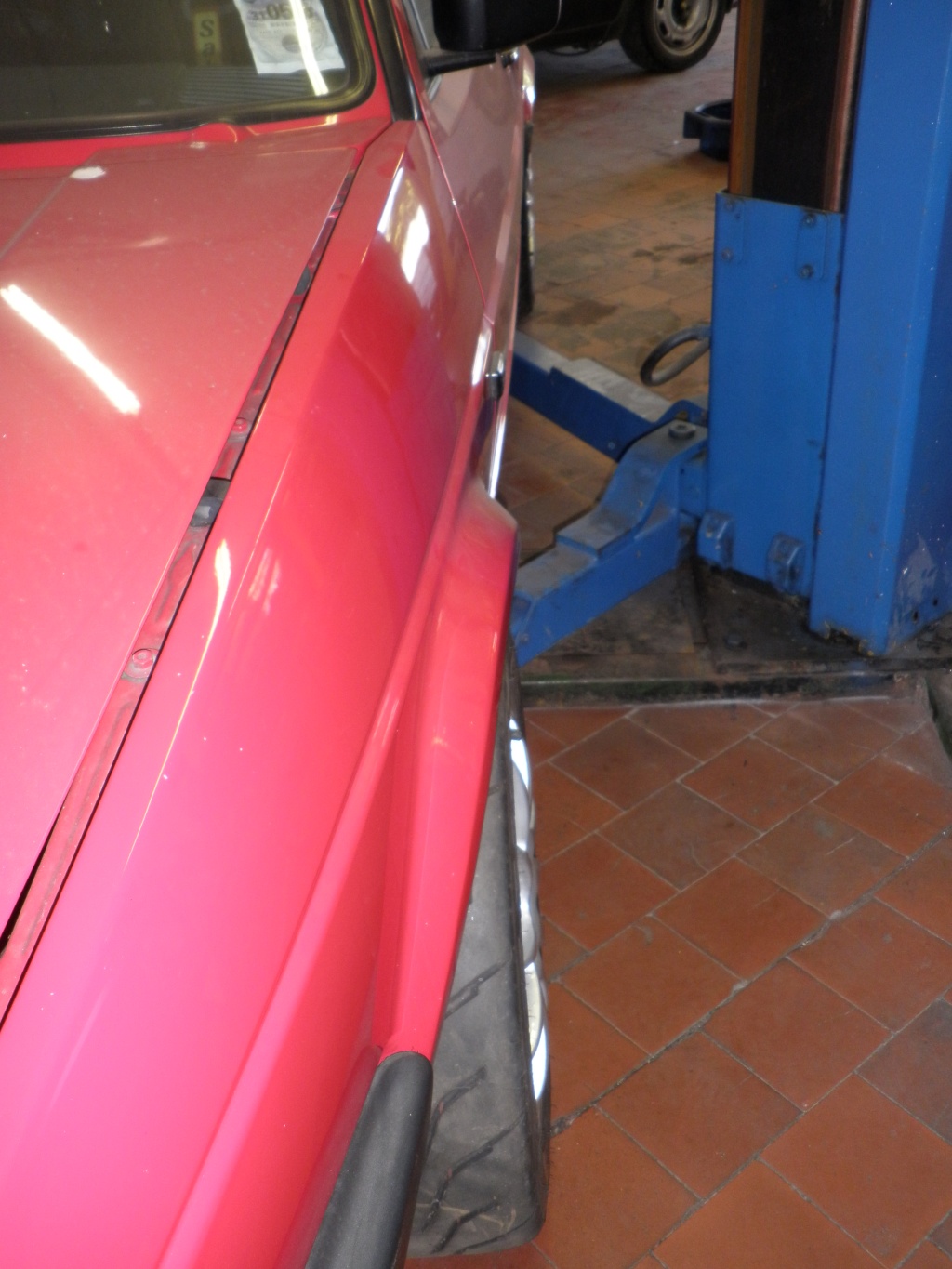

    car sat on the ground on its new widetrack, big braked setup
    and despite the wide track, with some suitable negative camber the wheels do still just about stick under the wheel arches (just)
