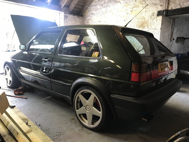

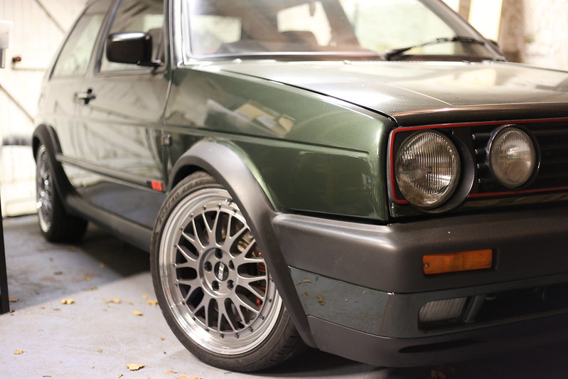

    Fitted a HEL braided clutch line. When replacing the downpipes last weekend, I leant on the copper clutch line and snapped it [​IMG].

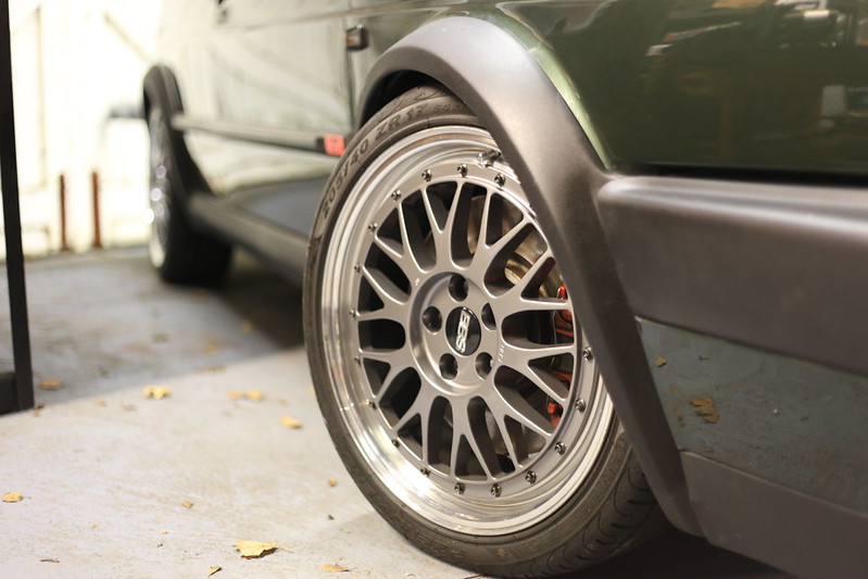

    Also picked up some 5x100 17x8 Azev A's. They need a refurb but I don't know if they suit the car as much as I thought they would. Thinking of selling them on and holding out for some 17" LMs.
    Quick test fit:

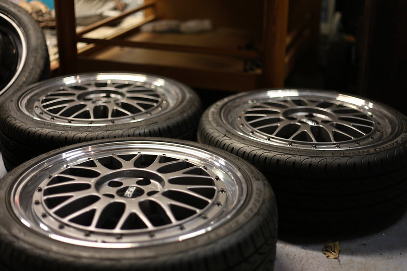

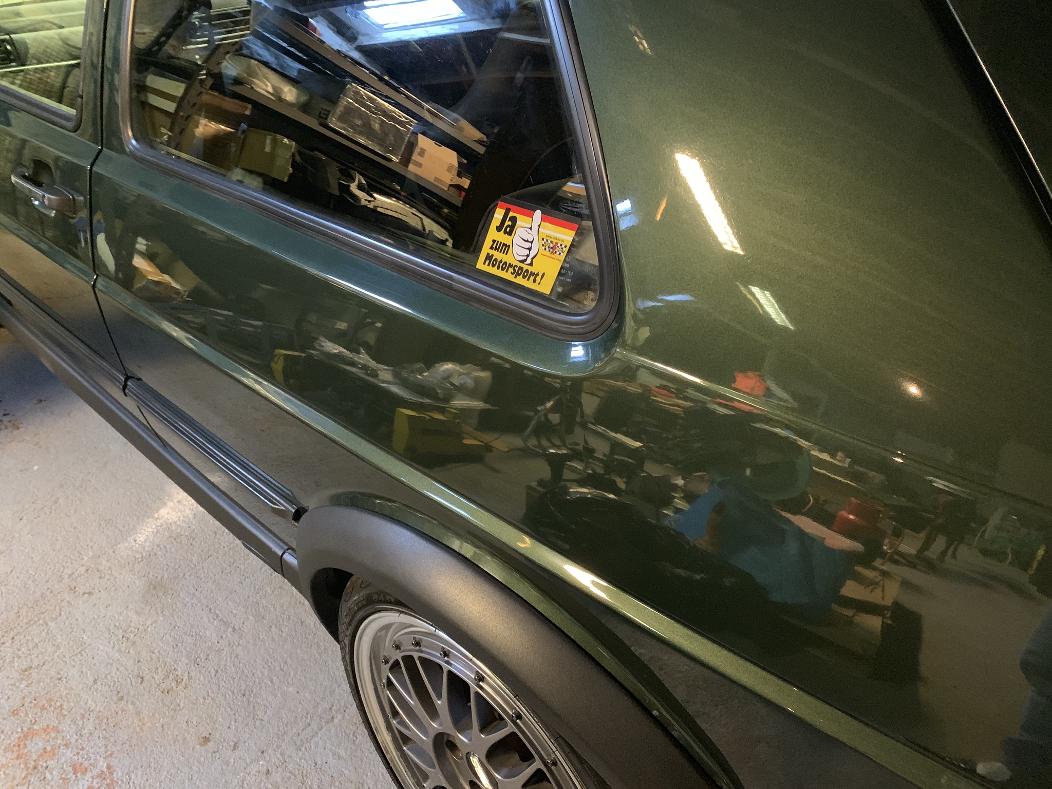

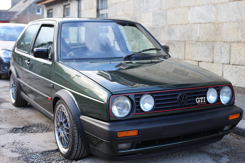

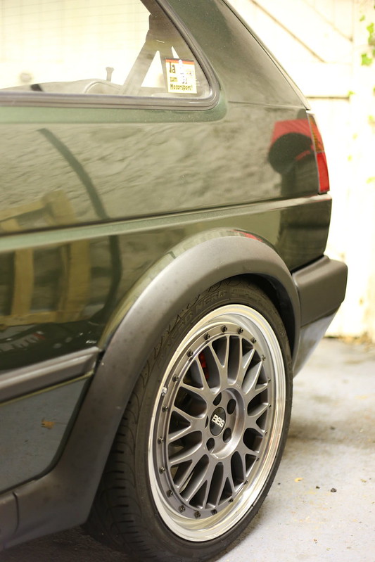

    So, I have had this over 2 years now! How time flies! It is the longest I have ever had a car.
    AmericanDan pointed out some LM's to me - they ended up being the perfect specs 17x7, et35, 5x100. I have been looking for a set like this for the past 2 years, so very chuffed to have found a set with the correct fitment.
    They have been sealed with Carbon Collective Platinum Coating and came with a new set of 205/40/17 Pirelli PZero Nero. Best of all, no kerbing etc either.

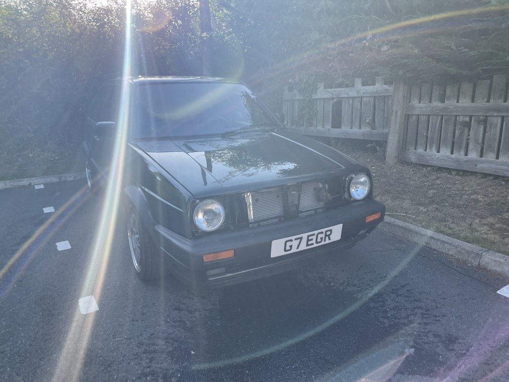

    Since it was a fine day, I thought I would take the mk2 out. First time it has turned a wheel since about October, started first time with no issues.
    Sam came round with his mk5 gti, so gave that a clean and took some photos.

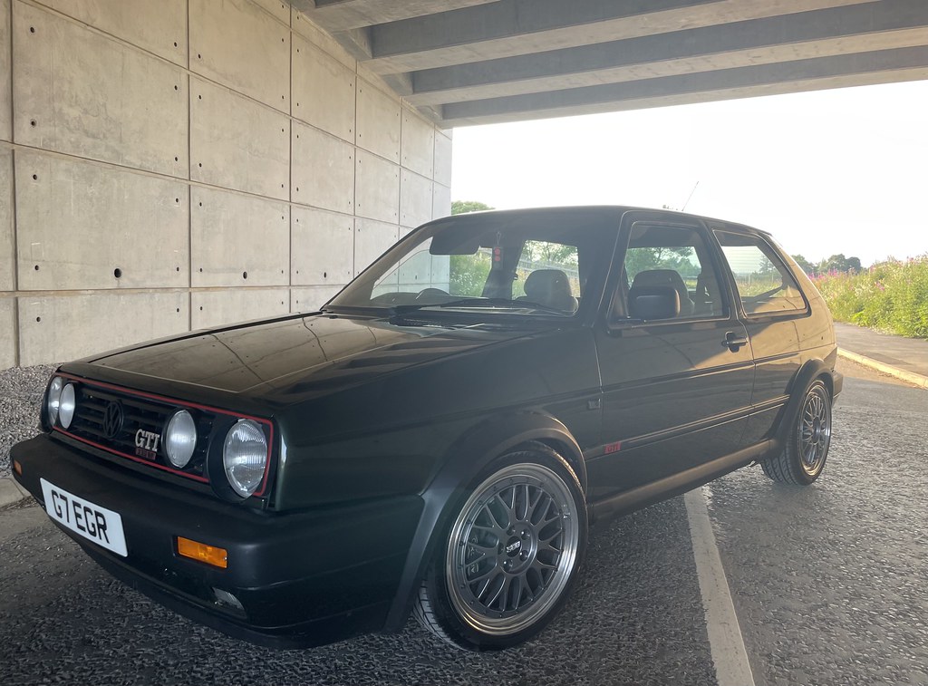

    I haven't done as much as I hope to this year on the car - work, life and anytime I have been out the road I have been assisting my Dad at fitting up a workshop.

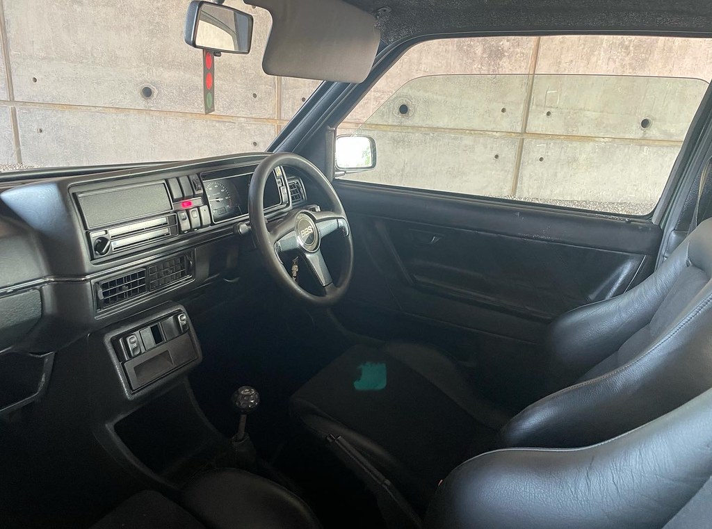

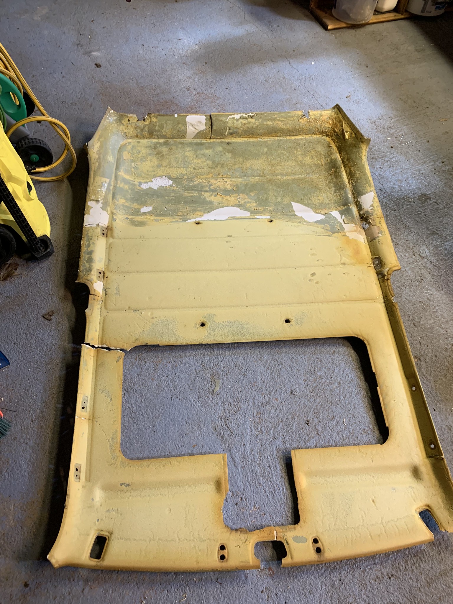

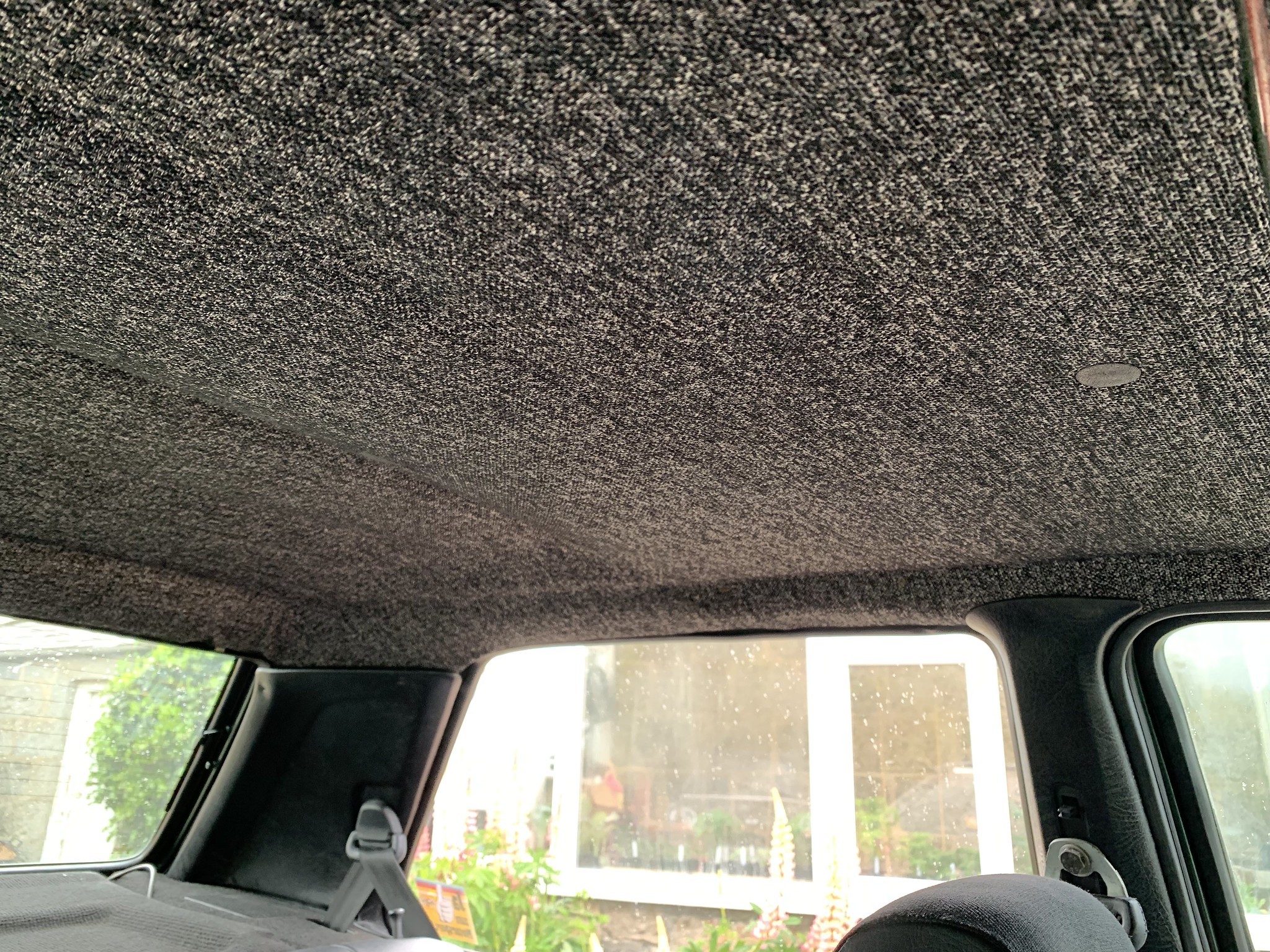

    The headlining was always letting the interior down. The rear of it had sagged, so I had cut it off. I removed all the existing material and ended up with the lovely cracked number below:
    I repaired this with some fibreglass, in about 6/7 areas and retrimmed it in a dark grey/black tweed:

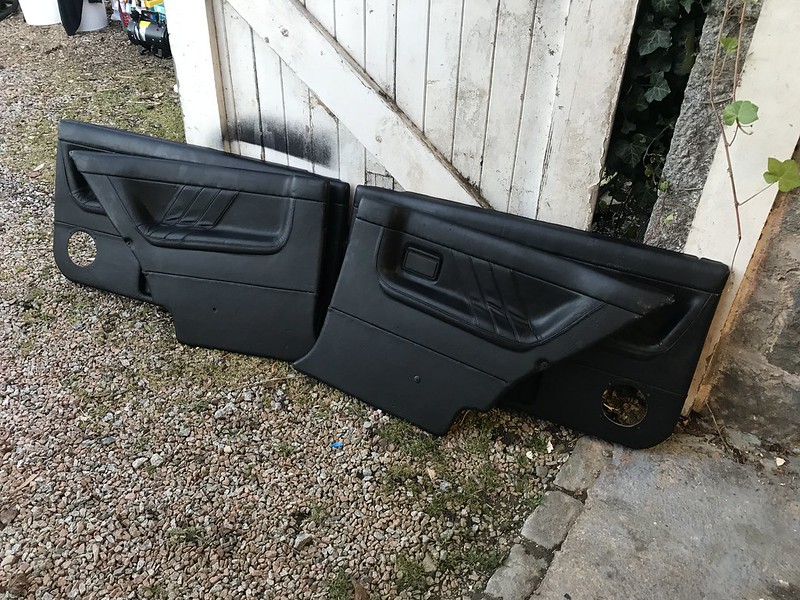

    The door cards were installed, rears are almost mint. Fronts are a bit scabby, but I plan to drop these with my friend Andrew to tidy up and redye. He is currently dying is spare M3 Kiwi Interior Cinnamon and has done a fantastic job so far:

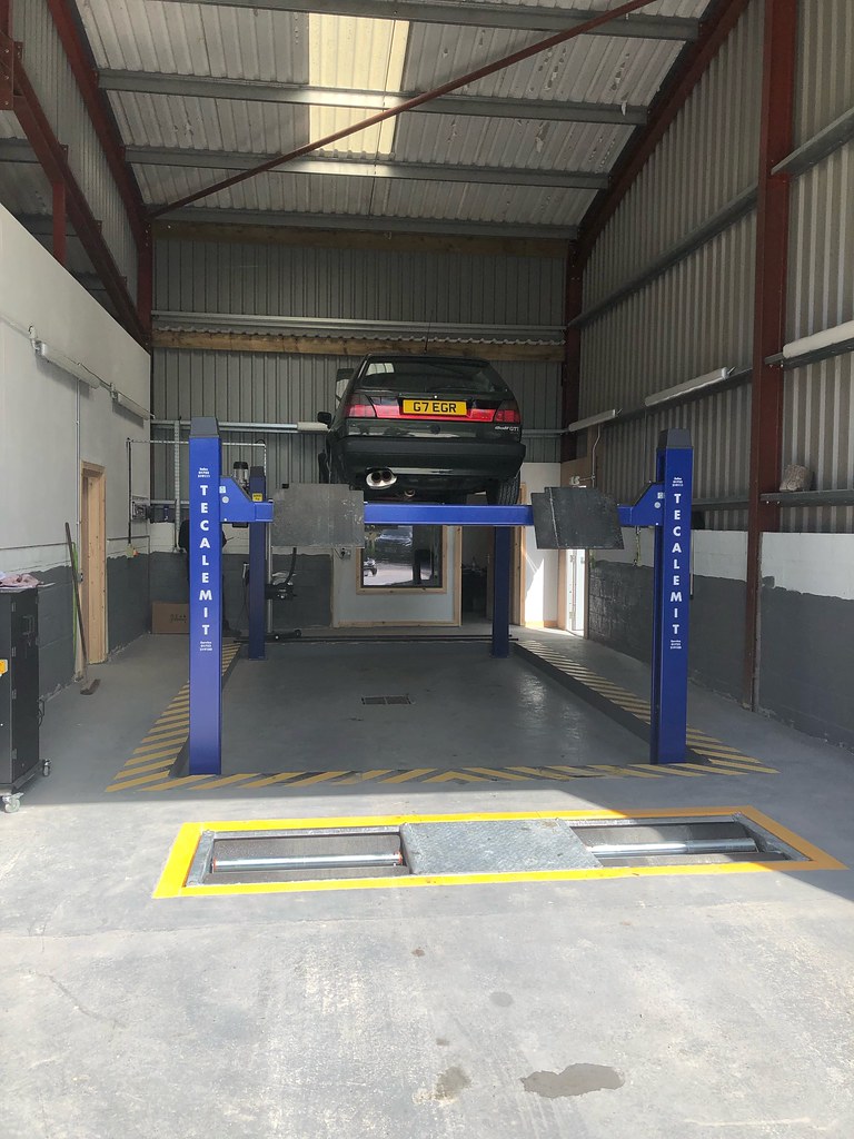

    The car also had its MOT last week, where it has completed a whole 250 miles since June last year [​IMG]. I treated it to some early style plates - I got them from 'Fancy Plates' - ordered Monday and delivered Tuesday - winner!
    I have made some changes to the suspension set up - the rear has been raised 5mm and the front dampers have been made slightly softer, which has made it an absolute treat on the road.
    At the weekend, I gave it a quick once over with the DA, as this was really needing done since last year:

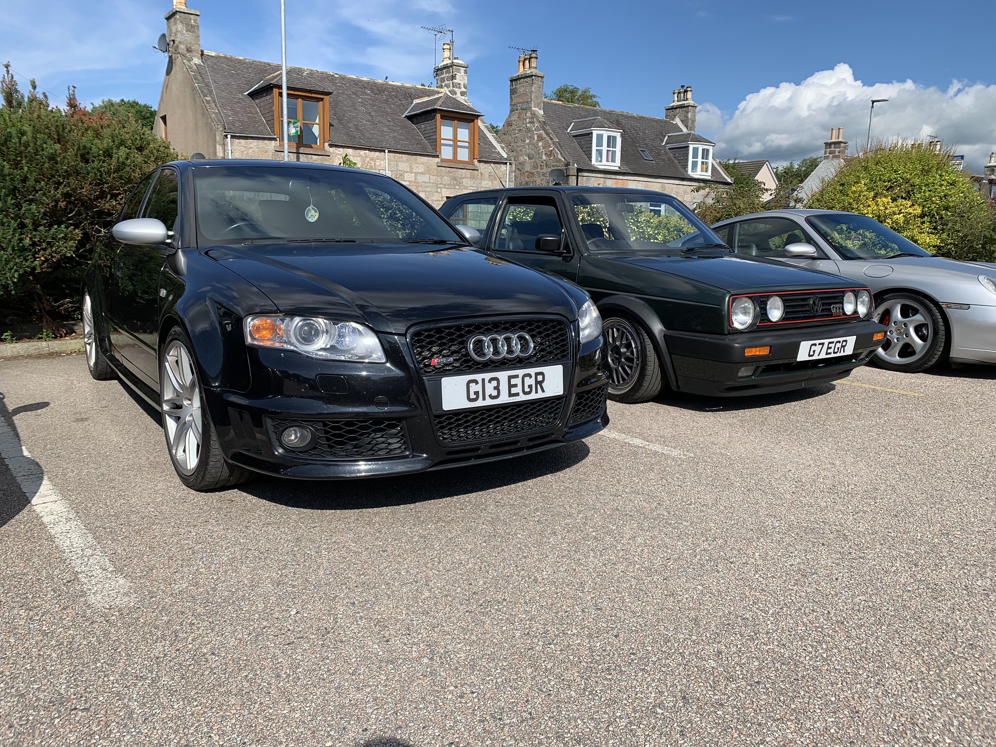

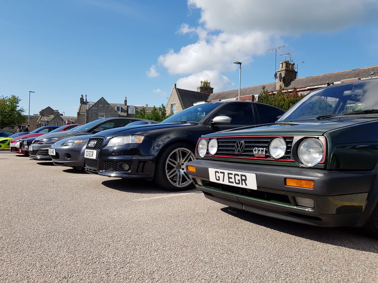

    I then took it to V8 Breakfast at Fennel for the 'Drive for June' charity event. It was the first outing I took the mk2 to last year, so I was keen to take it along. My Father's day gift to my Dad was letting him take the RS4 (I just wanted photos of them together [​IMG]):
    The day was finished up with a wee drive with Andrew, Sam, Sofa and Martin where we got photos of the Mk2, Sam's Mk5 and Martin's new Mk7 GTI TCR.
    Overall I am happy with where the mk2 is now at, and it is probably where it should have been this time last year. It has definitely been a learning curve!

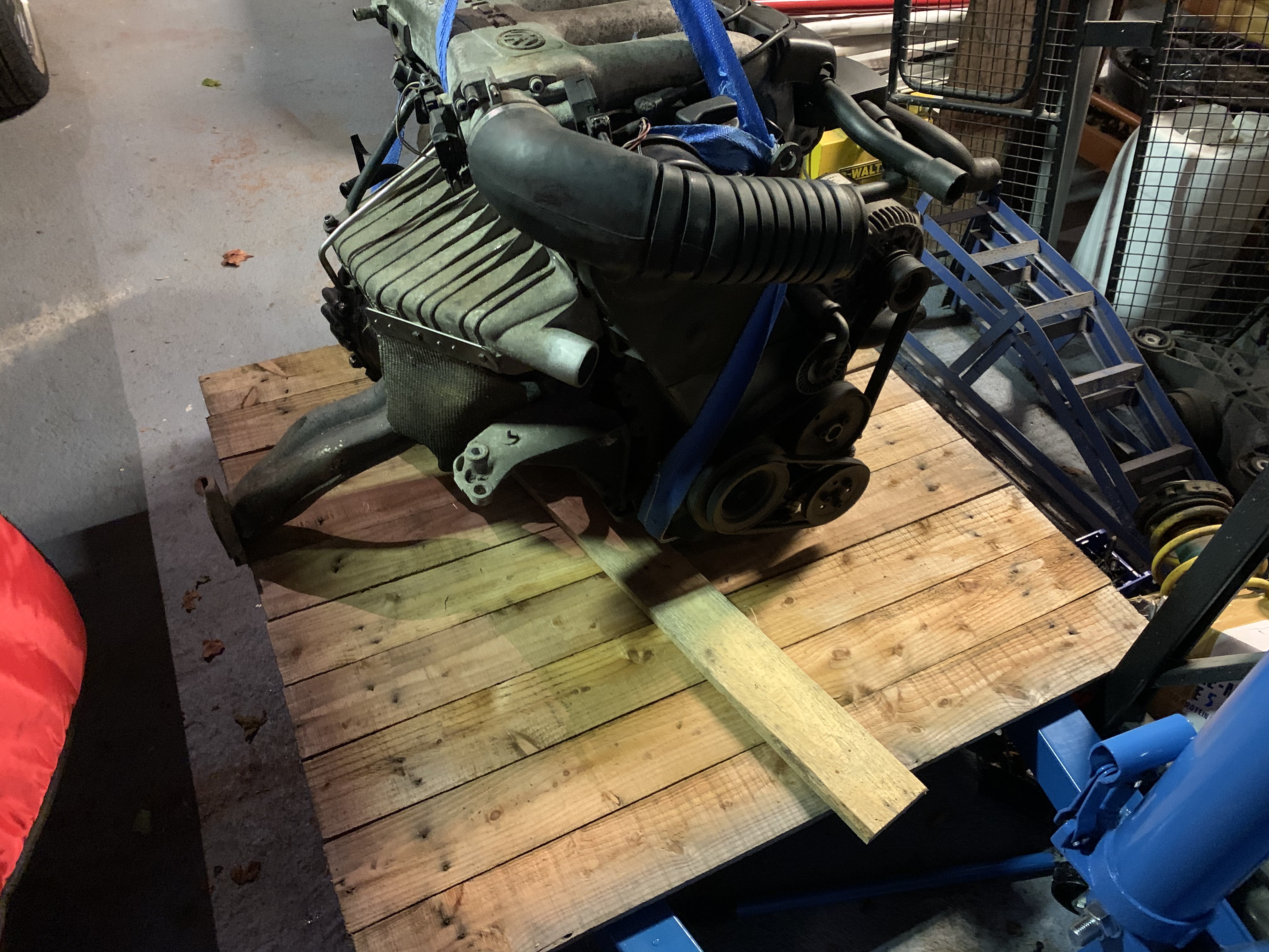

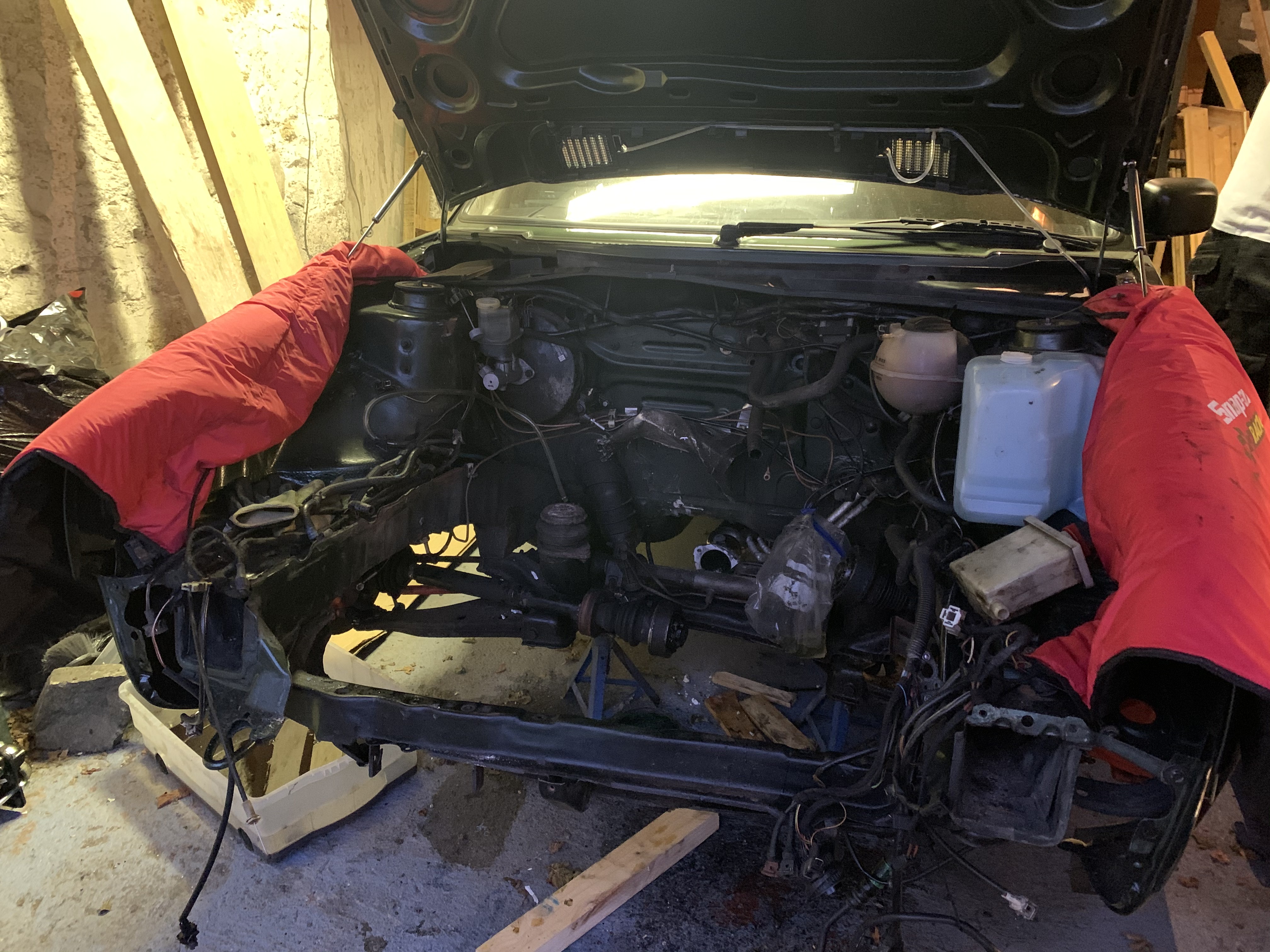

    So this is more of an unexpected update, as come June time, I was planning on using this heaps! The car passed its MOT in the June time and I realised I had done about 250 miles in it between MOTs. This year, I planned to use it on all the good days, so started using it going back and forth to work in July which was awesome [​IMG]. Then it was meant to rain for a good week or so and I decided to drop it back off to my parents and cycle back in (cause I am trying to road cycle this year too). On the way home however, the coolant light came on - odd I thought. I always keep coolant in the car, so pulled in and open the bonnet, to find water everywhere [​IMG]. The radiator (a new one I bought last year too) had sh*t itself. I managed to coax it back to the garage.
    The plan then was to replace the radiator with a new large aluminium one, with slimline fans. I thought, while the car was apart, I would also purchase a TSR/Milltek manifold, as I always thought there was a slight blow on the downpipe. And since I would have to remove engine mounts etc to get to the downpipe, I thought I would replace the gearbox with a 3.94 FD - so I purchased a mk4 golf 2.0 GTI 5 speed box with an EMR code [​IMG]. This should mount up fine, and as I have the mk4 shifter in the mk2 already should be an easy swap with potentially just the drive shaft cups needing swapped between the boxes.
    However, not everything went to plan removing the gearbox, with about 2 solid days attempting, with double checks from Andrew and my mechanic friend Peter (for all the work I can't be arsed/am not skilled enough to do). I was doing everything correctly, but we think I might have a twisted input shaft which is causing the problem - so out with the engine [​IMG]. This put me in a huff and I didn't touch the car for a couple of months until this weekend:
    The silver lining to this, is that the engine bay has always let down the car. The car was never meant to go to the level or expense (paint, retrimmed interior and LM's) that it has, and I pretty much left the bay as it was. The plan over the next few months is now to respray the bay, paint the engine, get Andrew to powder coat a heap of stuff and make it all pretty, including the earlier improvements noted above.

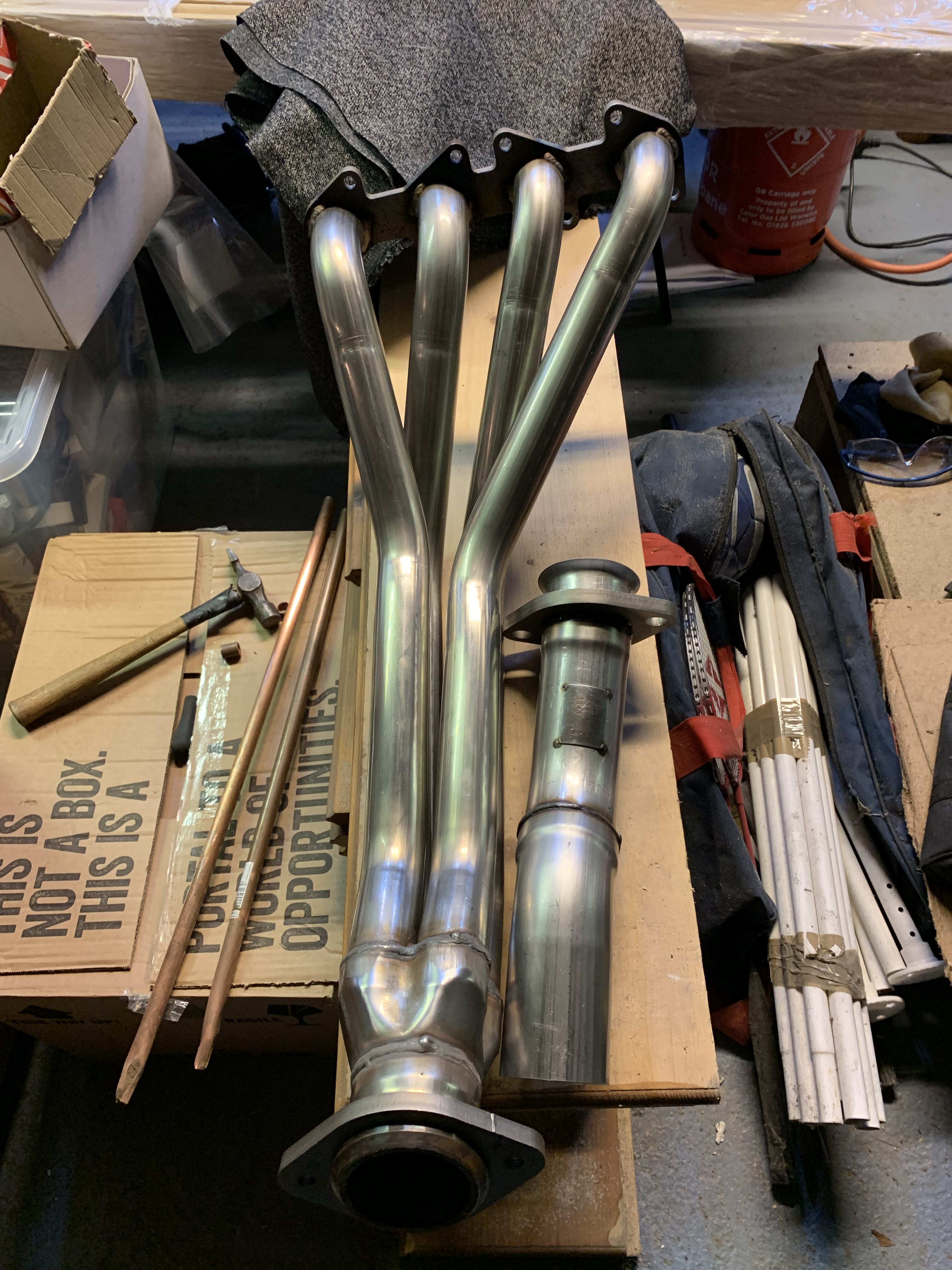

    Sorry for the long winded post - have a picture of my exhaust manifold for good measure [​IMG]

    So, an almost non-existent update, but I am bored [​IMG]. This should be a lot further ahead, but I spent too much time mucking about with a red Mk5 GTI and the Lupo, that this is a little behind. With the current lockdown in place, and the car being out the road at my parents, I am unsure if the car will be on the road for this summer, or even this year - I'll just have to wait and see.
    • The engine is still out the car, but I have taken off the gearbox and exhaust manifold. The block has been degreased and painted black.
    • Engine bay is being prepped to be painted.
    • I bought a lightened flywheel
    • I have a new clutch kit from ECP for the car - on the day I went to collect this, there was an error on their system and I got it for £28!
    • I have a new Schrick 268 Inlet cam to go on - according to Ess Three's thread on club GTI - this was the most effective cam for the car. Allegedly the exhaust cam is not required.
    • All the metal work is with my friend Andrew for blasting and coating

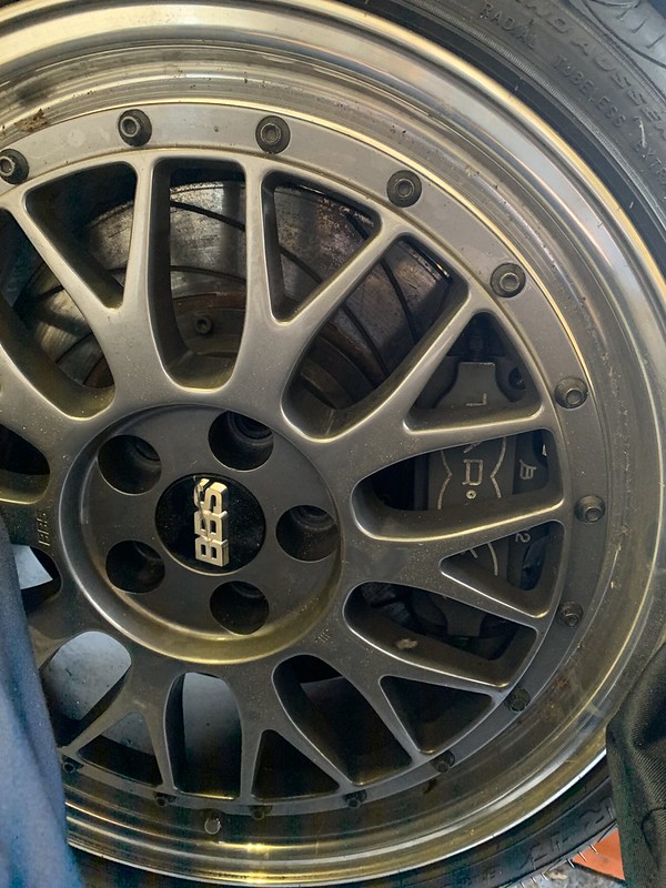

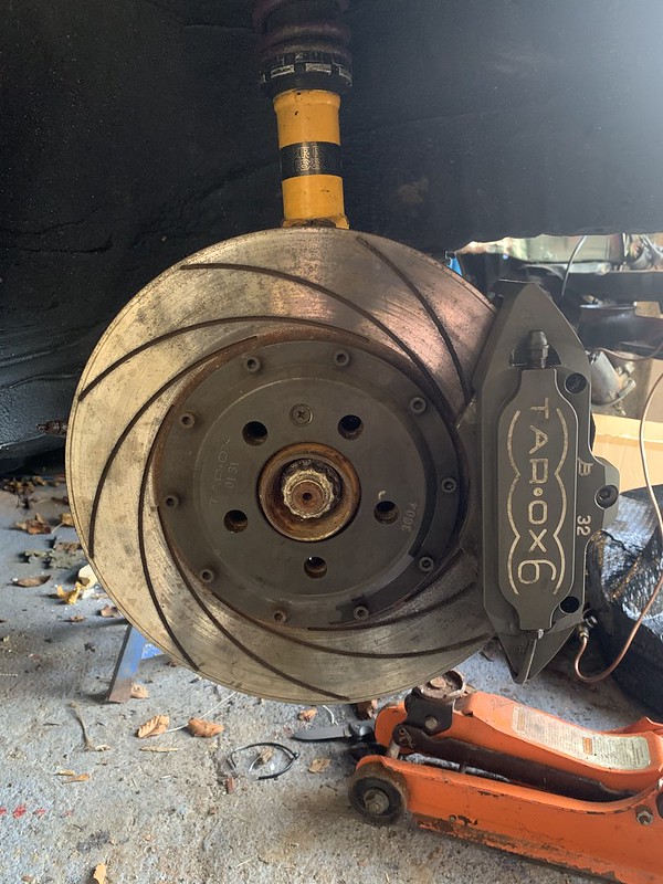

    • I got Tarox 6 pot brakes from a local Mk3 that was being broken - completely unnecessary, but for the money I couldnt say no.
    • I have also bought Happich replica rear windows for the car.

    • New ICV - the chinese one fitted the year previous failed.

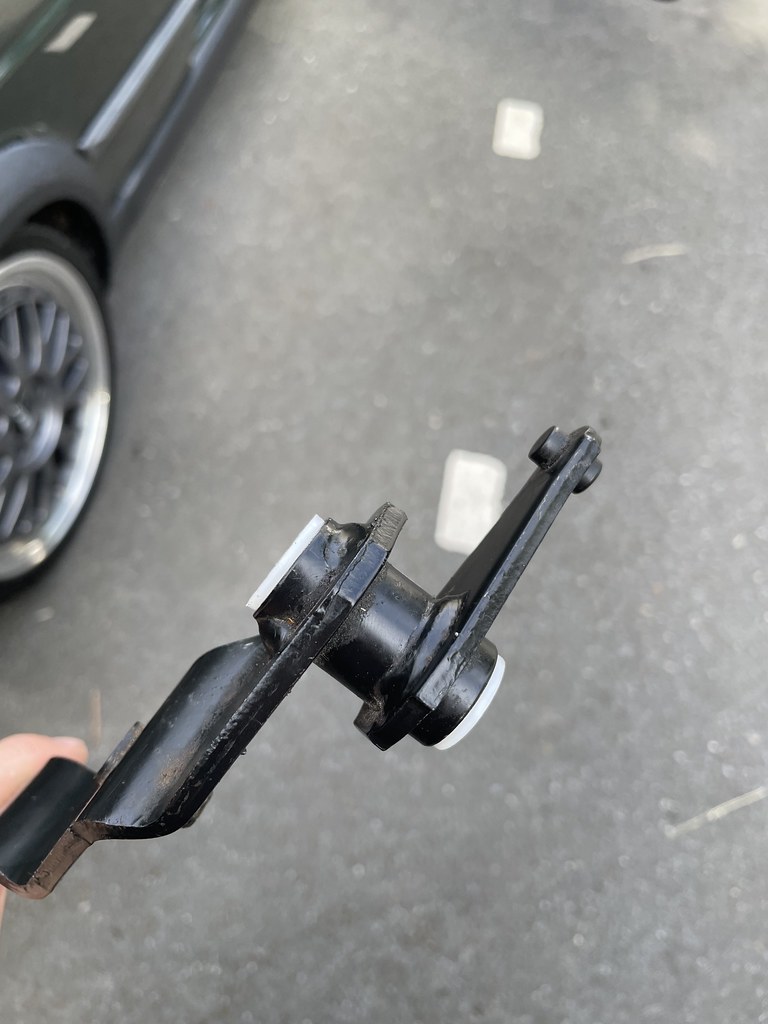

    • New brake balancer spring - managed to modify a new Mk1 version from crazy quifes.
    • Bled the brakes after fitting the Tarox
    • Welded in brackets for the new radiator
    • Wired in the new dual fan set up.

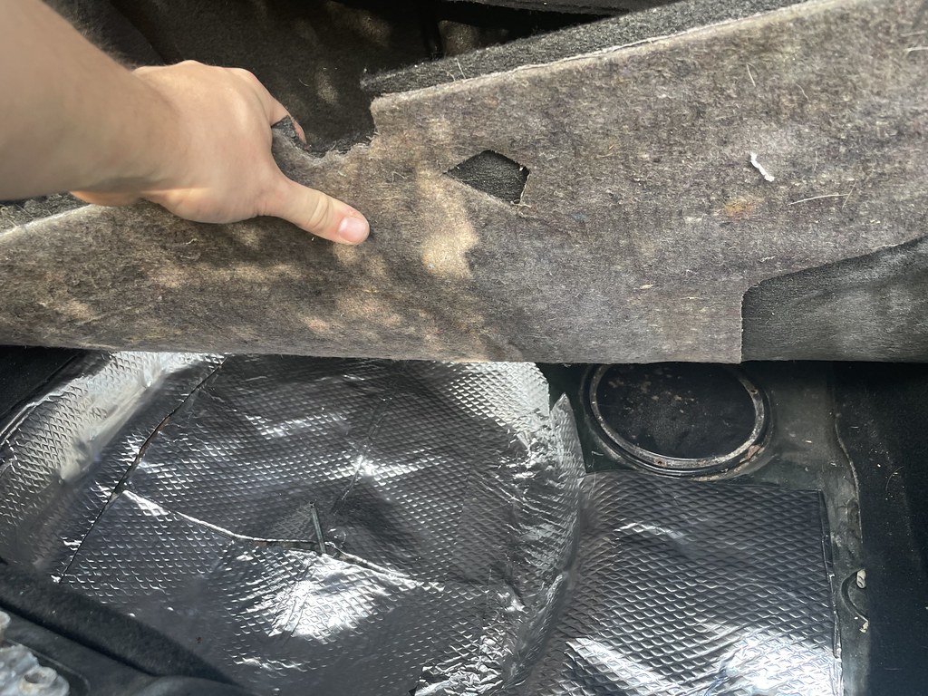

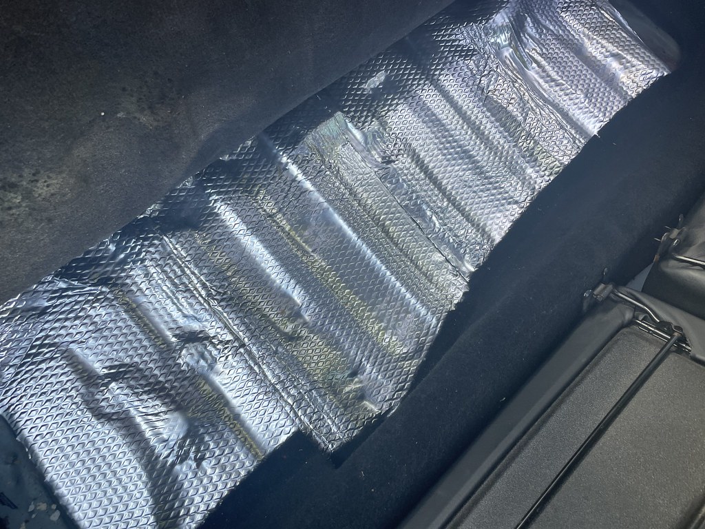

    After sitting for almost 2 years and being in sheds and all sorts, the car was looking a little sorry for itself. As such, I got to work giving it a good deep clean. A polish will occur in the near future.
    With the new downpipe fitted with the trackslag exhaust, I have realised the car is now very loud - perhaps I am just getting old. Great on a run, but around town and to work, a bit bouley basher. To counteract this (for me at least). I have added some sound deadening to:
    • Under the rear seats
    • Boot area
    • Into the doors
    This has created a marked difference to the inside of the car.

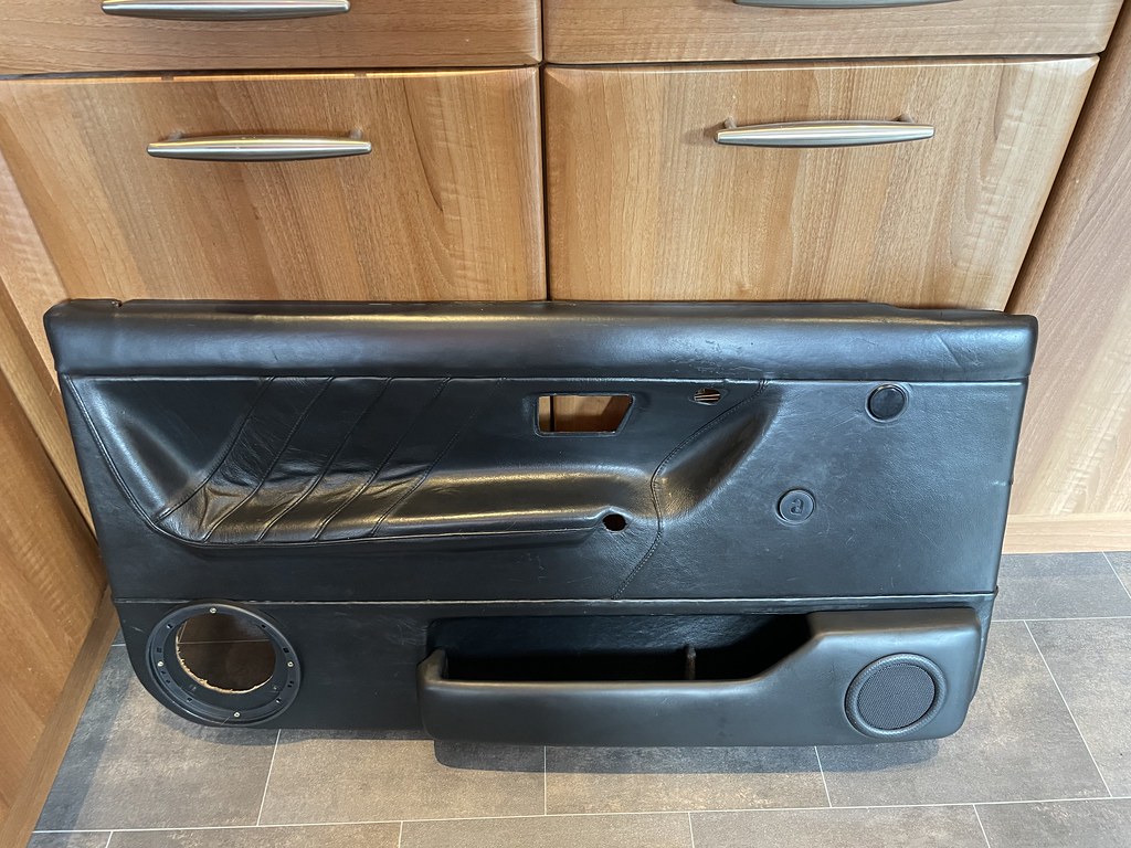

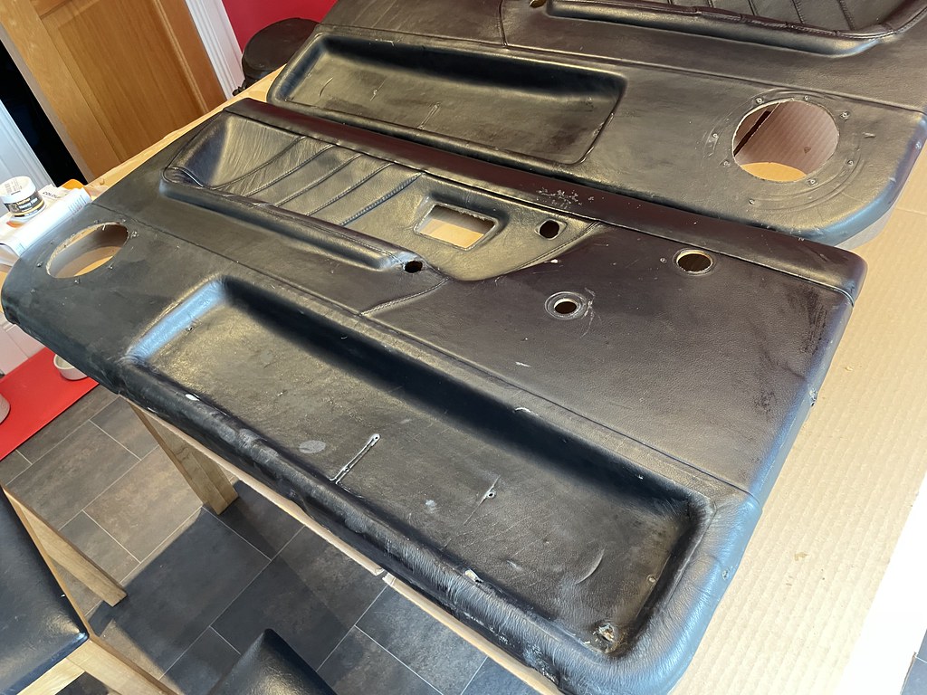

    And finally, one of the things I carried out last week, was tidying up the door cards. As you will be aware, leather doors cards for a mk2 are quite a premium now, and to obtain some, I ended up buying a set in poorer condition than I would have liked. These looked as if they had been scratched by a dog, and had additional speaker holes cut on the inside.
    [​IMG][​IMG][​IMG]
    After a few nights of sanding, filing and redying, I got an improvement, to this:

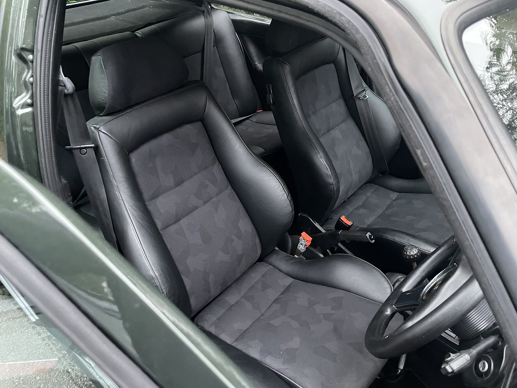

    • Mk3 recaros and rear bench - retrimmed in half leather and recaro fabric

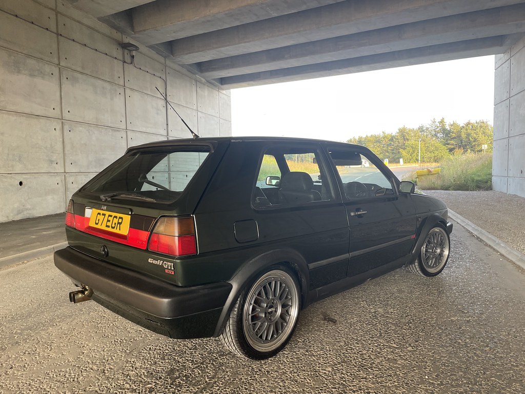

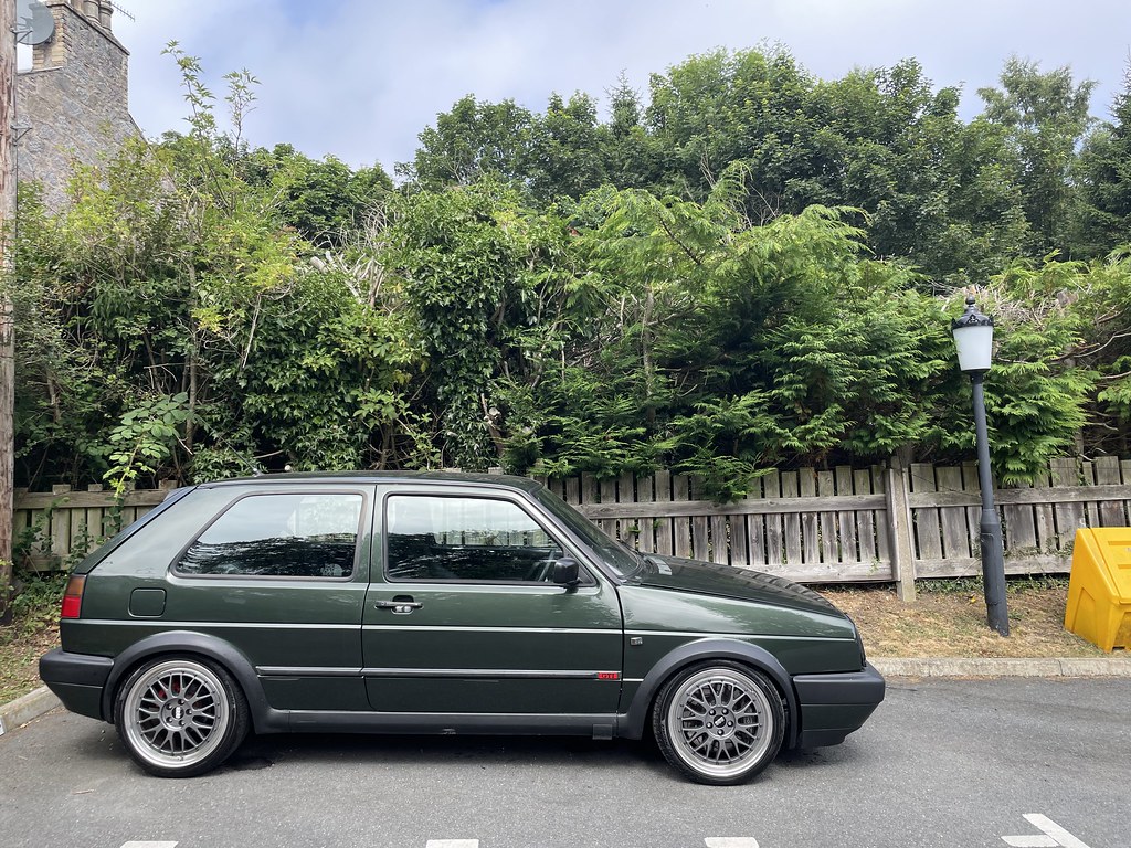

    I have taken some rather terrible photos after cleaning it up, however I should have some better photos appearing in the next week or so from my pal Sean.

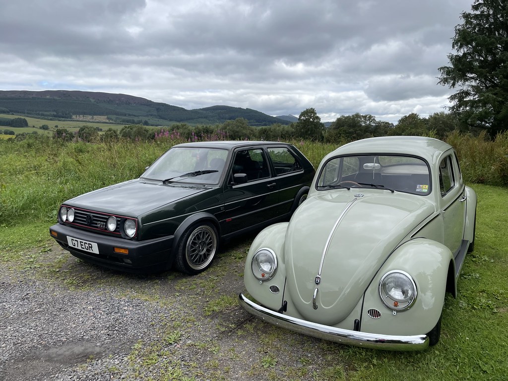

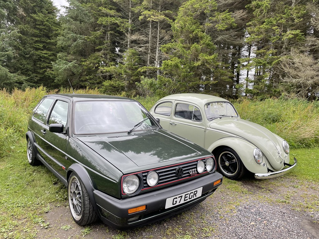

    And a couple with the beetle I restored this past year/my Up GTI daily:
