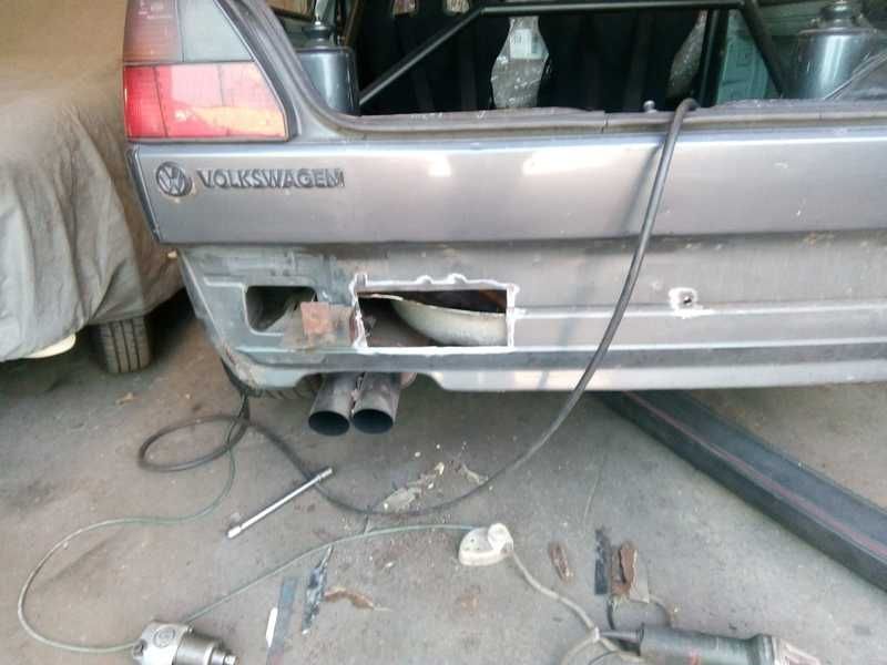

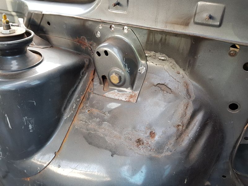

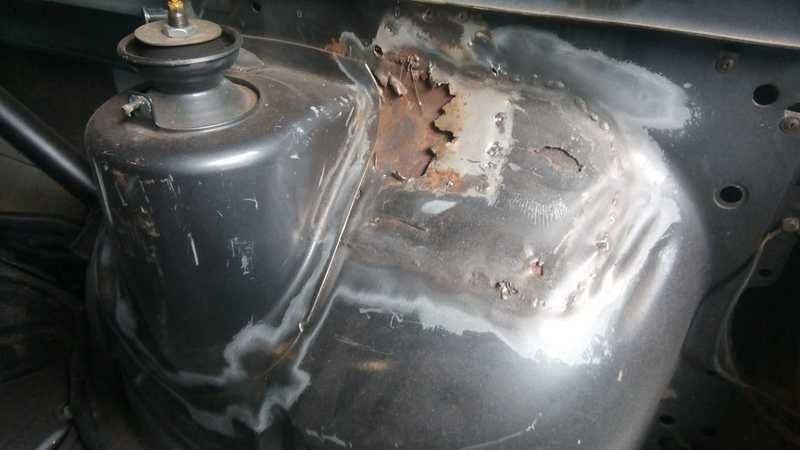

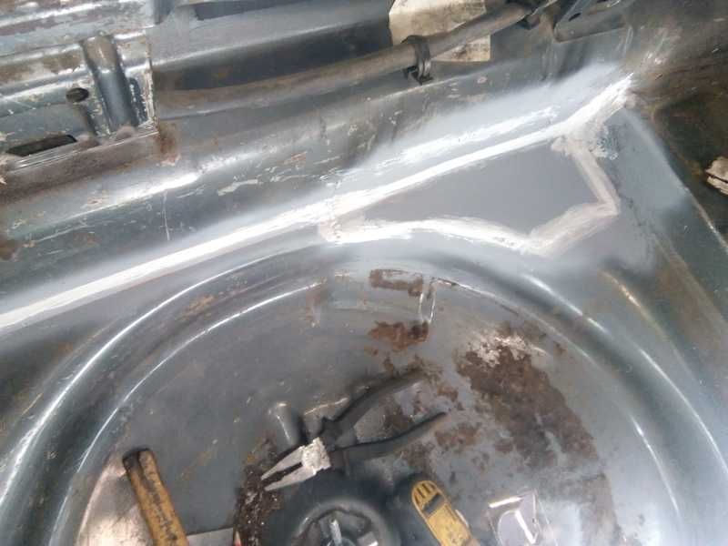

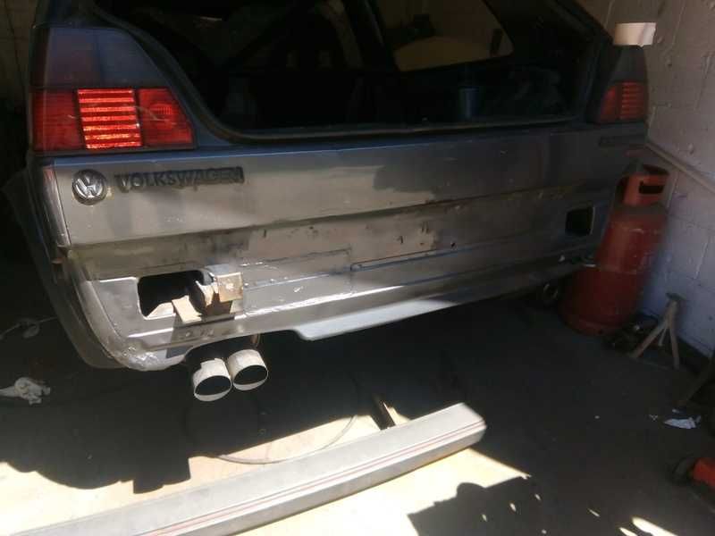

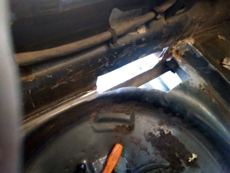

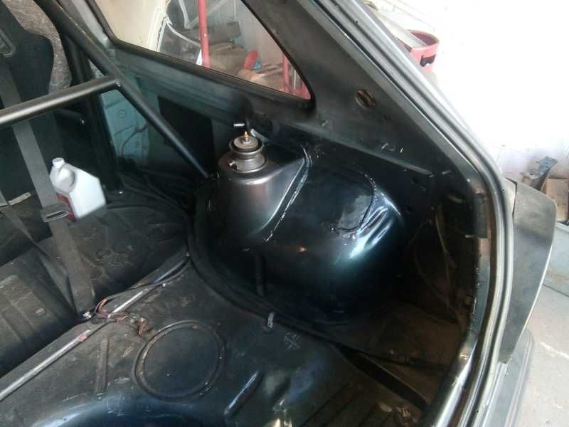

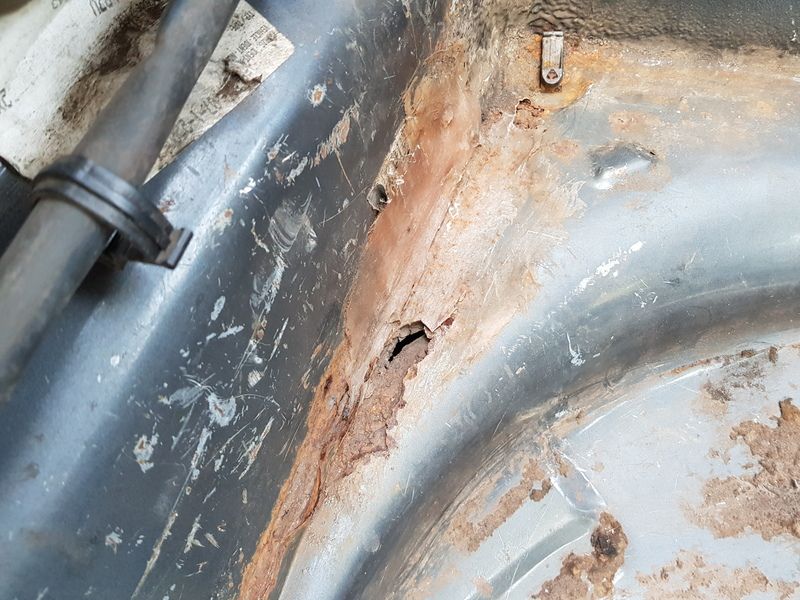

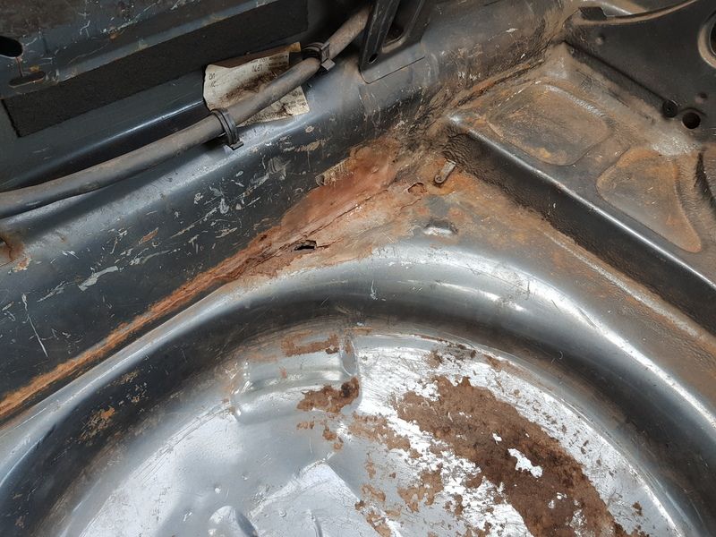

    The car was very *ahem* crusty in places. The worst bits were the rear panel where it meets the boot floor and the rear strut tops.
    The sills were looking a bit worse for wear too. One of the previous owners had filled these holes with fibreglass filler so I decided to have it done properly.
    As this is going to be on track a fair bit I wanted to make sure it was as rigid as it could be (roll cage helps but I wanted to be sure).
    I sent the Golf to Jon at Broad Arrow Classic Cars in Stourbridge. He had the car for a week and has cut all of the structural rot out and replaced it with good metal. He also stitch welded around my rear struts. Not sure if there's any benefit but I've seen it done on some race builds.
    There's a load more pics but I won't bore you. The end result is a nice solid starting point that I can chuck around a circuit without worrying about what the chassis is doing too much.

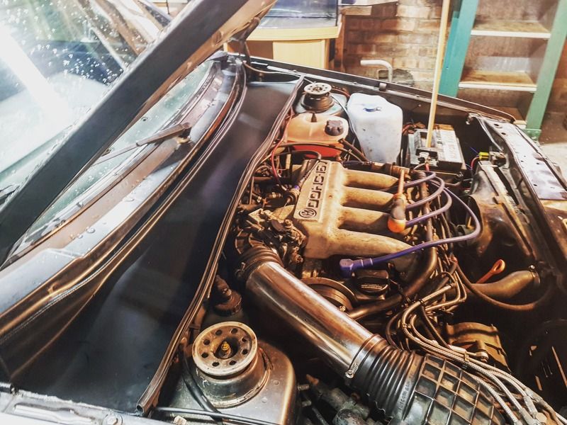

    The MOT ran out on the Golf in August and it was far from road legal as it was.
    I've had to fit the original bonnet for the windscreen washer system and I've retrofitted a washer bottle system.
    Fitting the original bonnet meant fitting a new bonnet release catch and cable. I didn't get pics of this as it's fairly boring stuff.
    I've gone round the car with a typical MOT inspection in mind and I'm not far off now. I have a split CV boot that will need some attention and I've got a few more lights and warning lamps to fix but it's almost there.
    In other news I've installed my SWG Motorsport scuttle cover.
    I love how these look and it also keeps my feet dry as I don't have any of the heater system etc.

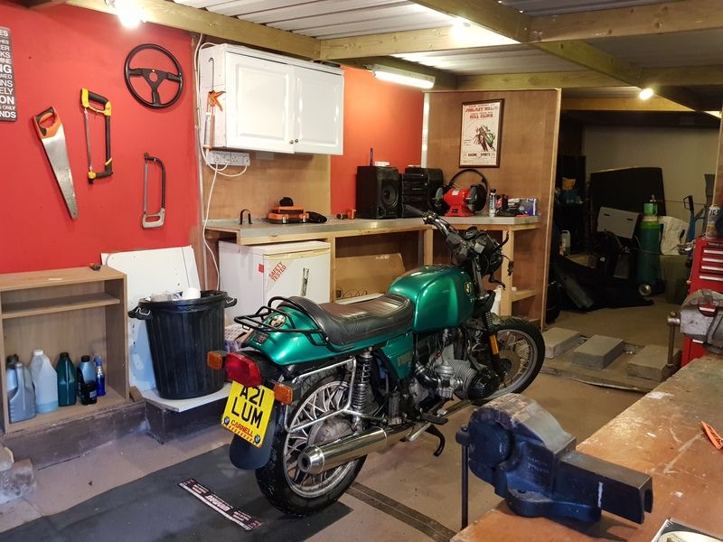

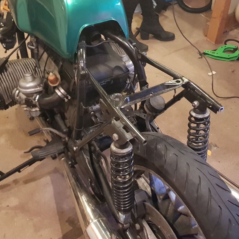

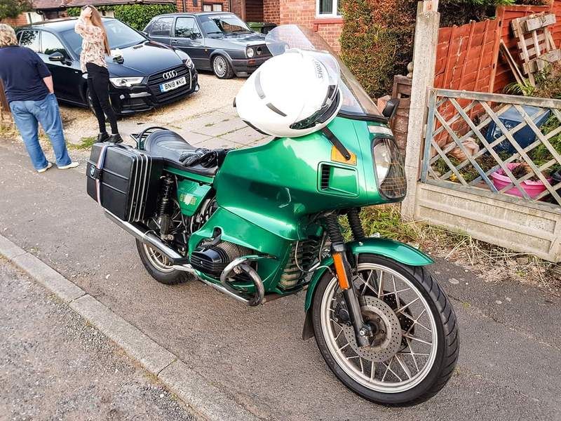

    Progress is going to slow somewhat as this isn't my only project. I have a BMW R100RT that I'm chopping up into a café racer.
    Apologies if you're a purist but I've always wanted to do a boxer twin and this came up at the right price.

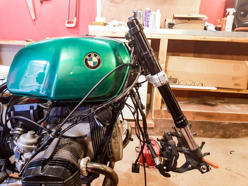

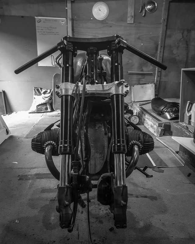

    I've carried out a fork conversion from a 2008 GSXR 750 which gives me better road handling and far superior brakes.
    Sorry if you're not into bikes, thought it might be cool for some.

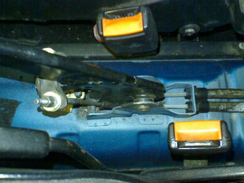

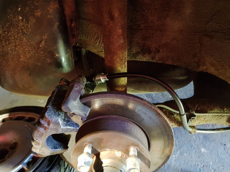

    First job was to make a start on the mk4 rear caliper swap, now before you slate me for mounting them upside down - I'm told by the best in the business that this is correct when installing them on an early Mk2 like mine. I'm just waiting for my conversion hoses off Goodridge before we can complete the install. The subframe and arches are due for a tidy up too.

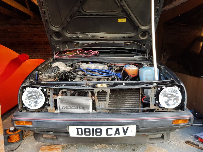

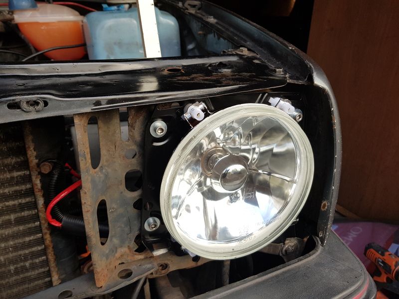

    The headlights were knackered so I've replaced them with a set of crystal units. I couldn't leave the old rusty bolts in so I've replaced them with stainless M6 cap head screws (this should be a common theme throughout the car). Together with the uprated headlight loom and the superbright OSRAM bulbs I should have decent visibility at night. While i was there I also mounted the oil cooler slightly lower down on some new brackets. Eventually I'll paint the areas showing surface rust so there's not as much of a contrast between new and old.
    Next weekend we'll finish off the handbrake cables and bleed the brakes. The coilovers (FK Konigsport) have been removed so I'll attack them with a wire brush and give them a service.

  16. Jon Olds Forum Junkie
    Just finished my mk2 rally build and the 'upside down' caliper bit makes some sense to me now.
    I mounted mine the right way up but had to modify the handbrake system to get the cable lengths anywhere near correct
    Jon

    Jon, did you end up cutting the guide tubes down to make them work/?
    I haven't hooked the cables up to the lever yet so this may not work but we'll see.
    Sirguydo - I've had a KR in the past and if this wasn't already fitted with the ABF I'd be happy with the KR, really superb engines. I imagine I'm around the 950kg region but I'm keen to get it on a weighbridge. I'll put that on my job list [:D]
  18. rubjonny
    you'll soon see if you need to or not, on my mk1 cab with mk3 rear brakes fitted the right way up the scirocco 16v cables just wouldn't reach the handbrake lever at all. 10mm off the guide tubes and all sorted.
    but mk1 guys have used early mk2 cables and found they fitted straight on no bother so who knows...

    I'll report back after Saturday, I reckon I'll have enough cable to mount them the right way up but if not it's no problem flipping them over.

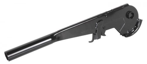

    I do have a slight problem with the handbrake lever and the bracket that the cables pass through. Because the car was fully stripped out when I bought it and I've not owned a Mk2 for some years, I can't remember for the life of me how the bracket is fixed to the lever. I can see that someone's tried to weld it in the past but if someone could show a pic of an early Mk2 handbrake cable setup showing the bracket and how it attaches to the lever that'd be ideal.
