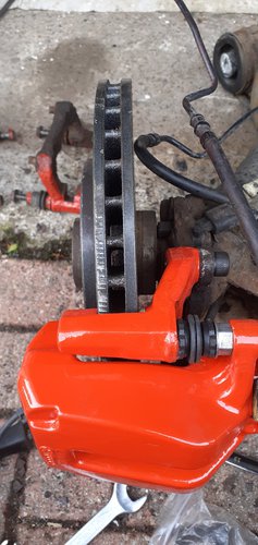

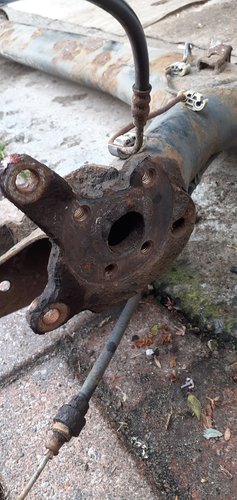

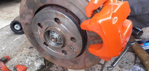

    Polo 9n3 hub and stub axle, seperate discs not all in one like mk1-3. needs a plate to mount carrier between stub and beam, think epytec or darkside do them, or use polo beam as pattern and make some, lupo gti used this style set up.
    That's mock up for ours, ibiza cupra R rear set up 256mm vented, not sure on minimum wheel size.
