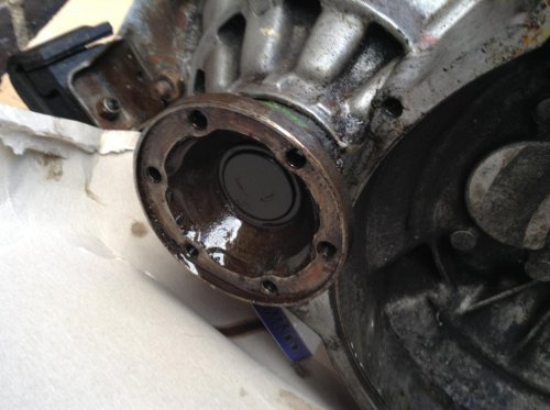

    Removed engine today ready for the e.v 1800.
    But I got an oily surprise when I took the driveshafts off the inner couplings.a mass of gearbox oil leaked from both
    I have noticed previously they looked oily but this was a fair bit.
    I've looked already online for possible causes but want someone that knows this problem or who knows what it's likely to
    Be.all I've seen is advice on changing the centre bit(cap)I also had no gaskets between shafts and couplings.:o

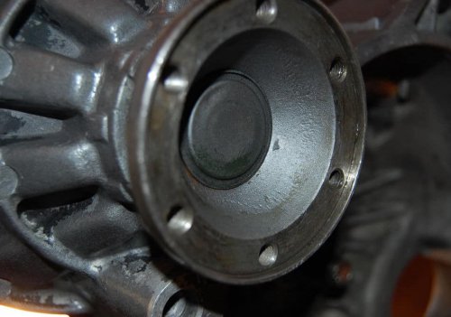

    I haven't had the inners off mine for a long time, but I had the same issue. The nearside flange seal cap was loose when I removed it last time to do the CV joints.
    flange seal 020409289B.jpg Photo credit Style
    Since it's not dry I'm not sure it cured it, but I think the outer seals leak too.

    wrong length driveshafts can rub through the inner cap let gearbox oil into the cv.
    Jon

    Don't think the drive shafts are wrong had a look and the caps are there but not oil tight.dont know why just age I
    Suppose. image.jpg where can I get these caps.
    Engine out now was fairly easy as bolts were all undone only 2 years ago. image.jpg :thumbup:

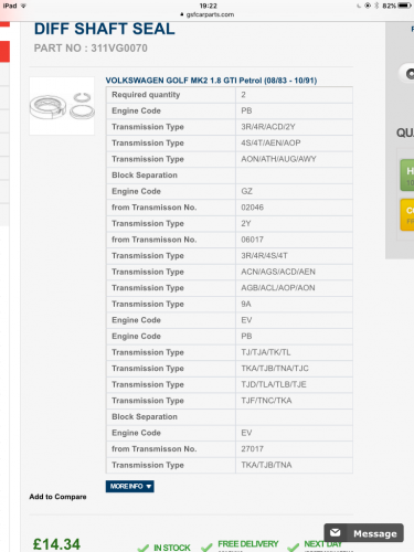

    020409289B is the part number gsf are selling them on ebay not cheap, but their number 311VG020000001 doesn't work on the site. They don't have an option to buy it for the car it's listed for (Audi 80) and for your car they only list a complete flange seal kit inner, outer + clip. GSF60 is on till Tuesday.
    https://www.gsfcarparts.com/311vg0070
    If it helps put your mind at rest I've never seen or fitted the seal between the diff cup and shaft on any MK1/2 I've worked on, never had an issue. I know they exist and other people have seen them, I guess all the cars I've worked on have had someone in there before me :lol:

    Yep got them ordered with the gsf 60 code.so that should sort that one out. image.png

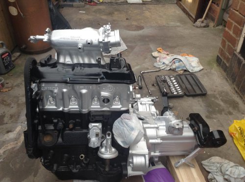

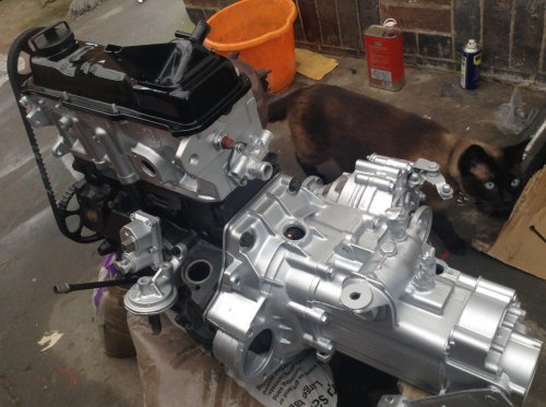

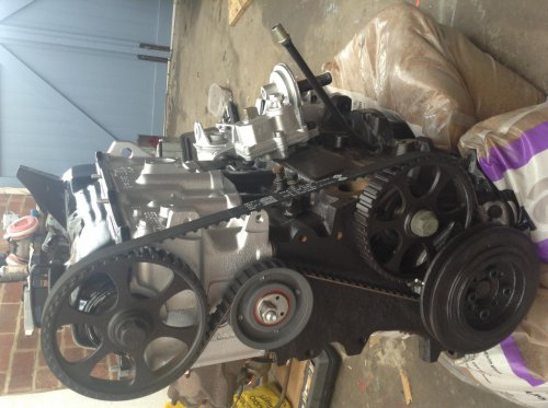

    image.jpg Some more pics of my rebuild.been painting everything before it goes back on.de-greasing gearbox was not the nicest
    Job to do but it's been throughly cleaned etch primed and vht alloy same as all the other stuff.
    I'm quite pleased with the fresh look.:thumbup:

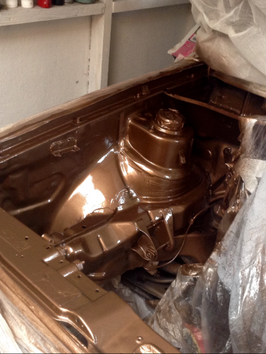

    Engine bay repainted. My mate owns a body shop but couldn't paint it as It was a hassle to get it there.but he leant me an air mask set up.(this stuff is nasty)did it before but was never really happy with it.now it's a lot better using 2k primer
    S/base 2k clear.its not wet in this pic this is the finish from the gun 2 days on.:) image.png

    Engine is now as good as finished it will be going back in within the next week or so.i plan to crank without sparkplugs in a few
    Times to get some oil around the engine.(also kill off fuel supply during this time)
    10/40 mineral oil best?? and only have it in for around 50 miles max then change it..???
    I'm also interested to know from others about the first few miles driven on new rings.
    Just to confirm no idling for prolonged periods.and short bursts of acceleration upto 3-3500 rpm.
    While driving then slow down without using brakes and repeat the process as much as possible.
    Your thoughts thanks.:thumbup:

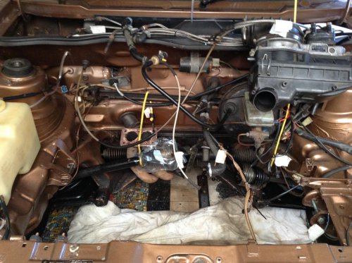

    I put engine in today but not connected up to anything yet.it was a bit of a mission
