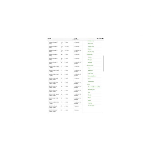

    This I've just spotted online interesting difference on the two e.v engine oil capacity.
    Doubt mine is the 3.5/0.5 must be 4.0/0.5
    Dipstick and funnel must be right after all.
  5. rubjonny
    yes the later sump is larger so I recon all is well :)
