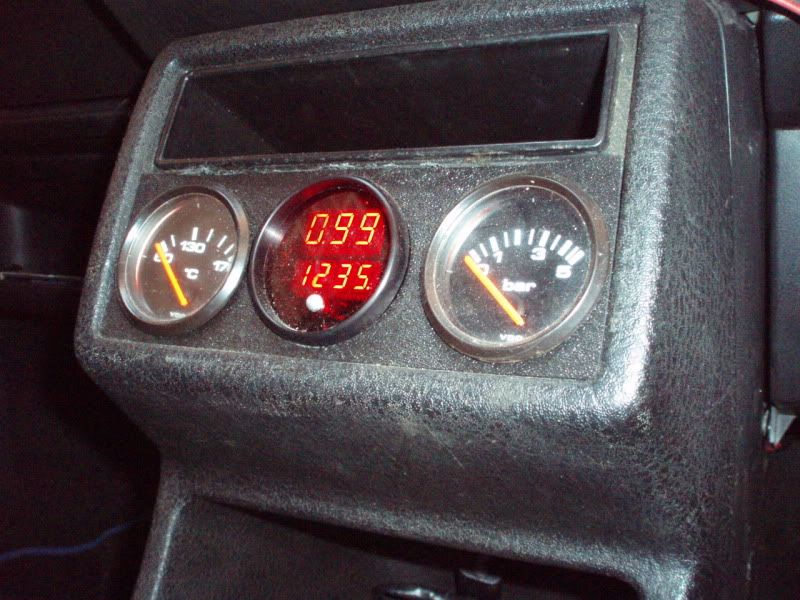

    I spent sunday with eddie mapping my car, all day my car had high oil temps up near the 130 c mark on the guage, a couple of time the oil buzzer can on warning of excessive temps. anyway it was put down to thrasshing it around London sitting in traffic etc.
    anyway on the journey home two hours of motorway driving at a steady 75 ish, the temp never moved above 100 c ish.
    since then i have driven here and there giving it a good thrashing. oil temps never above 100c again.
    until tonight left work drove steady for 5 mins then got stuck in traffic, oil temps soon started creeping up to the 125c ish mark

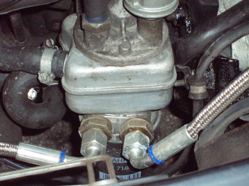

    the car has a mocal thermostatic sandwich plate and a pretty big oil cooler, both lines are hot so i know the oil is flowing thro the cooler. it also runs the gti oil/water cooler.
    water temps remain fine and the fan is working as it should be.

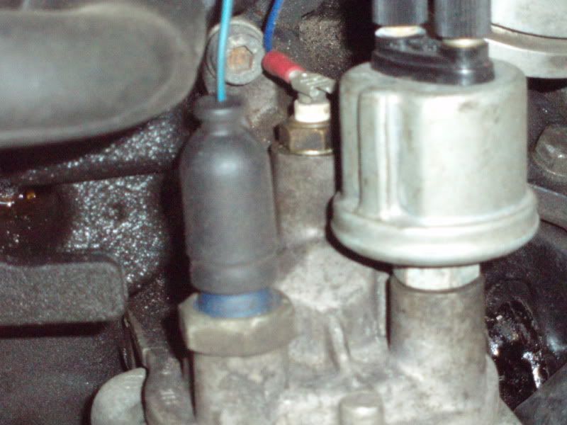

    where have you put all your sensors dude, not used a T piece have you?

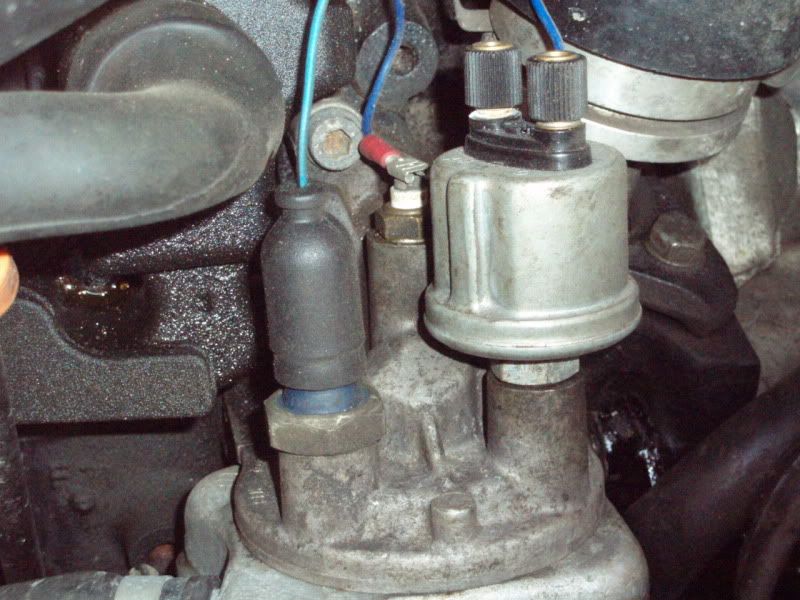

    no T piece, jonny the sensors are all in the oil filter housing, AGG engine

  10. rubjonny
    hmm doesnt make any sence, is it definitly the correct rating sensor? audi vdo needs a blue temp sensor, not the white one as used on the mk2 mfa. also not runnign 2 wires to 1 sensor are you?
    the oil warning buzzer though is worrying, if you really do have low oil pressure at the filter housing that would suggest a weak oil pump. might be an idea to get the pressure tested

    I have a 13 row mocal cooler, thermostatic plate, with the standard GTI cooler and a shorter oil filter (6N polo I think)

    its a puzzle. where else could i put the sensor?
    Jonny got a PN's for the sensor, im sure its a digi one, i have robbed from an old engine
  19. drunkenalan Paid Member Paid Member
    Jun 11, 2004
    35
    Leicester
    yes i know the blue sensor should be in the head. they have been swapped and the wiring altered too, the only mod i have ever found on the car thats not one of my own. other than the butchered Pierburg that got binned
