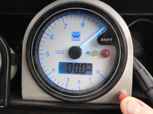

    She revs alright, the green light is 8k, the red 8.5k but the tell tale doesn't lie though ...opps!

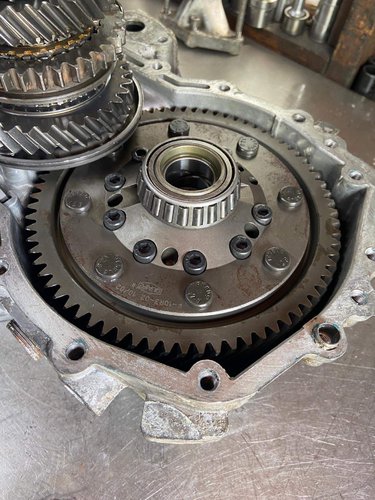

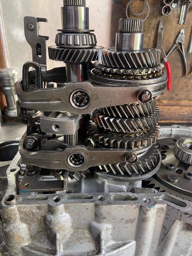

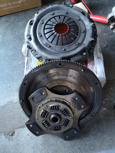

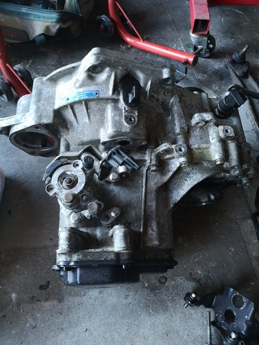

    So with a damaged box I decided to fit a different box and clutch setup to Fishy, as the SQS box is destined for my proper Hillclimb car, my MK1....known as Tatty Golf. So I shipped a spare race box I have, from my MK3 circuit racer, to Mart at Gas'n'gears to have the 3.66 FD swapped for a 4.25 FD that is more in keeping with a Sprint and Hillclimb car. I also wanted to see what was in the box as I've never had it stripped.
    As expected it was in decent condition, with a std 16v gear set and a Quaife diff, all as I was told. Will also use the Sachs paddle clutch and light weight fly wheel, as the current set up is ultra lightweight and bespoke, so destined for the MK1.

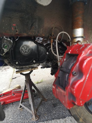

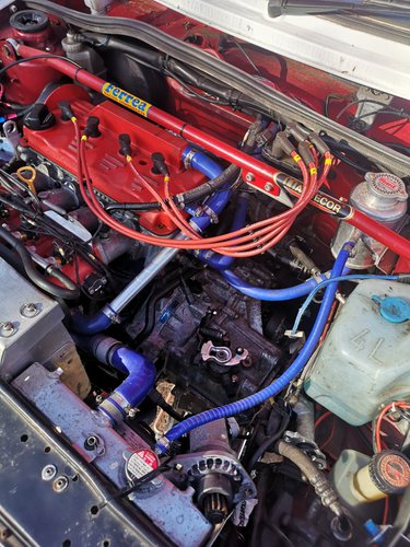

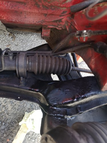

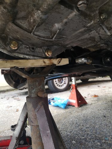

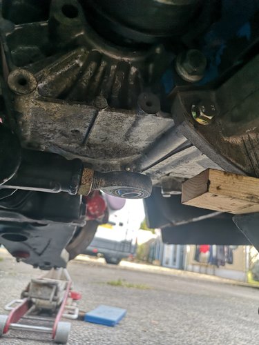

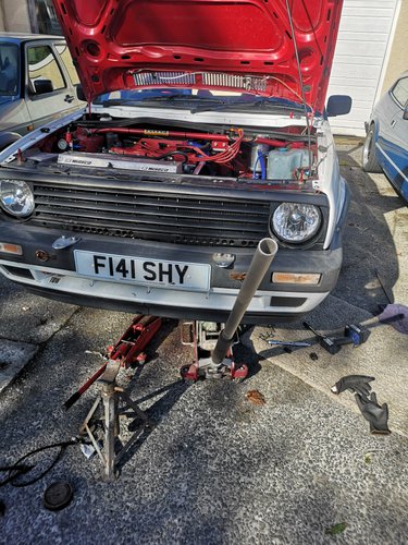

    Ok, so time to swap boxes before its too wet and cold (workshops full of other projets!). So while at it i cut off the old rear engine mount off, as its easier to get the box in and out. I originally kept it so I had options in the future, but its alwasy going to be a race car, so pointless really. Bit tight in there, but got it removed and gave it a quick spray.
    Swapped the modified 02J shift tower over from the broken box to the 02A box, and fitted it. Easy enough, just rolled it under the car and jacked it in to position, with a bit of wiggling and a deep breath to lay under it and lift it off the jack in to place (its not an 020 box that you can just drop on your chest and roll out lol)...did get my son to help for 5 mins, just in case it fell on my head :lol:.
    An unforeseen issue was that the 02A doesn't have the bottom wishbone mounting point that the 02J has, so the bottom brace is floating in mid air. Not a big issue, just need to fabricate a mount that has two handily situated bolts to pickup in line with the torque arm. For neatness I'll make a longer torque arm up to sit closer to the mount point. I'm weighing up how long to make it, as I feel having if right under the engine it would make the distance from the two side mounts pivot point ( that they create on their own) would multiply the torque on the bottom mount, so a balance between the length of the bottom bracket and the bending risk, and the length of the torque arm to minimise the force on it.
    I've got it all planned in my head, so just need to make the time now.....and make a spacer for the high torque Wosp starter, that I've modified to suit the Touring Car flywheel, that I've now swapped out for a lightweight std one.

    Did you bend the dipstick tube so far back it is between the manifolds now?
