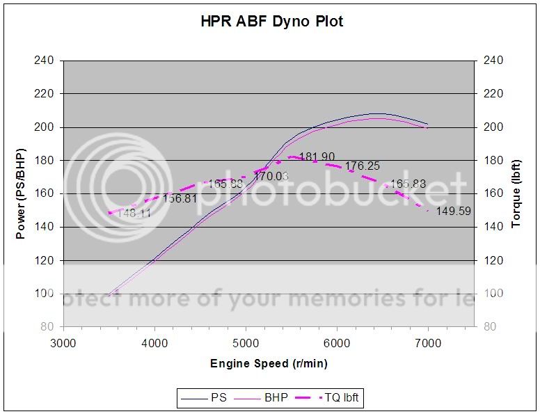

  10. HPR
    HPR Administrator Admin
    Aug 11, 2009
    1,819
    ABF with STD inlet manifold and TB
    209 Ps @ 6637 rpm
    247 Nm @ 5436 rpm
    3500 100 PS corrected
    4000 121
    4500 144
    5000 164
    5500 193
    6000 204
    6500 208
    7000 202
    82.5 x 92.8 mm
    Wossner pistons
    Ported head , reworked STD valves
    276 hydro cams
    4-2-1 / 63.5 mm exhaust

  12. Toyotec
    Toyotec CGTI Committee - Happy helper at large Admin
    Jul 26, 2006
    3,324
    Creating Pfredstarke
    I just did some back calulation on those numbers and I am getting torque values that are more akin to a 2.1 or 2.3.
    A fairly modified 2.0 engine achieves near 170lbft and will require higher revs to do so.
    This engine runs a fairly std torque profile and rev range and is hitting 181lbft at a factory 5500rpm?
    VR6 2.8 torque from a N/A 2litre not at 6500rpm but at 5500rpm?
    What dyno was this thing tested on?

  17. Toyotec
    Jul 26, 2006
    3,324
    You could get stock engines to exceed that. But it takes a lot of time and the torque will be based lower in the rev range i.e. from 3600-5500, then it will nose dive. More torque than this and you will need cams+ fettling, compression, more control calibration plus more revs to achieve.

    HPR pwr/torque plot back calculated from bits of data in post 48.
    Must be some sort of STD control system as well 7000rpm limit with a 276?
  19. danster Forum Addict
    Apr 2, 2008
    15
    The engine HPR mentions is described as having Wossner pistons in it. They tend to be marketed at around 12: 1 CR. Presumably also got aftermarket ECU and along with those cams, does that seem completely unrealistic?
  20. Toyotec
    Jul 26, 2006
    3,324
    But the torque trace is just as a std ( but optimised) profile just + 30 lbft according to that dyno and its correction. For the cam mentioned and possible piston choice I would expect a torque profile with a peak shifted +500rpm to around 6ishK and slowly ramp down to 7200rpm or so. The huge torque numbers on this plot does NOT make sense for a 2.0 16v, not from what I have seen and tested and driven anyway. But hey you never know...
    If that torque trace correlates to any thing I have tested then I would say a peak of 170lbft at 6000rpm with the slow ramp to 150lbft at 7000rpm with a rev limit of 7600 where you may still be making 110lbft.
    But I cannot understand what is responsible for the spike to 181lbft at only 5500rpm and why the test stops at 7000rpm where you are still producing 150ish lbft.
