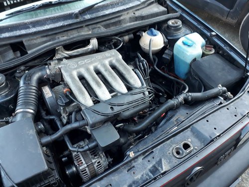

    10 montsh ago i swapped from 1.4 to 2.0 2e. Now i want more power and i want to swap to a abf engine. My first question is. Can i use the 2e gearbox and flywheel? I don’t want to convert to hydraulic clutch.
    Another question i have is about wiring loom. Is enough to swap engine loom that is in the engine bay ? Must swap all the wiring loom from engine bay to fuse box in car?
    Thanks for help in advance! Cheers !
    1. yes, no problem. but its not hard to go hydro clutch all mk3 pedal box are the same just bolt on hydro parts and shifter setup and you're done
    2. need complete loom right back to fusebox, just try to get the right age to match your mk3. early the engine and headlight looms are separate, late its all one big lump. you can convert looms either way just needs a bit more effort rather than drop in and go

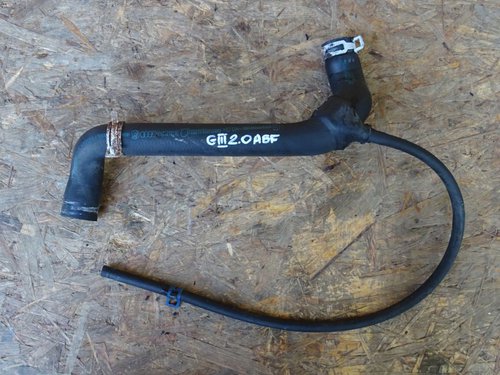

    Hoses from cooling system of 2e fit on abf?
    if you keep the radiator yes you can use the 2e hoses, only thing is the thin hose to the header tank has nowhere to go. so you can use a mk3 abf top hose or what I did was grab a plastic flange with nipple off a mk3 golf and insert it into my top hose.
    like so:
    if you do go for an abf top hose make sure the thin hose isn't blocked. for some reason VW put a plastic fitting at the junction where it fits the main hose with a tiny hole thru the middle which gets clogged up really easy and makes the coolant system harder to bleed

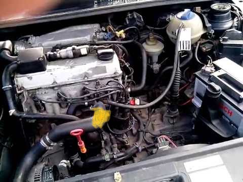

  9. AleeexGF New Member
    Nov 13, 2019
    So the thin hose i can put in the main hose of radiator? (I make a point yellow on main hose)

    yep thats the one, the abf top hose looks like this:

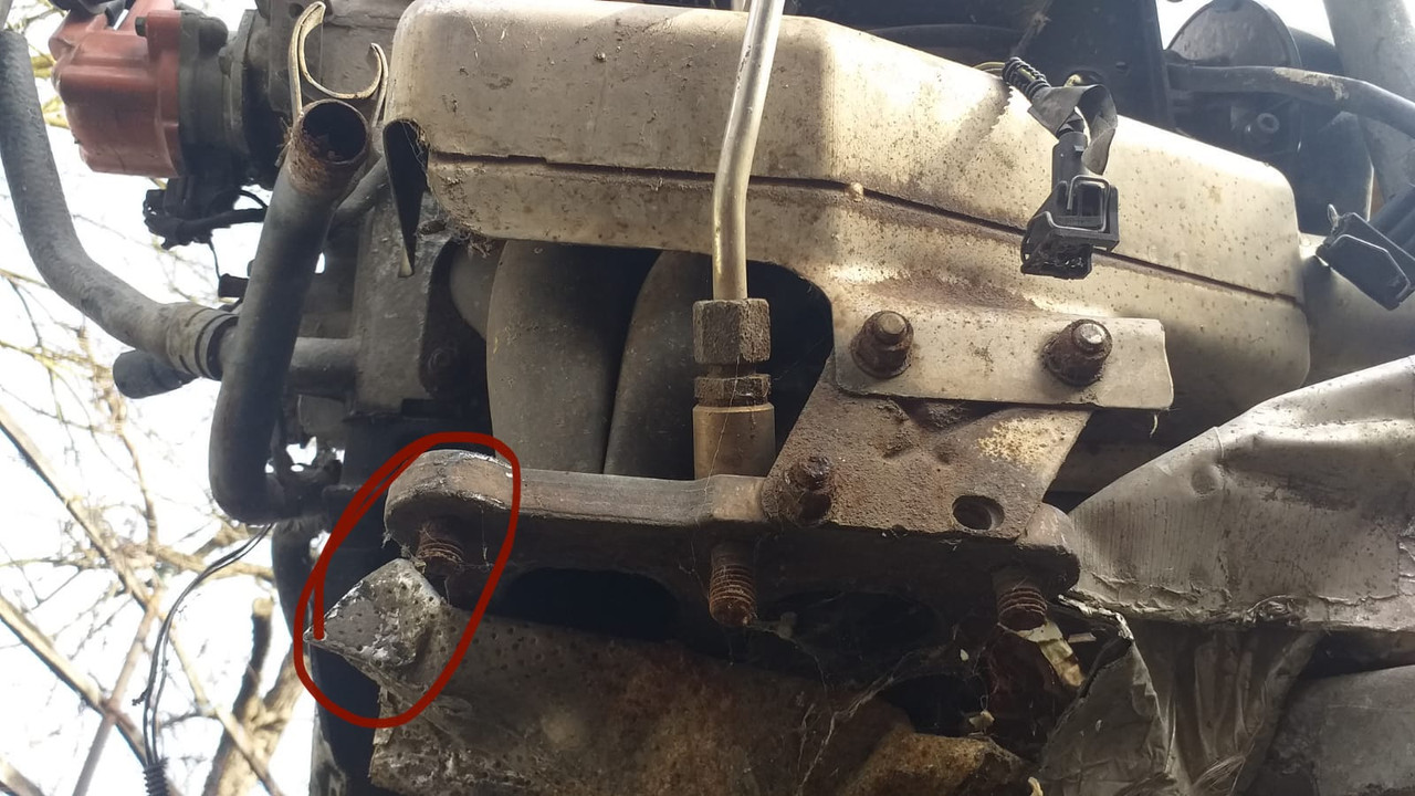

    Another question! The oil filter mount from 2e fit on abf? Is possible to have problems to fit the exhaust if this screw is ripped? [​IMG]
  14. rubjonny
    yep the oil filter housing will swap over, and you'll want to swap out the sheared studs out as you'll likely get an exhaust leak if you cant tighten all the nuts down

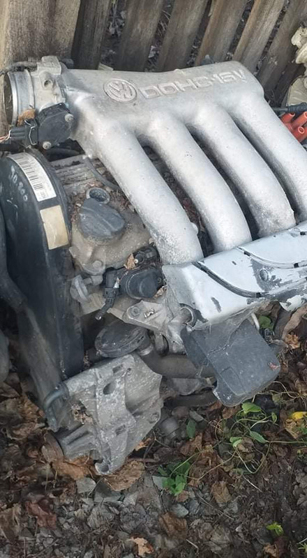

  16. AleeexGF New Member
    Nov 13, 2019
    If i don’t have this airbox with this sensor can i improve to attach this sensor on my 2e airbox? And another question.. i bought just engine, engine loom and ecu. Which parts i need and don’t fit from 2e?
  17. rubjonny
    you shouldn't need to worry about the head gasket so long as its been stored semi-dry, take the plugs out to check the condition and shine a torch down the bores make sure it doesn't look rusty inside. look down the inlet and exhaust ports etc.
    I would replace all the belts on the outside of course, plus rocker cover gasket while its apart.
    for inlet temp sensor what I did on a friends MK2 while we searched for the right airbox was just poke it in the hole round the back of the airbox for the warm air feed for the exhaust, worked just fine.
    not a lot else you can keep from the 2e, you could swap the alternator and bracket over if you like but keep the crank pulley from the abf. pas pump setup is the same either way so if nothing else I'd strip the 2e stuff off and keep for spares.
  18. AleeexGF New Member
    Nov 13, 2019
    Engine stored in garden just covered with just a wrap. So don’t need to change head gasket and valve seals?[​IMG]
  19. rubjonny
    unless you see any kind of corrosion inside the engine you'll usually be fine :)
    the fuel rail looks to have been left open, might be an idea to split it open to clean out the inside
