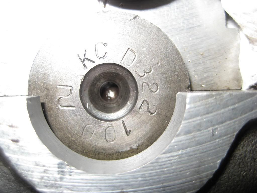

    spoke to Kent cams and David Newman camshaft no joy, drew a blank !!
    Found the contact details of what I was told was the original engine builder (thought promising) He informed me that he didnt build the original but new the history and had carried out a rebuild etc, He then told me that he thought it was a Mike Callahan Motorsport engine ( That would bne good) further investigation required.
    I then checked the cam on my Hotrod engine built by Mike Callahan but identification no's different type of stamping/ etching.
  13. mr hillclimber Club GTI Supporter and Sponsor
    Nov 24, 2005
    149
    Southwest
    KC is a Kent Cam's mark Ray...they do like to play their cards close to their chest, particularly if it's been ground for an engine builder. D is direct...i.e a solid lifter profile..and 322 "could" relate to the duration, tho the grind numbers are normally something like D10**...
    I can get the profile checked Ray if that's any help....fire me over a PM if you like.

    Thanks for the offer, couldn't make any headway on those GP5 cams (got three of them now) seemed to be almost standard choice for the Slick 50 cars
