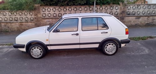

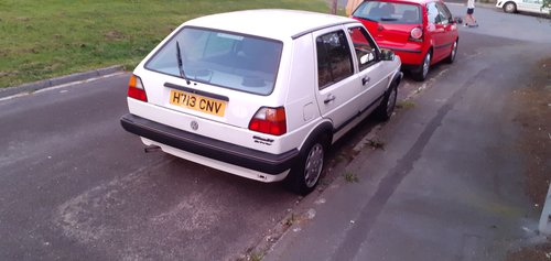

    Hi guys, well few months ago my wife got a mk2 cl that we are in the end stages of restoring, few little bits to fit back on now.
    And then this week an advert came up locally for another mk2.
    Went and had a look, 1.6 driver, 1991 model, automatic. 2 owners from new, full service history, original bill of sale, loads of history with it. 93000 miles
    Pretty tidy, few trim bits need sourcing, fuse cover, mirror knob, and has a few scratches on the roof, and little jobs of couple dents, nothing major.
    Came with original 14" steels and set of bbs alloys on it, plus spare gti grille.
    Looks like I've got the new home for the 1.8t engine now, well when I've got few more bits

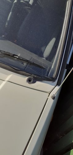

    Had another look quickly today and needs fusebox cover, front wiper bung, interior mirror knob and one door speaker grille, that's about it.

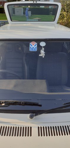

    Anyway, managed to do little bit of work on the white golf. Club gti sticker arrived so that has pride of place in front windscreen.

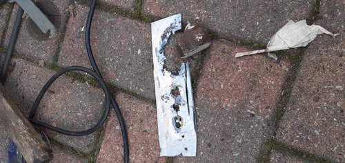

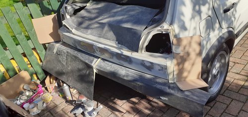

    Did some panel beating and removed the dents from rear panel, filled and primed. Ground the rust and treated the small area by the windscreen wiper blank. Then had a poke at the barnacle on the drivers door, massive lump of filler moved so out came the welder and grinder, cut out and replaced with metal, painted and first filler skim on it now.

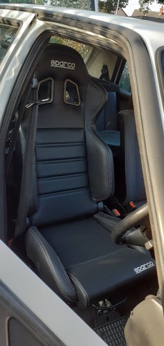

    Inside I've been able to fit one of the sparco seats that I had in the mini, but have to collect the other as guy still has it in the mini but not fitted his replacements yet.

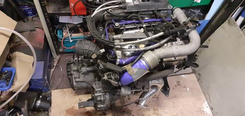

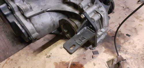

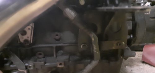

    Got a bit of time today to sort the garage and get the MG out, so I could get to the 1.8t.

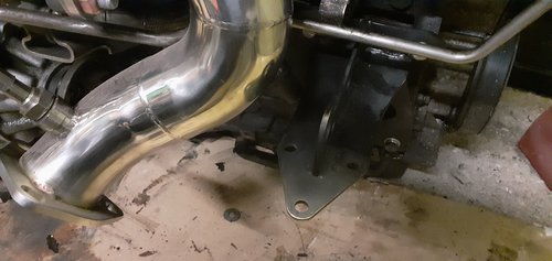

    Removed the o2m from it, changed the flywheel to the g60 one I got off Ebay for £27, new vr6 clutch kit fitted, bolted the o2j gearbox to the engine along with mk3 slave cylinder.
    Checked the front mount as have 2, a mk2 16v one and a mk2 caddy tdi one, question asked in other thread.
    Rear mount for mk2 subframe bolted on, more clearance for the turbo oil return, still needs tweaking, but much better than before.
    Gearbox mount fitted, just need to pick up some more bolts.
    Replacement reverse switch and shorter belt to delete power steering all ordered, speedo cable arrived and fits the box.
    Mk3 gti wishbones have new balljoint fitted and the driveshafts had new inner cv joint kits, pair of non pas mk3 track rods ready to swap.
    Custom hydro clutch line should arrive from Hel this week.
    Pile of bits is growing, fuel lines, mk3 tank, brakes, pedal box, suspension, intercooler, badge refurb kit from grafshed, and countless other bits, just got to find some time to start fitting things, then can work out boost pipes and all the other bits I've not realised yet.

    Seats already changed for the set of sparco r100 ones that I had in my mini that I only drove to mot and home, then the tester bought it off me!

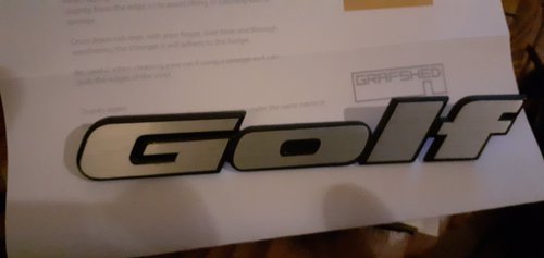

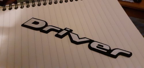

    Weather stopped play outside, so after doing a bit of decorating in the hall I've finally got round to sorting the rear badge using a Grafshed refurb kit.
    Really pleased with it, just have to remember the safe place I put my Driver badge now.

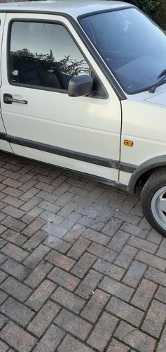

  12. rubjonny
    driver wont have red trim originally often added for the gti look :)
  13. dodgy
    Thanks, saw some bits saying 1.8 had red bits, 1.6 was normal. Still have original grille in garage so may pop that back on when swap new wing on.
  14. rubjonny
    the 1.8 had red stripe bumpers, but grille still black :)
  15. dodgy
    Cool, have red (pink now) stripes in bumper, but some of it is broken and missing, have some chrome off the green ones old bumper so may piece it back together, then vinyl tape it.
    Cant find any replacement or the chrome type.

    Found it, not where I thought it was.
    Nice badge again now.

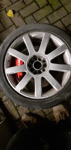

    List of required parts is getting smaller, exhaust soon, and more tyres for the rims, 9 spoke Audi wheels as a nod to the S3 that donated the engine.
    cupracraig likes this.
  19. Savagesam
    I don’t like the wheels, I think you should give those callipers to me! ive got some 256 16v stuff you can have in return ;)
  20. dodgy
    I am a little sad to have to lose the borbet As off it, these may be a stop gap set of wheels, the brembo calipers are pretty big so 17s upwards.
    Did think of g60 style disc setup but it will be more outlay, and rather buy exhaust first. Its hubs, discs and calipers plus mk2 shafts, whereas have all vr6 front parts to fit already.
