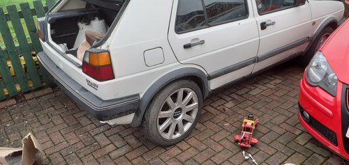

    Fixing the polo today, so had a bit of space on drive and the jack out and thought would do a quick trial fit.
    Popped one of the S3 alloys on the golf, tyre profile is wrong admittedly, but dont think it's too out of place on the car, 17" and a boxy style.
    They are on the polo for a while though.

    do you HAVE to run 17’s to fit them? Would they fit behind 16’s?
  6. dodgy
    Leon runs 18s as standard, think smallest is 17 from what I've read, it has a lot to do with the spoke clearance to caliper, 5mm spacers needed with the S3 wheel, TT comps fit ok, 17s again, as is the leon cupra 'starfish' on non R but needs spacers.
    The bbs 18s I had would need 25mm to clear calipers, so that's a definite no.
    I did try the 16" polo sport alloys on ages ago and that wouldn't allow the centre bore to line up as too small.

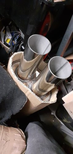

    2.5" system, twin straight ends.
    Was a year between getting downpipe and buying system, plus I didn't have a recipient car back then.
    Didn't know whether to go with twins or stick with offset single for the 'basic' look as mine isn't a GTI, but settled on cutting rear valance to fit it, plus if I ever went big bumper it will fill the recess .

  10. Savagesam
    That’s what I had on my old car.
    I don’t know what to do with mine, I want slanty tips, but don’t like the way trackslag have done theirs, I want 2 pipes coming out not one then into 2. First world struggles ey?
