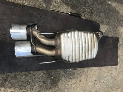

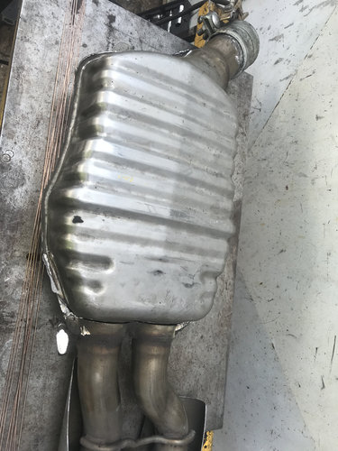

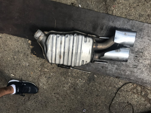

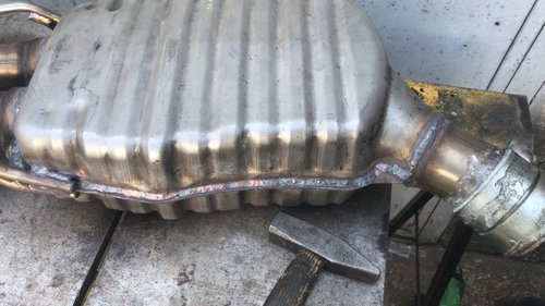

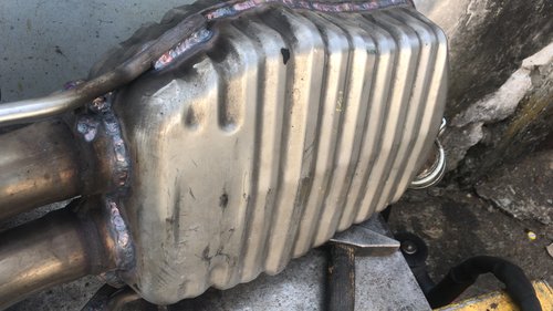

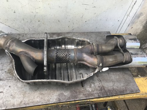

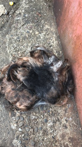

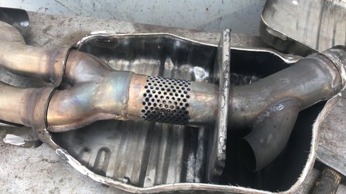

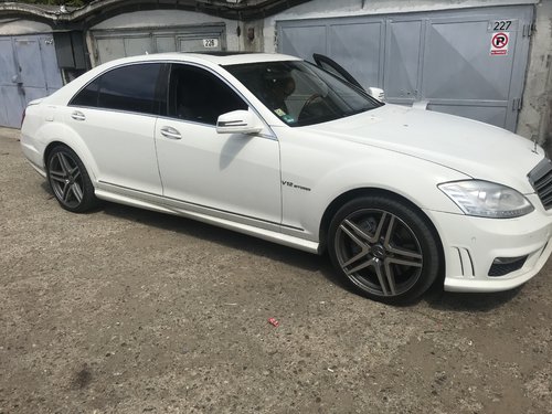

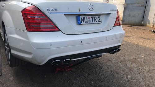

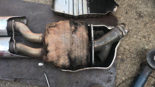

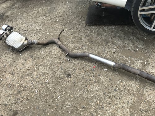

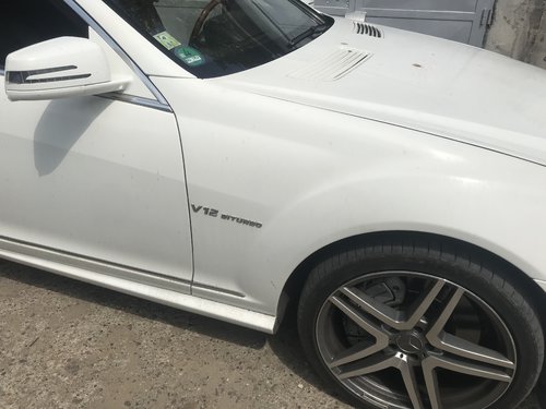

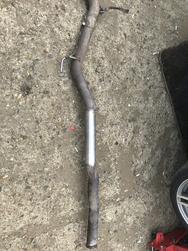

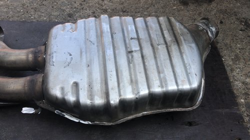

    I have done a similar job to a Mercedes amg just in reverse order (!), customer wanted it a bit more throaty ! Cut back boxes open and removed the padding + welded new pipe inside the boxes to keep it TUV friendly. However the Main noise canceling were the middle silencers, by removing those a gain of over 20 decibels was achieved !
