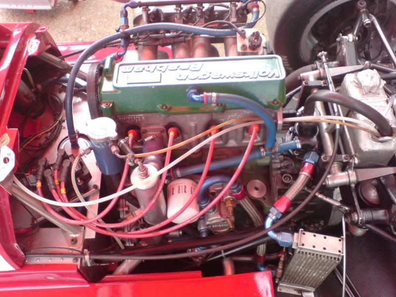

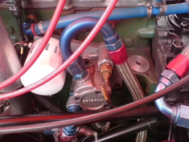

  11. danster Forum Addict
    Apr 2, 2008
    22
    That looks like a later block. If you look under the lower right side of the coolant outlet off the head inbetween 1 and 2 cylinders, you can just make out the extra meat on the cylinder head gasket face of the block for the second oil drain found on later engines.
    The early flat head 1588cc head does not have this second oil drain.
  12. A.N. Other Banned after significant club disruption Dec 5th 2
    Yep, looks like this one if anything to go by :thumbup:
