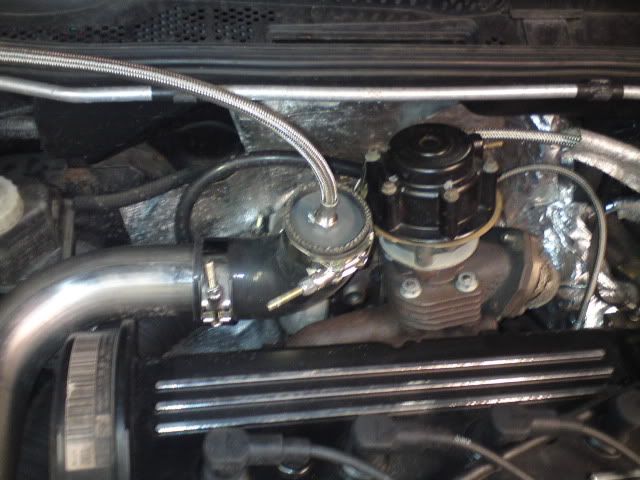

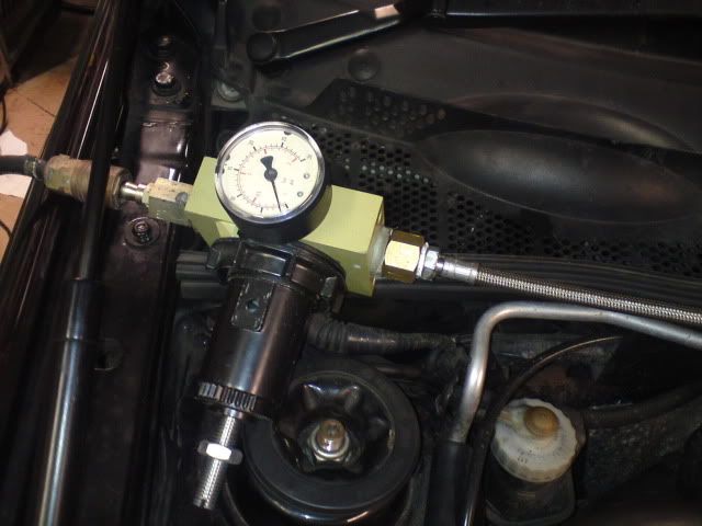

    Use mine for tyres mainly as its a bit small. But very good for boost checks too. Need to get a better one really, but it was free so can't complain.
    Used a piece of solid plastic with a hole tapped for a line to connect.
    Connected to a regulator.
    I also made one to attatch to the turbo inlet but used a tyre valve. Which is better as it test whole system.
