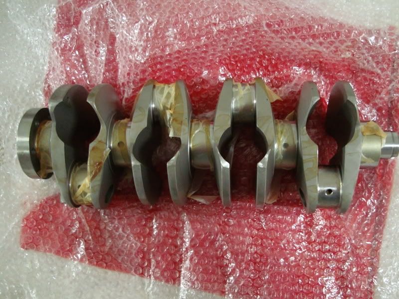

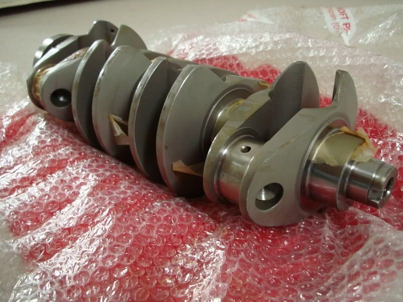

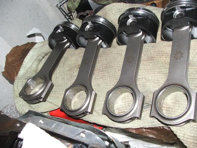

    Well the time has come for the 2.1L 16V Build.
    So time for the 2.1L 16V Build
    ABF Block bored to 83.5mm (2036cc)
    Integrated Engineering 159mm H- Beam Rods
    ARP Main Studs
    ARP Head Bolts
    ARP Crank Studs
    Eurospec Crank 92.8mm
    83.5mm Forged Pistons (JE Pistons)
    and need to decide on the rest of the shopping list.

    Have you checked the con-rods in the old engine to check they haven't gone oval at the large end, or that they're not slightly bent?

    The ones i'm gont to use are Brand new con rods i got last month from Integrated Engineering last month, all the ARP Gear is new too.

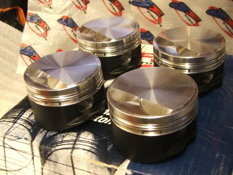

    I'm just waiting for Pete @ Int to get back to me with a piston price, don't think they can do JE in the spec i want but i think they do Mahle.
    Which pistons did you go for Mike ?
    The ones that went today were standard rods and pistons, Nige P blew three pistons today a Donny Track day so he wants my old Pistons, like you say don't know if the rods will be any good to him but i have a few more spares.

    Has anyone got any good links for Billet Cranks for teh ABF 92.8mm.
    Mike what crank are you using ?
  5. sambo Paid Member Paid Member
    Jan 12, 2004
    441
    Brooksters, how about eurospec ones?
    Mike, what are you building, somethink juicy?

  7. sambo Paid Member Paid Member
    Jan 12, 2004
    441
    Got a eurospec one in my audi, cant fault it, at high revs is smoth as
    No nasty vibrations

    Bildon havn't got any cranks just got e-mail fro them, just waiting for the Eurospec to get back.
  9. Brookster
    May 17, 2004
    150
    M1 J40
    Just sourced a Eurospec Crank from Neal H
    Cheers Neal :thumbup:
    will fit the ABF Trigger wheel straight to it.
    Just Pistons now to get.
  10. sambo Paid Member Paid Member
    Jan 12, 2004
    441
    I was just about to post a link for this item! Well done brooky

    Looking for JE Pistons 83.5mm 10.5 :1 comp, waiting for a few prices back.
    Going to drop the block off tomorrow for the 83.5mm bore.
  12. Mike_H Forum Addict
    Oct 16, 2004
    16
    iQuit
    Why the low CR? Is it for a forced induction engine with stacked gaskets, or does NOS work better on a 'normal' CR?

    Mike - i'm going standard compression with the Nitrous set up i'm running.
