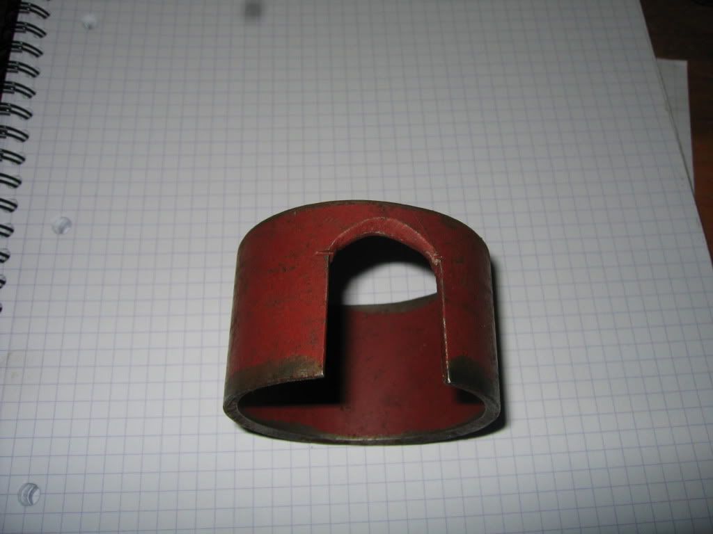

    62.5 OD x 3 Thick x 40 Long ST52 CHS. + Dead Blow Hammer.
    All good Dave, except for "ST52 CHS"
    Is that a post code, or a tool part no?

    CHS = Circular Hollow Section. But, you could have Googled it yourself!;)
  4. A.N. Other Banned after significant club disruption Dec 5th 2
    Ah ha, all over the Google now, ta boss! ST52 is a metal grade.

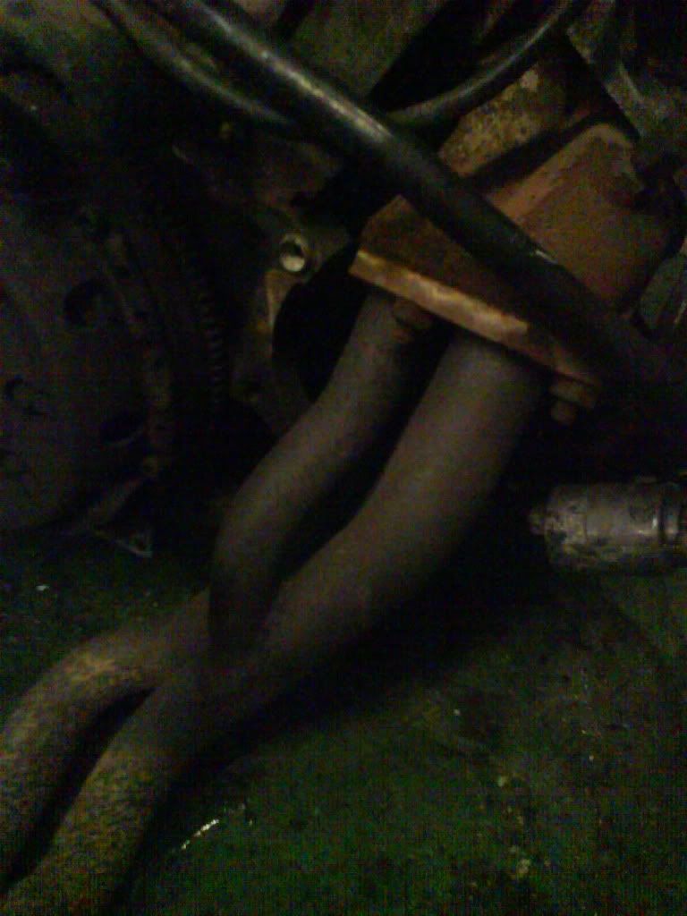

    Just to drag this up a bit, on the matter of the 20v being a 16v with an extra pot stuck on the end -
    The port for the 5th cylinder on the standard exhaust looks like a total afterthought, 1+2 and 3+4 go into a pair of fat pipes, and the 5th is just a piddly one welded into 3+4 [:[]

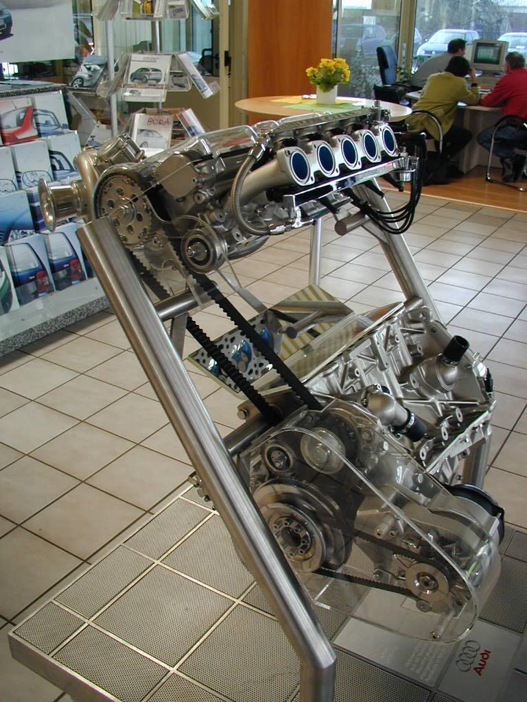

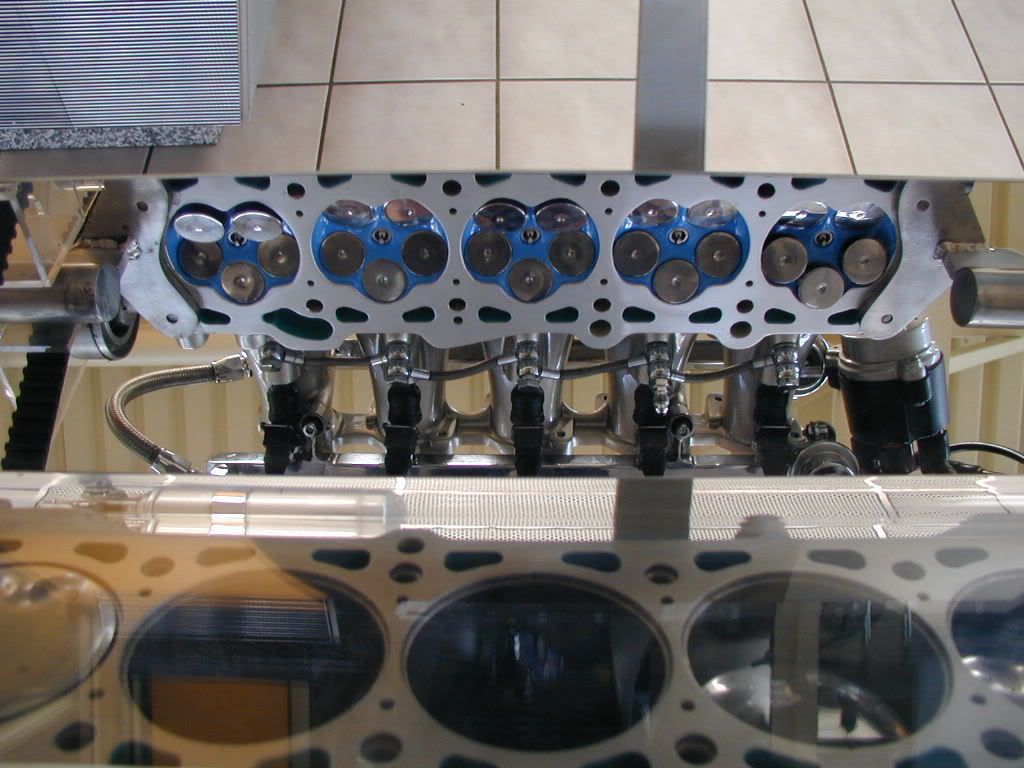

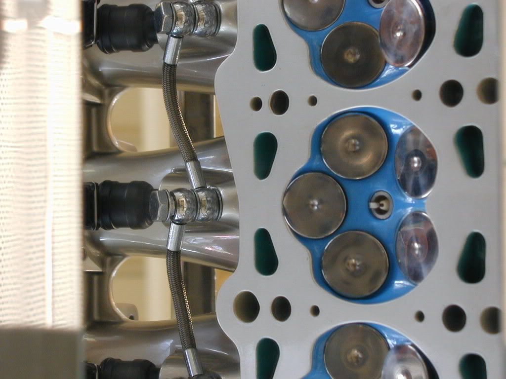

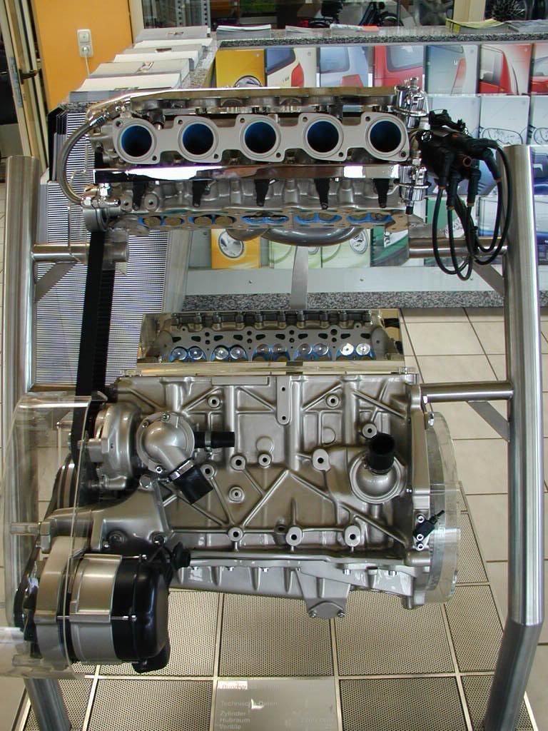

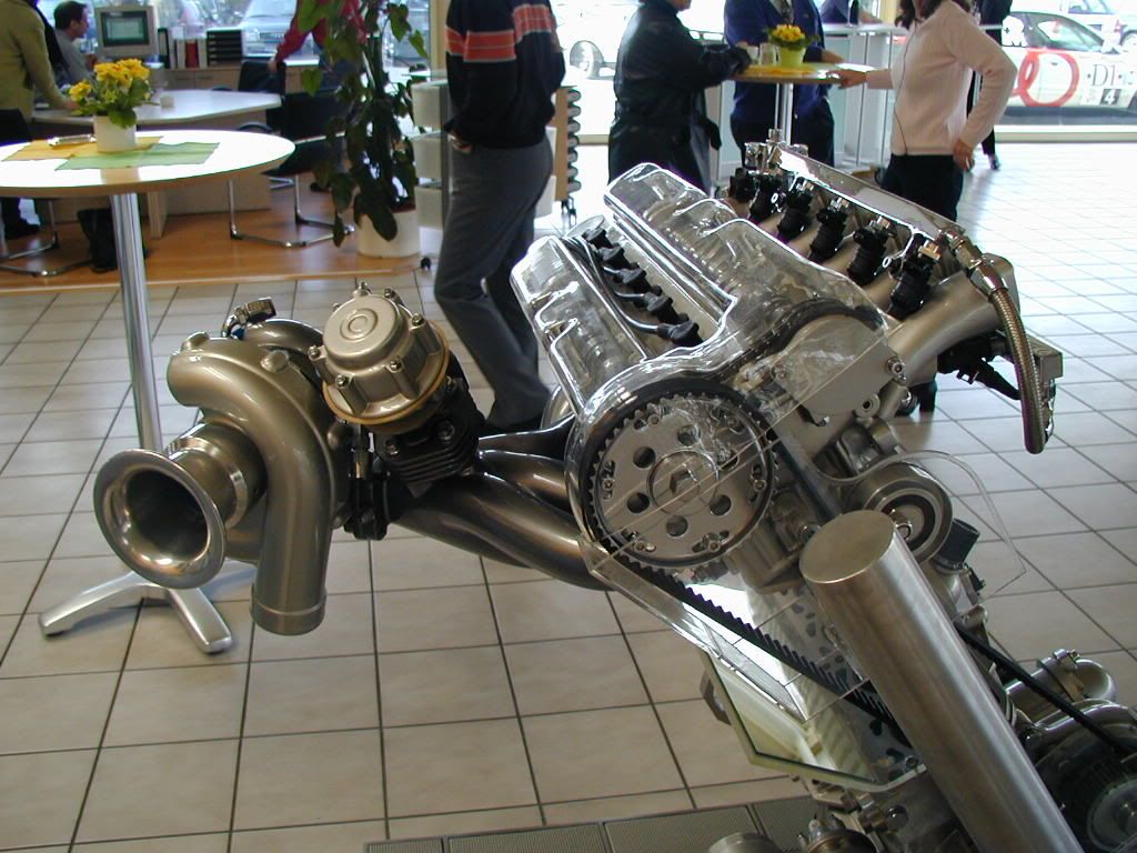

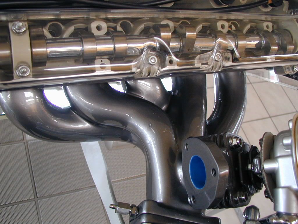

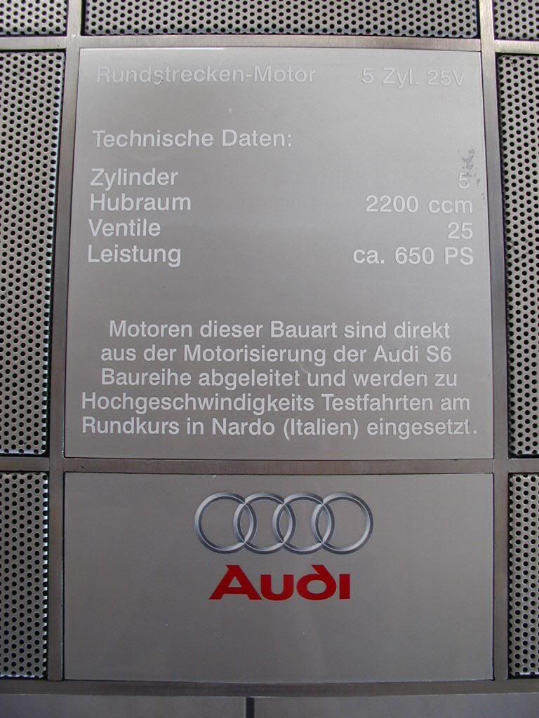

    25V Engine
    Chain drive cams. Not gear drive as Chris found on the 90 Rally car.
    Interesting water pump, nothing like the 20V production motors

    daved, that water is different as it probably has to work on that engine!! the standard pumps are pants! plus the poor design of the cooling system doesn't help!

    Almost deserved of its own thread - lovely!
    I'm amazed how much VW recycle its ideas across the VAG ranges, even too looking at some of this motorsport stuff we all dig into.
    What really was the reason why they didn't produce this 5-valver? It seems totally logical they should? Or am I getting mixed up with another unit? Did the Audi 4.2 V8 go 5-valve?

    I reckon Audi built that engine as they had a load of old small block water pumps from Polos and Golfs lying in a shed. ;)
    And obviously someone got the number wrong when ordering the valves too. :lol:

    Looks like that 25v block has dropped the IM shaft and gone for a water pump location similar to the 06X blocks. Presumably a chain driven oil pump in the sump too.

    Chris, Audi did do a 40v 4.2 AFAIK, the head a similar (probably the same as a 20v)
    Dan, the 25v could use the normal 5 cylinder pump whch mount on the front the crank, behind the front pulley.
