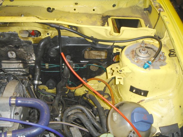

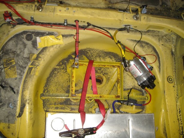

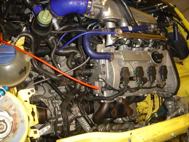

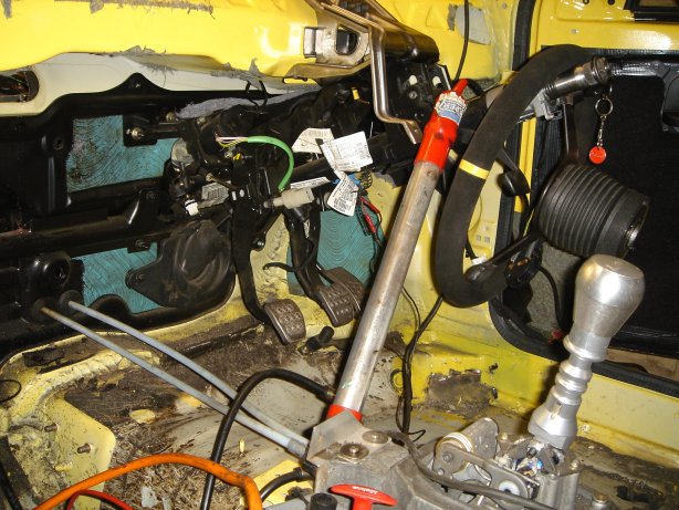

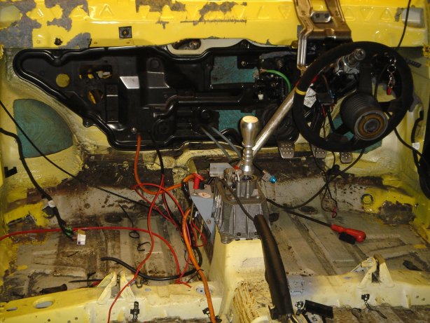

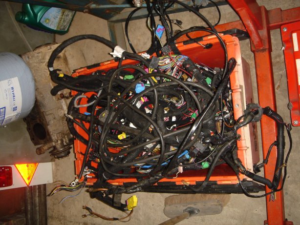

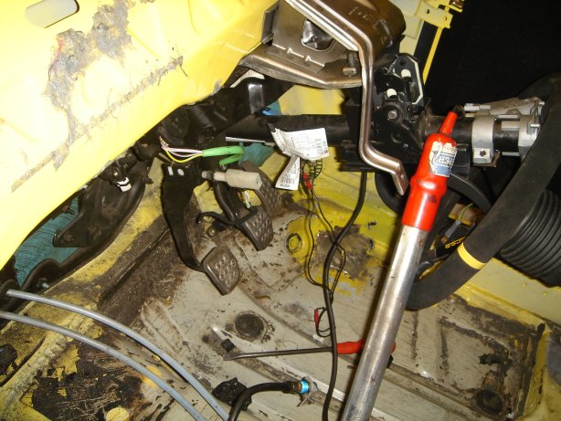

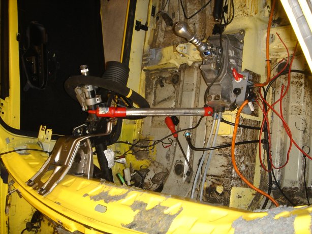

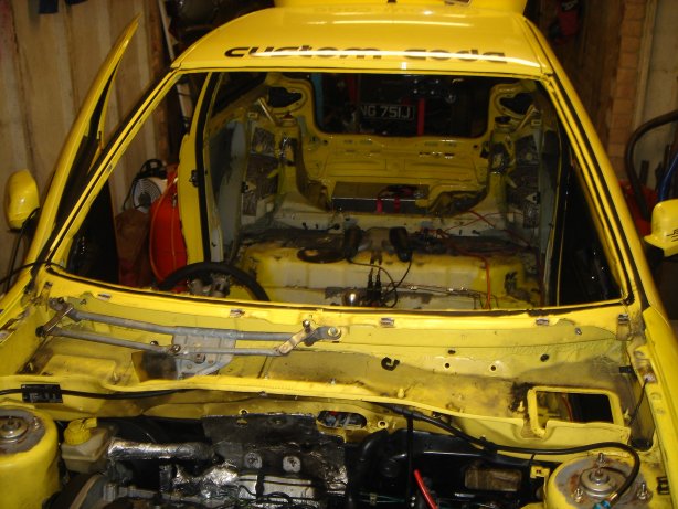

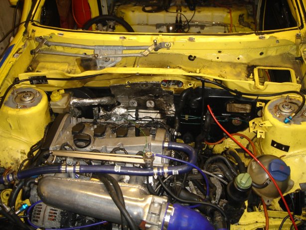

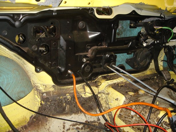

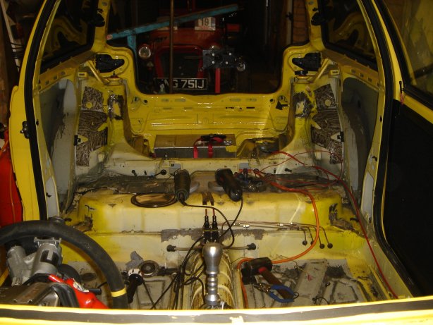

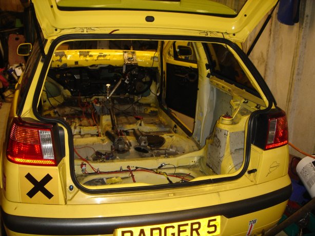

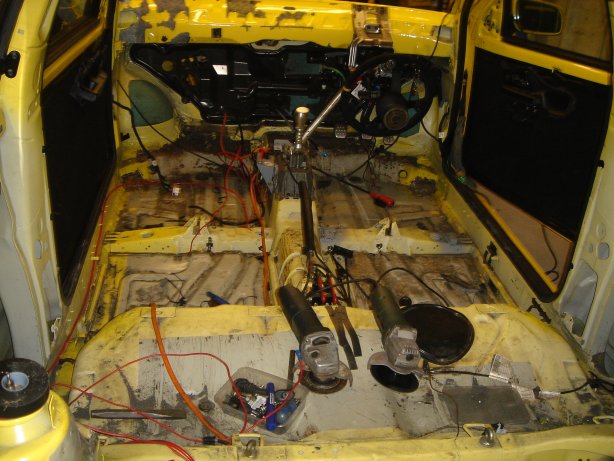

    Badgerwagen is in kit form currently... 1000's of bits.
    stripped bare internally, devoid of all factory wiring, dash, heater, AC evaporator etc etc etc...
    30kg of wiring alone has come out of it. amazed at the qty of wiring sat behind everything.. complete 'mare to remove. Going to be a lot of hours rewiring just essential stuff again. DTA S60 ecu, possible DTA LCD dash also if funds allow.
    Some pics of the prgress to date:
    the dirt in the pics is grinding dust from cutting out its old cage platforms, in readyness for its trip to Custom Cages for a full on works weld in cage.
    pix below:

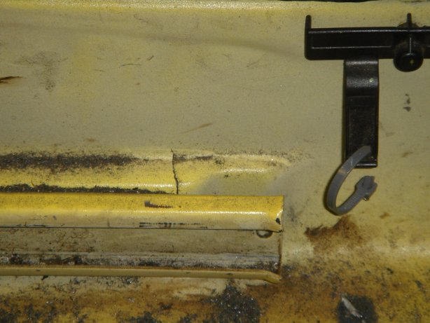

    and alarmingly a crack I found on the drivers side seat rail!!

    broom? to sweep all the grinding dust nasties I've created.. got to clean it all out tomorrow.. its a right state in there.
    I fear for the hours its goign to take to rewire the whoel car from scratch tho... DOH!
    muchos weight saving tho... I can hardlyu pickup the box of wiring and stuff I've removed and thats just one of two boxes this size of bits.
    remember the "sensible road car"???? oh dear what have I done

    A few reasons.. mainly proper roll cage going in for more peace of mind at the speeds the car can move these days, and having seen 2 massive accidents in the combe saloons. (both evo's, one of them the spectacular crash from simon norris)
    Full Custom Cages multipoint going in.
    Also weight reduction as its only been a road car basically stripped out for racing, not a full on strip back and start over. There's got to have been another 30kg of wiring alone come out, plus a load of dashboard and heater cr4p removed. Hopefully sub 1000kg now, but new cage will add more kg back in again.
    got me a lot of hours ahead rewiring the thing again for lights,ign etc and also for S60 ecu and GDash. God what have I started.

  10. FaTT mk1 Forum Member
    Jan 18, 2005
    Ill be watching this thread!
    Ur shifter cables, i take it youve put them through the bulkhead? is that a standard ibiza shifter? where did you get the gromets from on bulkhead. Just looking for one as people say the ibiza one is ideal for mk1 02A swap.
    Daz

  16. badger5
    badger5 Club GTI Sponsor and Supporter Trader
    15
    nr Glos
    std ibiza cables & shifter box still yes. just B&M shifter
    just electrical grommets, nowt special

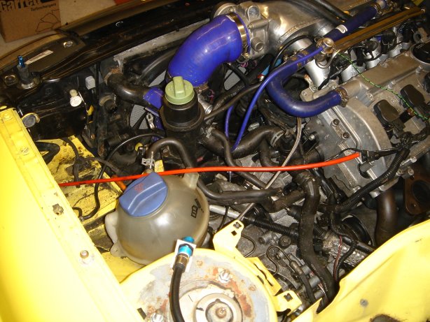

    Loom does'nt phase me but the time to build one is long when I've scratch built them before. I will likely shortcut some of the wiring by using a kitcar kit for basic wiring, and see what options I have for the DTA S60, start again or use a DTA loom.. but need to tailor it to the 1.8T motor and sensors. Got that bridge to cross yet.... will see what I need after autosports show me thinks, whilst cars away having its cage fitted.
