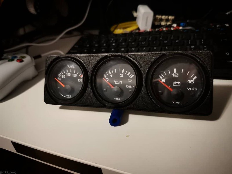

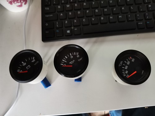

    Guages all working as expected. They do need a refurb on the bezzels though. i'm not sure how to split them though. I know its possible as you can buy kits to change the colour. Maybe heat them up with a hair dryer?

  5. Vinnie Paid Member Paid Member
    Aug 16, 2020
    62
    Looking nice
    4” grinder should do it [:D]
    pretty sure a flat screwdriver would do it

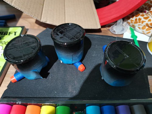

  6. cupracraig
    cupracraig Paid Member Paid Member
    Jul 14, 2015
    380
    South West
    Ohhhh i don't think i could cut them! I might just really carefully mask them up and lightly scuff the bezel then sprat with some satin black. its a low / no touch item and that should be enough to make it look nice?

  8. Savagesam
    Savagesam Moderator Staff Member Moderator
    Nov 24, 2012
    1,107
    That’s what I’d do. Some scotch pad or whatever they are, prime and paint.

  11. Peter Forum Member
    48
    I had the same gauges and did the same as above, didn't prime them just dusted them with satin black, really tidied them up and lasted for years without any issue

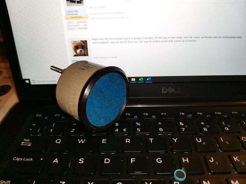

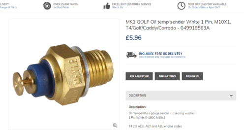

    on the things to order will be :
    Genuine VW AUDI SEAT SKODA Beetle Cabrio diagnosis plug mounting 6N0972559 to mount the VCDS
    I've ordered 2 x new temp senders and both have come through incorrectly (from what i understand) as black ones that read 0-180 i believe.
    Heritage have these on their site but they come through as black ones. i feel like they keep sending the Febi/Topean 049919563B versions which are 0-180 degrees and my guage goes upto 150
    I need to find some genuine senders i think @rubjonny did you know the genuine 0-150 degree part number?
    The current sender that works as expected has b310 1-1601 on it so I'll do some more googling to see if I can find the brand
    also found a couple of Topran units in the garage :
    100854- 049-919-563A - listed as a white mk2 0-15 on the thread below but its black and defo a 180 from my test earlier
    103113 - 1H0-919-563 which is a 0-150 degree sender from a mk3
    https://www.clubgti.com/forums/inde...range-and-colours-mix-and-match-guide.228287/
  19. rubjonny
    rubjonny Administrator Staff Member Admin
    Oct 31, 2003
    3,321
    Bracknell
    if the sensors are aftermarket you cant always rely on the colour coding thats the trouble, so test as you have done to double check. also as per the thread, ETKA says the white sensor is 0-180, but the genuine sensors are stamped 0-150 this is why some sites list the MK1/2 ones as 180
    the MK3 1H0 sensors are actually pretty close resistance range to the black dash temp 0-125 sensors as it turns out, not 100% exactly the same but near enough for a mk1/2 gauge people have found. I suspect the difference is the 1H0 is slightly more accurate at higher temps as its designed for oil rather than coolant, hence dash one is 0-125 and mk3 is 0-150
    genuine VW part numbers are all as per that thread. for MK1/2 MFA oil temp you use 049919563A, mk3 the 1H0 number, Audi 170/180 VDO gauge 049919563B. I think for the 150 VDO gauges you use the 049919563A as well but not 100%
    cupracraig likes this.
  20. cupracraig
    Jul 14, 2015
    380
    South West
    Thanks again for the information John, super helpful.
    I'll try the 1H0 part later today and see how that looks on the read out.
