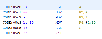

    I dubbed this one "RegCleanup" because its just zeroing things, buts its called every time an ECT table is reset

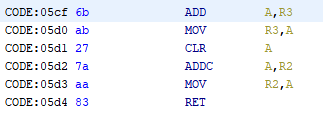

    Then there's this function that's called after the above, and after reading the table value into A. After actually thinking about this, R2 and R3 form a 16-bit number that is initially 0. The ECT ADC is used to address the first table location and that is added to the R2:R3 number. 1 is then added to the ADC number and the code runs again, adding the new table value (if there is one) to R2:R3. This code runs 16 times. After all that, this runs

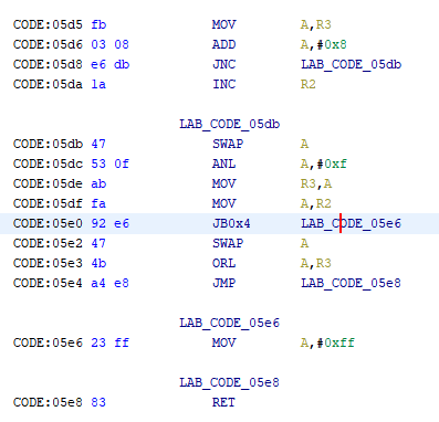

    Ghidra has added too many functions here, its actually just one. If you put any 16-bit number into R2:R3 and work this through, its basically saying +8 to that number, then divide by 16. There is also checking to ensure there is no overflow. Combine that with what is written above and you have linear interpolation! This would be far easier if the CPU had hardware divide.
    So in principle what this does is that if your ECT is just at the very bottom of one of the table locations, that location will be added to itself 16 times, then divided by 16, effectively leaving you with the table value again (+8 is in there still). But, if your ECT was halfway between two table values, it would add 8 of the lower value, and then add 8 of the upper one, averaging in the middle.

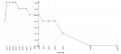

    Knowing all this, and having a graph from VW about the temperature to resistance values you can get...
    There are lots of these maps, and they overlap somewhat, so I'm now working on how the ECU selects which map to look at. The extreme temperatures are theoretically accessible, but with the sensor either shorted or unplugged
