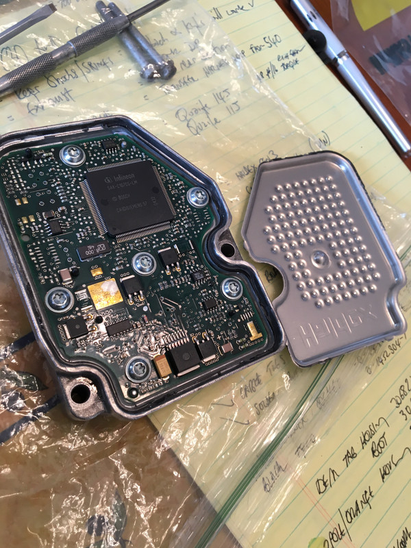

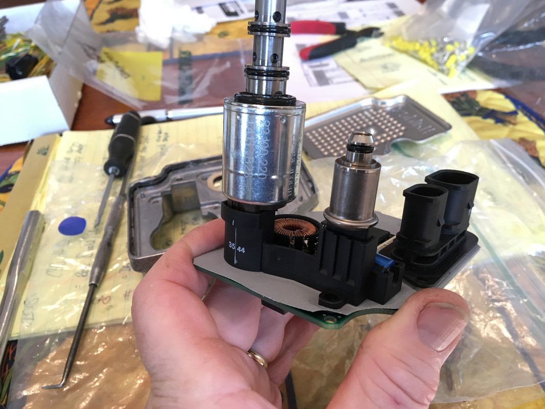

    Now you have access, do you understand the schematic in terms of the resistors? That would need a separate board, (placed inside the gutted Haldex for practical purposes?) to govern, no? I have zero experience with Ardiunos/controllers of this nature however I can build anything if given directions [:D]
    I'm not sure if the Volvo application Haldex even has one (a thermistor) - I'll be gutting my stock controller to remove the control board, etc. I presume I it will be apparent at that point. Posted pics of my plan in the other thread

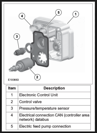

    The dilemma I now have is I finally took my DEM out, and I don't have a stepper motor like anything pictured here. Mine (Gen II) has a "clutch control valve" (2 terminal) and a pressure/temp sensor (4 terminal). I don't see how I can make use of this setup to control it :(

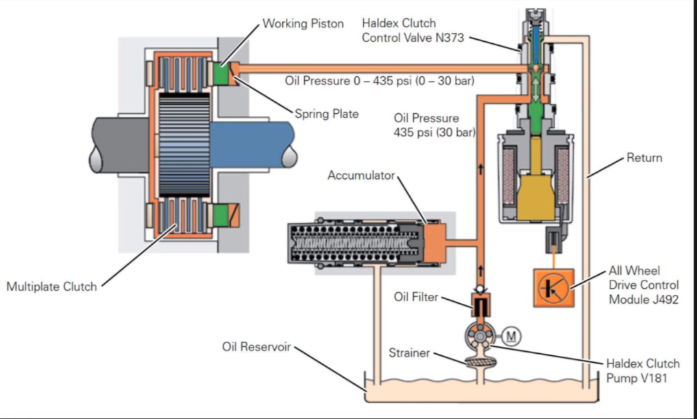

    Has anyone gotten a controller for the gen 2 haldex working? I have been doing a lot of research and attempting to take on the project myself. It seems like the coding is easier to control the solenoid vs stepper motor. It could also be done without an Arduino but I like having the LCD readout and trimpot for control.
    My current dilemma are: PWM control or not, holding the motor current/position, Relay board or Transistor, compensating for an increase in coil resistance as the unit gets hot?
    If anyone has specs on this n373 valve; would help a lot.

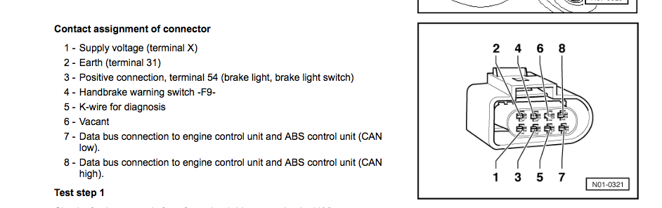

    As I understood, this controller is being used instead of OEM, so I need to remove the stock board from the Haldex ECU and install this one? And I also need to make a new wiring harness and mount it through the car somehow, because the OEM harness does not fit, right?
    yes you replace the oem control board, you dont technically have to make a new harness you can re-use the old one just rewire either end to suit your project. if you're crafty you can probably install the driver inside the hadex case and solder wires to the inside of the pins then the haldex connector will plug back in and you just change the other end so it wires up to the arduino board
