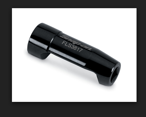

    I have been looking at the VAG 3379 rear shock tool.
    My present stuff is fine for MK2s, but won't fit into the bore of MK4 top mounts.
    In real terms VAG 3379 is a 17mm diesel injector socket. I have looked at lots of websites that sell them but most are cheap and nasty: Laser, Sealey, etc..
    This Snap-On one is by far the prettiest, but I don't do Snap-On as the only Snap-On tool I ever bought, back in 1971, snapped (they should be called Snap-Off) and I dislocated my right thumb. It was fecking excruciatingly painful when I popped it back, and hurt for weeks afterwards. Quite a shock to see your thumb pointing backwards up your arm!
    So, it looks like an ebay search for an old school, made in Sheffield, Britool long hex. socket and a lot of grinding!;)

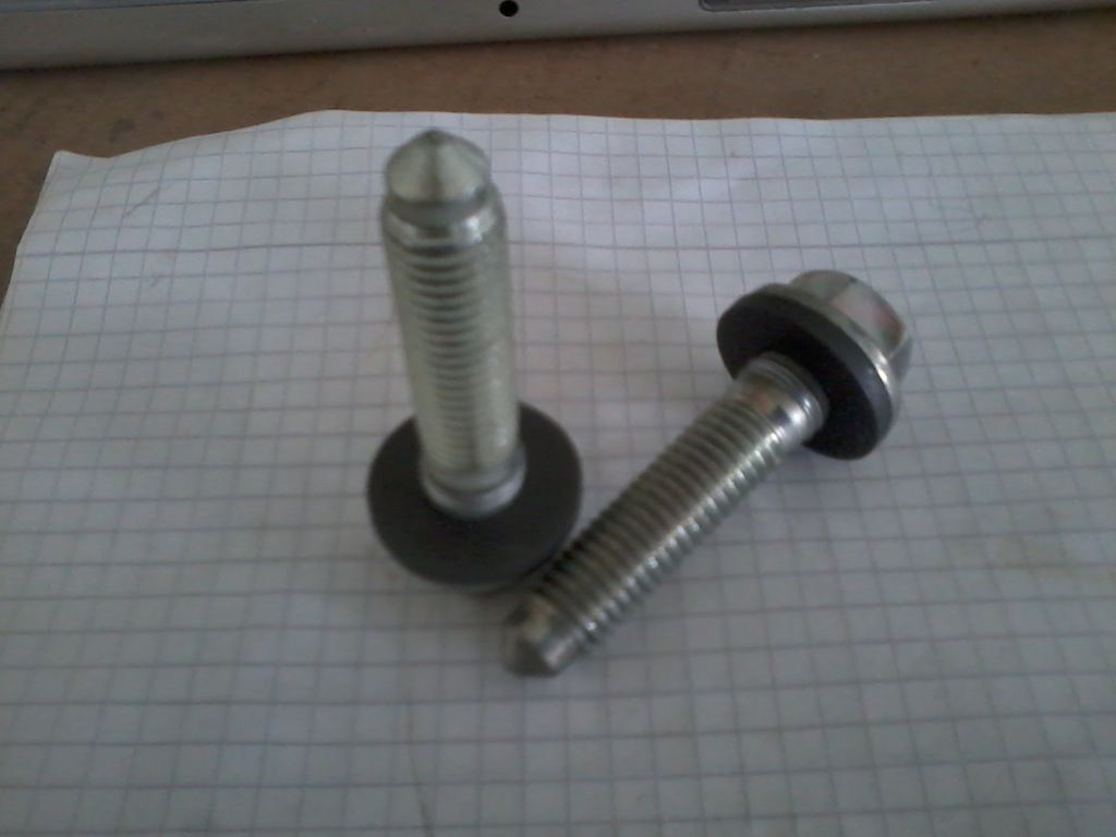

    Not quite what we expected!
    BUT. Better.
    Almost as good as the AUDI CV bolt below.
    Note: Hardened Washer.
    Modified to do the job.
    SACHS say 35 Nm which makes sense. Sort of M8 level as opposed to M12.
