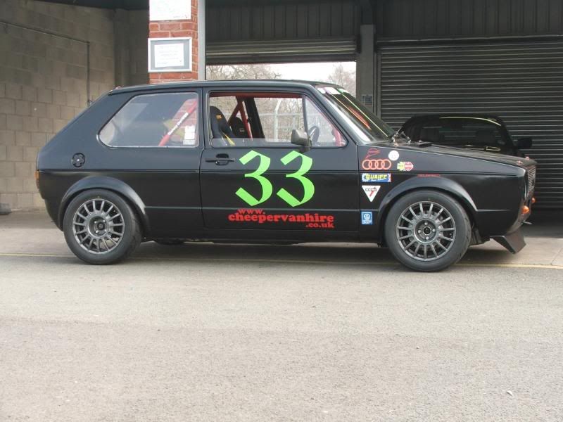

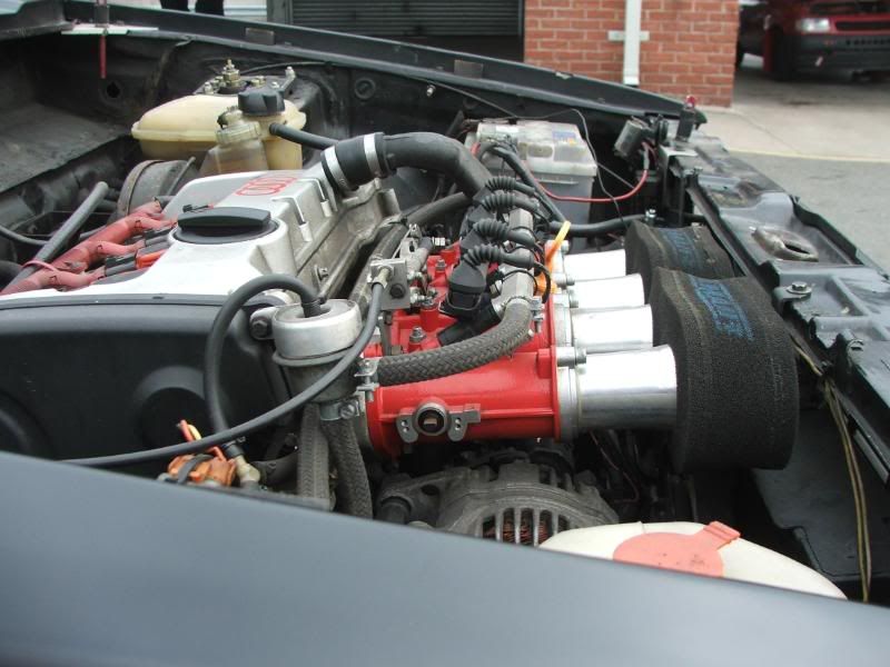

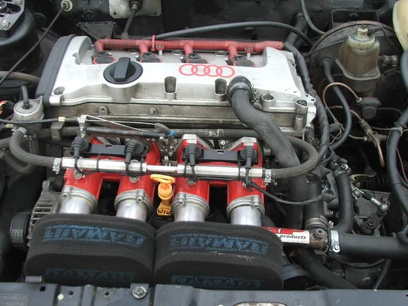

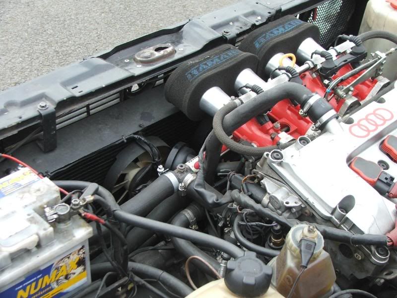

    Which is the one Adrian/20vkid has in this black Mk1? Is this motor some rarity? I know it's alloy blocked.
    AFAIK he 'just' bolted it in, stuck on the TBs and added cams & 4-branch - but maybe that's a simpilification! 190+ bhp IIRC poss more. Brooky? Certainly a rockin' track day toy, makes a great noise and and I know he's had loads of fun with it.

    That is using a 20v to weber sidedraught carb style inlet manifold similar to the one below. It may have just had flanges welded onto the ADR inlet stubs though.
    Those are TBs that use the weber style flange (lumenition perhaps?)
    Alloy block could be AKL but that would need a crank change to 1.8. Being 06A they are long nose cranks for the oilpump chain drive.

    188bhp it is, standard 20v nasp with a set of cams , tb's and Haltech ECU i think Benny will know better than me :thumbup:
