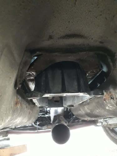

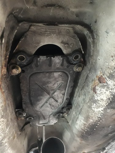

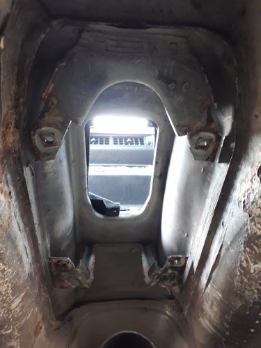

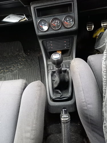

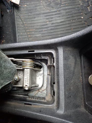

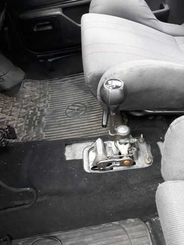

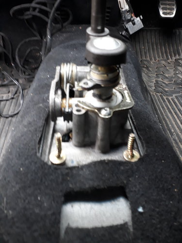

    heres pics of my polo shifter install, the bent studs at the back are just to line up with the mk2 centre console slots. Note kinked stick, thats from an Audi TT and has the correct M12x1.5 thread for MK2 gearknob already, I also find the kink lines it up nicely to MK2 position also but this is personal preference
    20200926_153006.jpg 20200928_135032.jpg 20200930_130138.jpg 20200930_141903.jpg 20200930_141909.jpg 20201118_120442.jpg 20201118_120521.jpg
    tomasson and Blauswartz 16v like this.

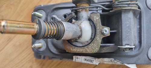

    Picked this up today
    1JO 711 565
    Picked up this today
    1J0 711 565
    Was told its from a 2002 Ibiza tdi.
    Can anyone confirm part number is correct?
