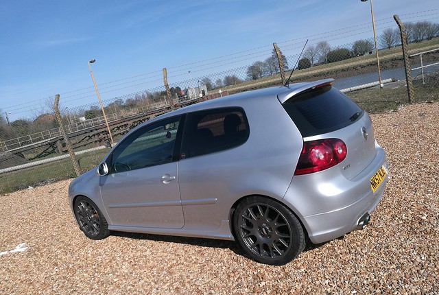

    Picked up this low mileage (66k) Edition 30 at the end of Jan.

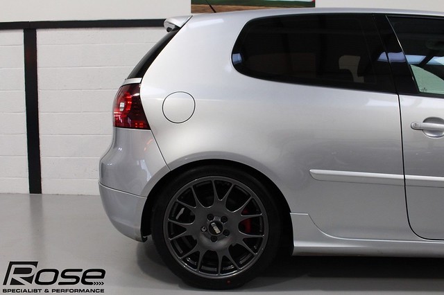

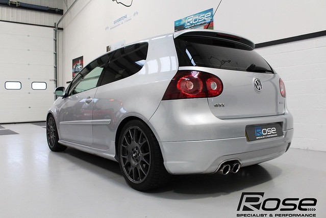

    Wheels have been refurbished Anthracite, Eibach springs and Milltek cat-back resonated exhaust are the only mods.
    Will be getting it remapped at some point, these K04 cars can be tuned to ~300ps pretty easily.

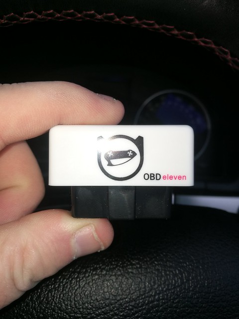

    In case I need to do any diagnostics - My cheapy ebay Vag-Com (VCDS) cable which has served me well on previous cars - only works on the pre-CAN VAG stuff, and be buggered if I'm paying £225 for the pukka thing.
    Saw this handy tool for VAG stuff, that's been out about a year or so now called OBDeleven, it's a dongle that plugs into your OBD socket and uses Android device for the app. https://obdeleven.com/en/ £66 from Lithuania on eBay for the Pro version, you can get a cheaper one that has less features.

    Since buying the car in Jan every so often I had the ABS,ESP & TPMS lights coming on. Scanned for faults with OBDeleven, coming up rear wheel speed sensors mechanical faults both sides.
    3 month used car warranty doesn't cover ABS sensors, so decided to change both rear sensors and rear hubs (the magnetic pick up ring is part of the hub bearing assembly)
    Could see where rust on the hub had built up and both rear sensors the ends were damaged. Cleared codes with OBDeleven and no more lights on.

    does your obd thingy allow you to retract the rear brake caliper pistons to change pads?
  14. GVK
    Not sure Rob, worth a question on the OBDeleven forum?
    Edit - Looks like it's in Basic settings mate. Golf mk7 here
    Pretty handy tool for £60. Needs Android device though, no IOS support as yet.

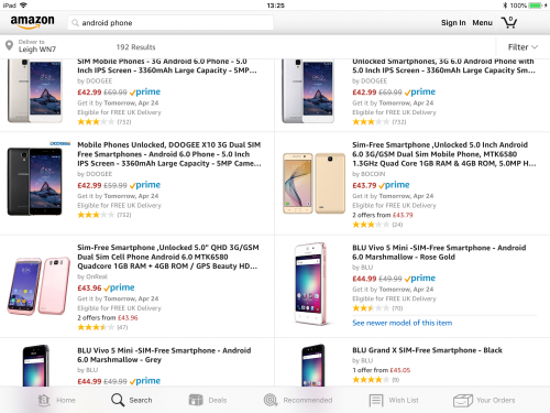

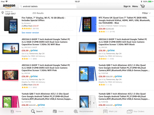

  18. Sirguydo
    Nov 7, 2012
    1,206
    Bolton
    It’s worth buying an android tablet or phone for that .
    Very quick search
  19. GVK
    True Mike still works out cheaper than VCDS for a home user.
    It uses wi-fi/mobile data for the information so you'd need a sim deal or something on your mobile device.
