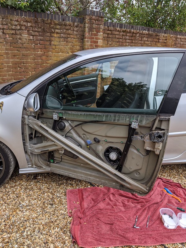

    Been putting off getting this sorted but today was the day I got on with it and fitted my passenger door lock. As some of you will know on a mk5 Golf you don't work on the inside of the door with the inner door card off , you have to take the door skin off the car!
    [​IMG]Door by GVKmotorsport, on Flickr
    All well and good but my door was deadlocked shut and the motor was just bouncing between unlocking and locking, must have taken about hour and a half of banging the door, pressing the unlock button and pulling the inner handle to try and pop it open. Eventually I was going to give up and tried it one last time and it popped open... result!
    Once the door was open and the door skin off you have quite a bit of room to work on the latch. Couple of tips that were useful I got from Humble mechanic's vid on You tube was to turn the TX20 on the door handle 12 times to release the door lock/blank and to set the tension of the handle by putting the spring on the lever inside.
    All sorted.
