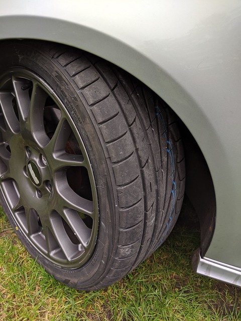

    New tyre day. Trying out the new Toyo TR1.. Reasonably priced @ £120 a pair from Demon Tweeks, Ta to the local Bush tyres for fitting.
    Much thicker sidewalls than the Uniroyal Rainsport 3s that were on there.
