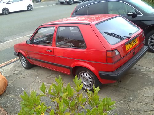

    Eight weeks in already and time to start a thread.
    As my son was getting to the point where he was driving my run around more than I was I decided it was time for him to have his own car and start learning about car maintenance. When asked, he consistently said his favourite car was a mark 2 Golf. Of course he meant a GTi but with it being his first insurance and only 22 that want going to happen. I had been watching the classifieds for some time so knew what the going rate was for a running MOT'd in reasonable order.
    As it happened I had been watching this car on eBay for a while and so while I was up north dropping number one daughter at Uni I took the opportunity to go and have a look. A chat with the knowledgeable owner (MK2 GTi in the garage and another on the drive) and good look round lead to a test drive, a haggle and a deposit paid!
    A week later and a150 mile round trip and the car was home.
    No dramas on the way home.

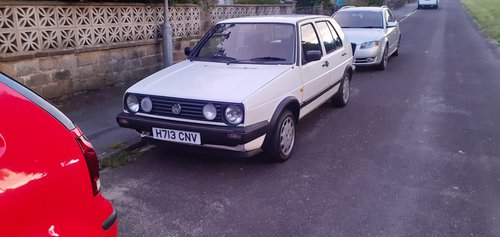

    The driver is what our white one is, gti look, but less powerful, the green one is a cl, no arches and just small slats on the rear arch, nice to trap water and hide rust.
    Not sure green pic has spat in it, they are a little like xr3 had, but not as fancy.
    Edit, picture of CL spats added, went in shed, fitted full arches on the car.

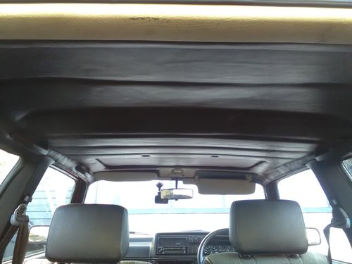

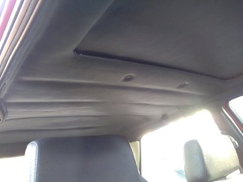

    Restored headliner in and looking lovely (even if I do say so myself)

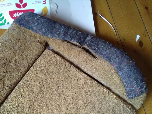

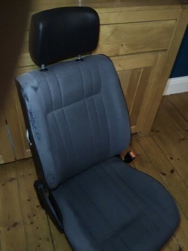

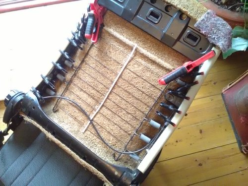

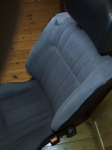

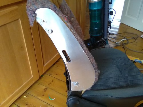

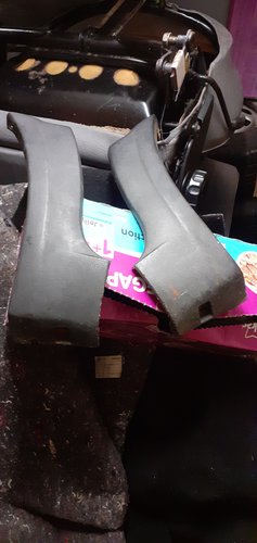

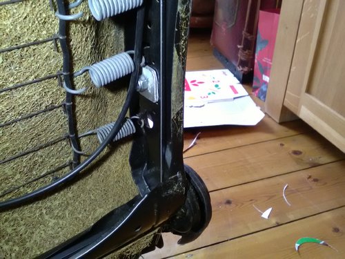

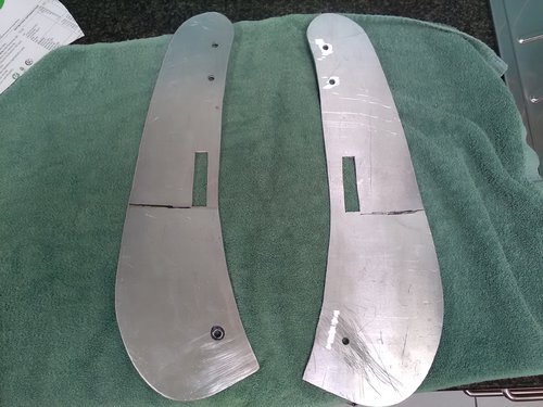

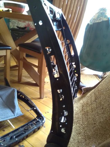

    Today I was tempted to replace my rear drums, brakes and bearings but I was a little concerned it may chuck it down half way through the job and then I'd be stuck with a car on axle stands in six inches of show tomorrow. So I decided to tackle the front driver seat. Until now it's been like driving on the frame, uncomfortable and almost dangerous
    . I mooted somewhere else on here about bolstering the sides with aluminium plate to support the "horsehair".
    I got a spare seat from Dodgy (thank you) and having taken that apart found that the horsehair was much better than mine. Mine was shot! I hate to throw things away but this could not be saved in any way.
    So now it's in the dustbin.
    Next was to draw a template and cut out the bolsters from 4mm aluminium plate. They had to be bent a little to match the shape of the seat.
    Then find the most suitable holes on the sides of the seat to attach the bolsters. I drilled matching holes in the bolsters for the top two and the large two centimetre hole near the bottom.
    Filed and sanded to smooth off all the edges of the bolsters. Found some suitable nuts and bolts and fixed the bolsters on (there were some trial fittings of course and several trips to and from the shed).
    I made a couple of large washers from spare aluminium to cover the 2cm holes. These holes allow for plenty of room to position properly.
    As the bolts did up tight the bolsters pulled round and trapped the horsehair in place. It worked really really well.
    Glued the rear trims back on.
    Washed the cover and tried to repair some holes. I really really need a new set of covers. Does anyone make them?
    It has worked very well. It is like sitting in a bucket seat now (the back at least). Very pleased.

  17. PhilRyder
    Seat back in the car now. Awaits test drive.

  18. PhilRyder
    Update on seat. Far more comfortable and feels very supportive. The "wings" will need trimming back a little as the horse hair settles as otherwise they will protrude in front of it and wear what's left of the covers. It will be easy enough to take them off and do that. Overall, very happy.

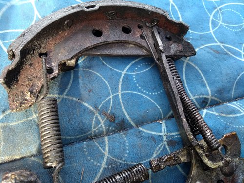

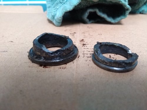

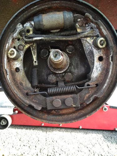

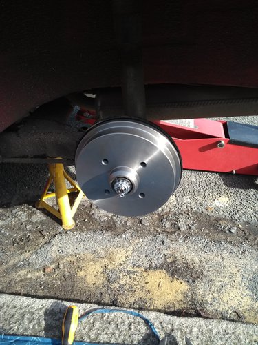

    First was the rear brakes, bearings and drums. At the MOT it was highlighted that the rear offside bearing was worn - more on that in a minute. Also, at least one wheel bolt hole was threaded and I wasn't keen on driving around with only three bolts.
    So, off with the old. Oh my goodness me, what a mess. Lot's of muck and dirt AND! bent bits! How does that part get bent like that?
    Dismantled and straightened up the bent rod and refitted. Now for the other side.
    OMG! Even worse. At this point I actually put rubber gloves on.
    The same bar is bent so that had to be straightened. The bearing fell apart and was actually shattered. I had to Dremel the race off the spindle.
    All cleaned up and put back together.

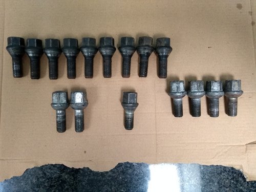

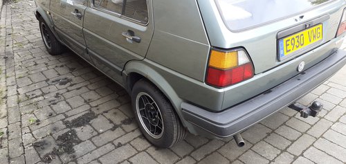

    Pop quiz - how many different wheels bolts can you get on the same car? Answer - four [8-}]
    All replaced with nice shiny new ones. No picture I'm afraid but you know what wheel bolts look like ;)

    cone taper ones are BMW, ideal for aftermarket/BMW wheels so I guess it had those at one point. VW wheels need the ball seat type. I bet the bent bit in the drum was down to using wheel bolts that were too long for the steel wheels
