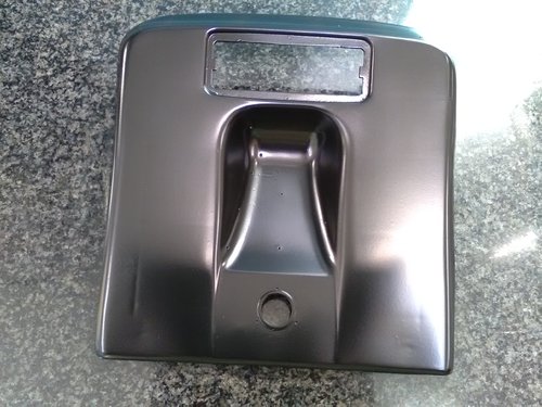

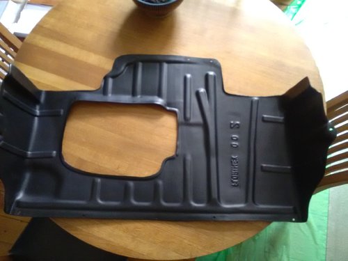

    This arrived today. May not get fitted for a couple of weeks as I'm laying new flooring in the house and SWIMBO might get grumpy if I am diverted from that before it's finished [:[] It's amazing how much water gets sloshed around the engine bay when it's raining. I've regularly seen water on top of the air filter and that can't be good.
  3. Tristan
    I've one of those, needed an extra brace for the front to atta to, but nothing difficult.
  4. dodgy
    Fitted one on the green one, took 5 minutes after I found some big screws.
    Could just say you off to get a tool that you think may have dropped under the golf and have to jack it up to get to it? Sneaky

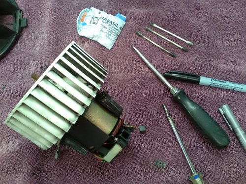

    Today I took the blower fan out and gave it a clean and greased the brushes. I can't really tell the difference at the moment but it was an easy job so not a waste of time.
    Engine undertray has also been fitted but needs some additional support fittings as it's not quite long enough front to back to line up with the holes in the bodywork. Pictures when it's properly finished.

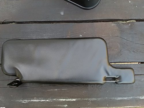

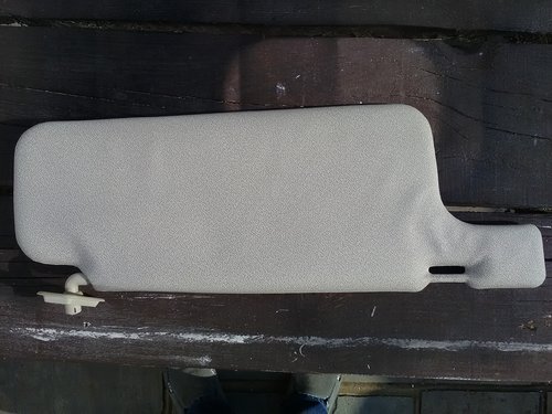

    Took advantage of the sunny weather and sprayed the sun visors to match the headliner.
    Came out much better than I expected. Used this stuff.

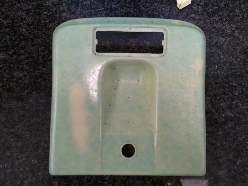

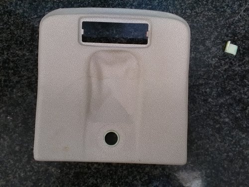

    I decided that since the vinyl had shrunk on the sunroof winder surround, which seems to be a common problem, I would remove it.
    The plastic underneath is nice and smooth. There are very small holes which I think must have been to allow the air out when pressing the vinyl into place. The glue used is blue but came off easily with thinners.
    A light sanding, primed with plastic primer and then satin black.
    Pretty pleased with the result. Sun visor retaining clips (although new black ones might be better to prevent chipping of the paint) and the large rear pillar covers left to do. Need some more paint first though [:D]

    I have also replaced the blower fan. I took the old one out and gave it a clean and checked the contacts but it still squealed so new one ordered and fitted. Five minute job but now there is a gale rather than an asthmatic puff.

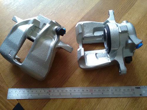

    These are big heavy buggers. Definitely going to need a bigger engine to haul these around! I don't think I've seen pistons quite as big before either......
  15. dodgy
    When I fitted mine there was a tiny bit of rub from the disc to inner caliper bridging between the pads sounded awful, but a quick couple of passes with a file sorted it, was ok when cold, just a small bit of expansion after using the brakes and it started.

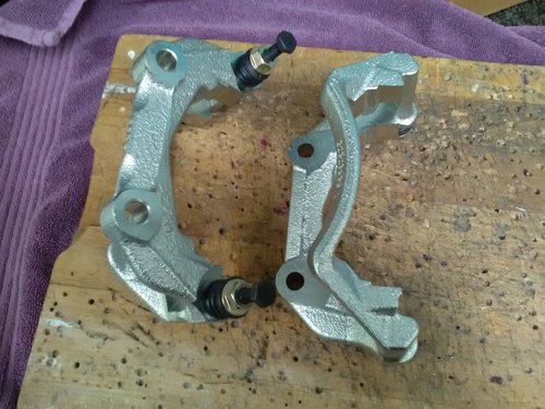

    More bits have arrived.

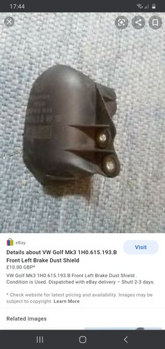

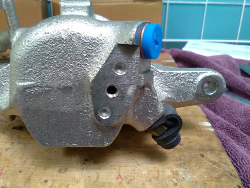

    What's this hole for?

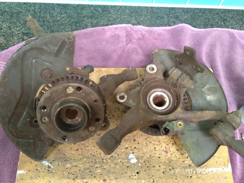

    Also, it seems the carrier does not clear the ABS ring, is this right? It doesn't matter as I'll take them off but just want to be sure.
    Also 2, what size are the caliper carrier to bearing carrier bolts? I need to order those.
    Also 3, will the existing brake hose reach or do I need different?
    Also 4, the bearing carriers have the lower ball joints attached. Are they the right size or do I need different?
  17. dodgy
    Hole is for a plastic shield/duct to be mounted from memory, that tdi mk3 had them on in scrapyard last Friday.
    My carriers cleared abs ring, but you could un bolt it possibly when doing bearings, as believe your car is non ABS?
    I fitted new balljoints when did hubs, as I had them on the mk3 wishbone set (new) so just unbolted and fitted to my mk2, not sure if there are earlier and late sizes on the balljoint, mk3 were fine on my late mk2, may be the taper on them, but I'm not 100%.

    I had some 16v calipers that had a bracket that bolts on there for a short brake pipe that fitted between the caliper and brake hose.
  19. PhilRyder
    I thought it might be open to the fluid in the caliper but I've had a look and I don't think so. I've filled the hole with oil to see if it drains away.
    I think I read elsewhere that the later/MK3 ball joint is bigger.
