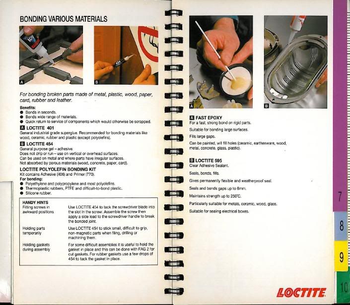

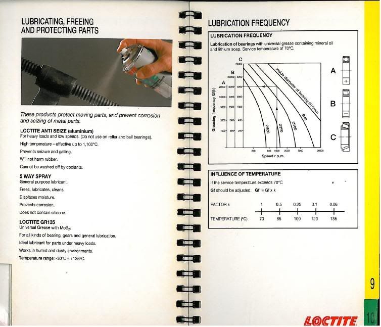

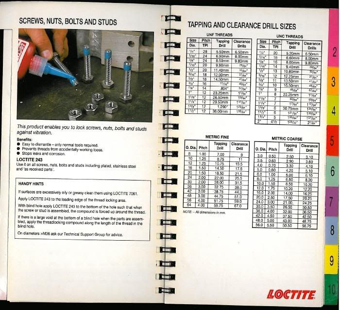

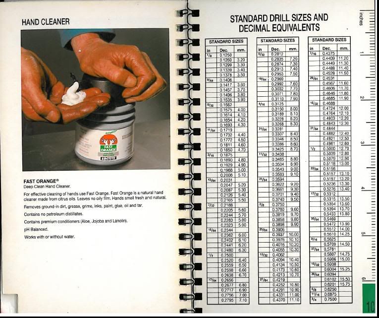

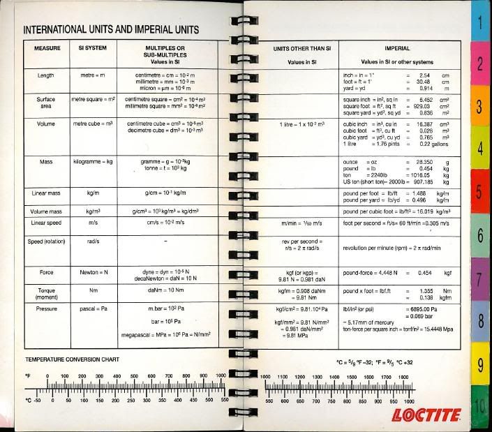

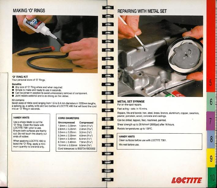

    Found an interesting Loctite summary in an old TRC magazine, written by Andy Dawson, who is ex-WRC / an engineer.
    All versions already mentioned in this thread underlined in red. I think the first one is meant to read '242'? Edit: no, saw it somewhere else so ignore that: it's right.

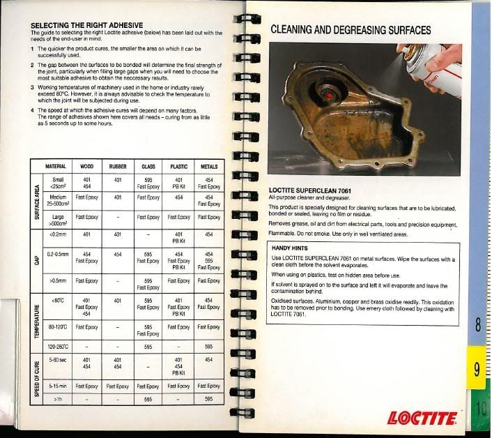

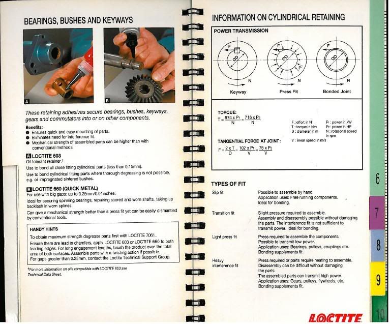

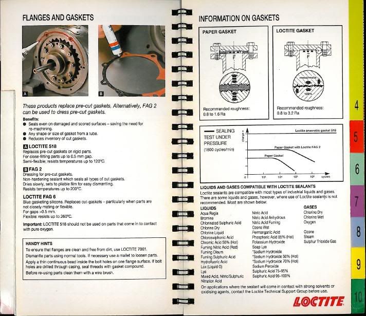

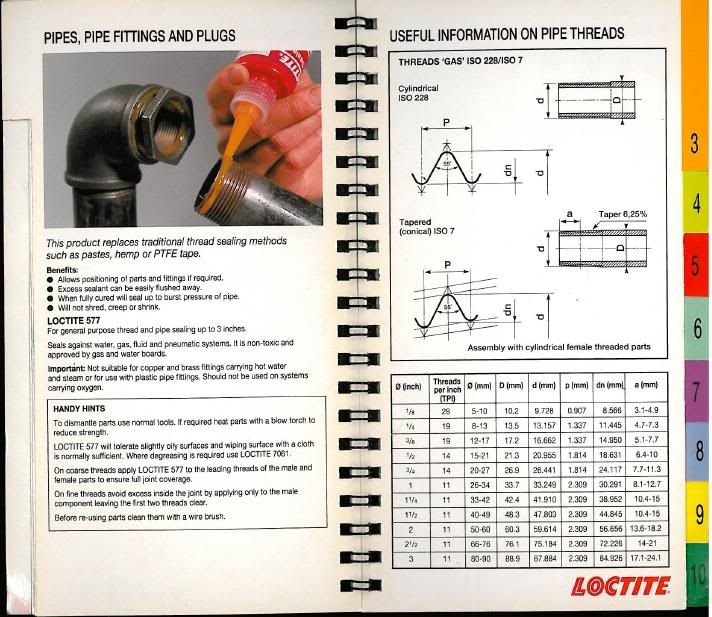

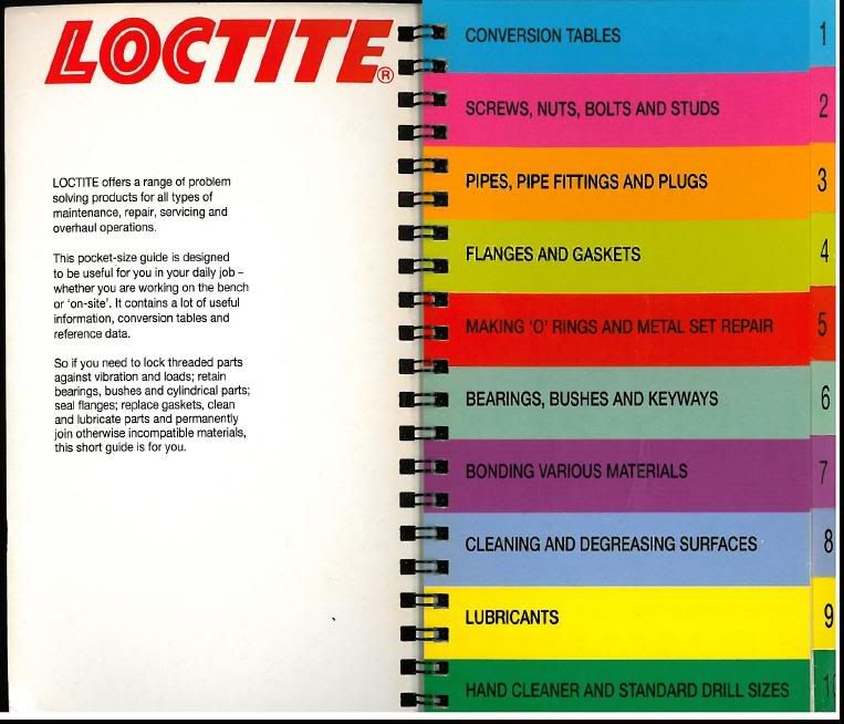

    Something I found the other day at work, might be of use- probably not though!
    Although 243 is listed as 'Medium' we use it for our dyno torque hubs at work- 1100Nm+ and alot of stresses when motoring etc - it does the job just fine, also operating at the higher limits of it's temperature range. I'll be using this for my wheel studs :) unless I can find some 270 knocking about.
  7. A.N. Other Banned after significant club disruption Dec 5th 2
    Useful addition, defintely - broadens what we'd already got: 577 and 603 mentioned in the 'motorsport' TRC-originated table above, and 660 worthy of note + all the adhesives listed.
    I'd not recommend 243 for studs, from experience. It might be ok for work, if it's dismantled often. 270 minimum.
