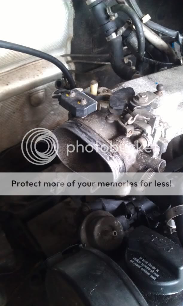

    main thing does it have a lambda? if so then its not quite the same. if you get it all from donor though you should be able to get it going. make sure it uses maf, isv and idle switches rather than a tps. if it uses a tps see if the tb looks like it'll fit a mk2 inlet (i.e. its a rectangle shape not square!)
  14. nayhorn Forum Member
    Mar 4, 2007

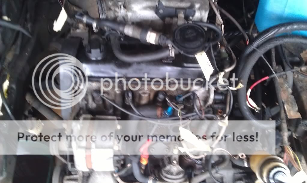

    Right just been round to the garage and taken some photos.
    Engine -
    Throttle body -

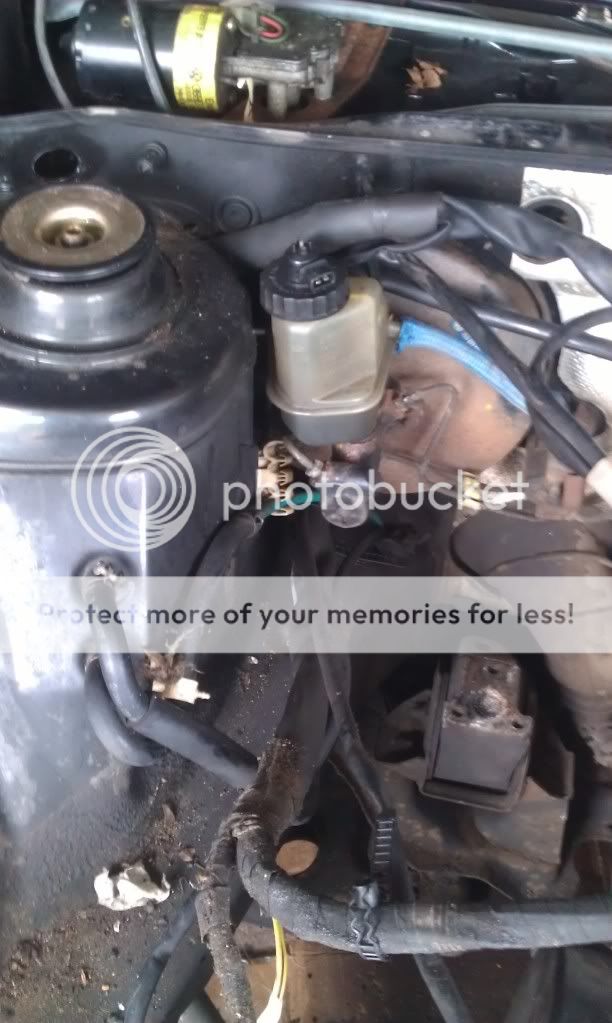

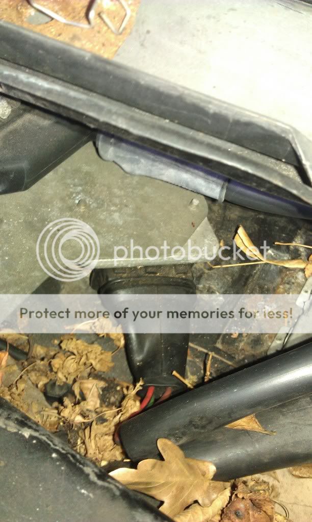

    And is this the plug that your on about for disconnecting the wiring?

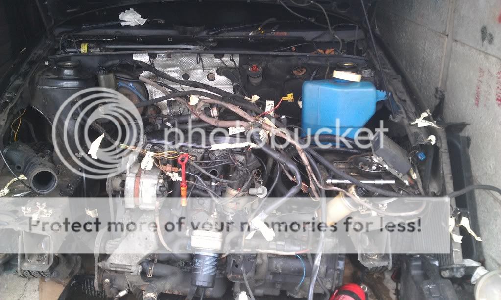

    Right bit of an update stripped the wiring and then got to this stage
    Then followed all the wiring back and it all went to one point
    Is this now where i need to take it out from inside the car? or is there something I'm missing?
    Nathan
  16. rubjonny
    3,632
    looks liek its different in a passat then in a mk2 golf there is a 5 pin plug next to the ecu where you can split the ecu part of the loom from the bay part of the loom. looks like on passat you have to pull the whole loom out together so more of pain in the rear.
    the engine looks like its a pb though seems throttle has the idle and wot switch setup plus it has an isv

    I think there might be I'll get some more pictures tomorrow. Is it just like 5 single different coloured wires going into and then out of the plug?
