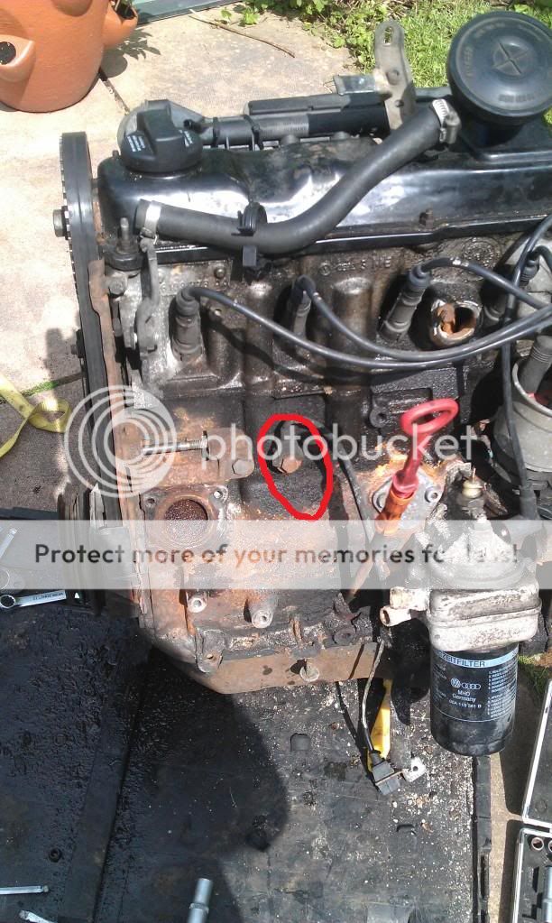

    and also stripping the new engine down today and noticed this sensor is looking fairly tatty, is it worth replacing? and what is it?

    Knock sensor. Won't run right if it's knackered and will be down on power. new one needs to be torqued to correct torque or won't work right.
  5. rubjonny
    as above, 1.8-2.0 8v and 16v knock sensors all work (make sure its the long one if the engine has 2, i.e. abf) for the silicone hose just do a search for 3mm vacuum hose or 3mm silicone hose and you'll find it. just make sure what you get is listed for vacuum application

    the plug near the dizzy is probably for the knock sensor, you took a picture of this and circled it above so follow the plug see where it goes. it'll run without the knock sensor, but not well
