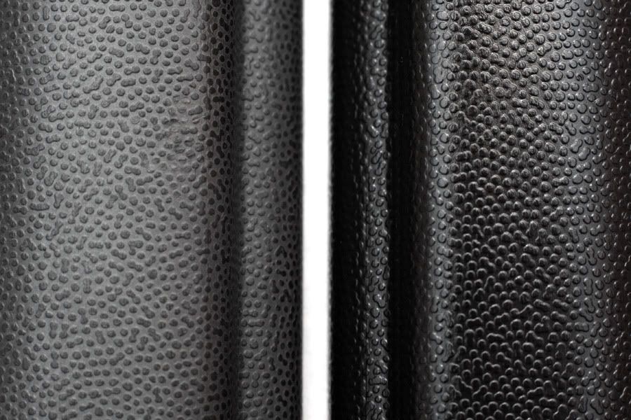

    Great as the shoe dye was on my old faded trim, the plastics on my new motor are in better nick so I thought I'd try something different; rather than effectively adding a new surface finish with the shoe dye.
    I've tried all sorts in the past, but am expecting great things from boiled linseed oil due to recommendations on here and because (unlike traditional treatments and engine oil etc) it sets, which means it shouldn't wash off over time.
    Ive used similar on rifle stocks in the past with great results, so I'm thinking that it might be possible to build up a couple of layers of the stuff over time.
    I tried it out on some trim destined for the 'bay last night, initial impressions are very good (before and after):
    The only thing is it's taking a while to dry - thinking when I put it on the car it'd best be on a still, hot day - don't want it sticky for days or covered in small children and pets like flies on fly paper :lol:

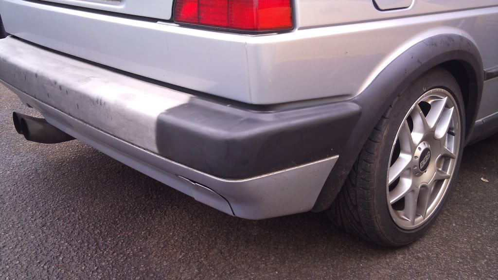

    Sorry for resurrecting this old thread, but I've tried everything to get my bumpers black again (MK2 big bumper). Didn't want to paint them, as I painted the plinth using all the correct prep and plastic primer, etc, and after 2 years sat outside the paint is starting to flake now.
    In desperation I tried a blow-torch (MAPP gas in this case, but I'm sure Butane would work just as well!), and it really works! Didn't get it too close, but the narrow flame is really controllable - it was like spray-painting the bumper with black paint.
    Definitely worth a try if all else fails!

    Tried the hot air gun method today - stunned and a happy chappy

    Apr 27, 2009
    dun the hpt air gun and results were vgood,a little bit uneaven so put linseed oil on as well and the trims look bang on
