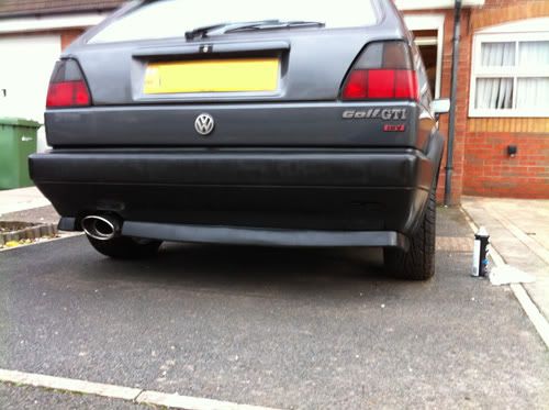

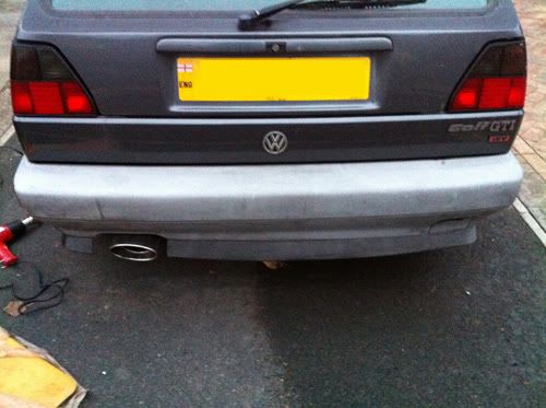

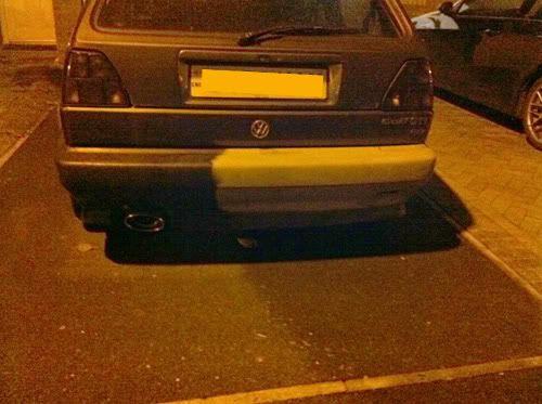

  5. SteveDub New Member
    Dec 12, 2010
    Thought I would add my pics of Bumper Restore using the 'Heat Gun' method...awsome..thanks very much for the tip guys [:D]:thumbup:
