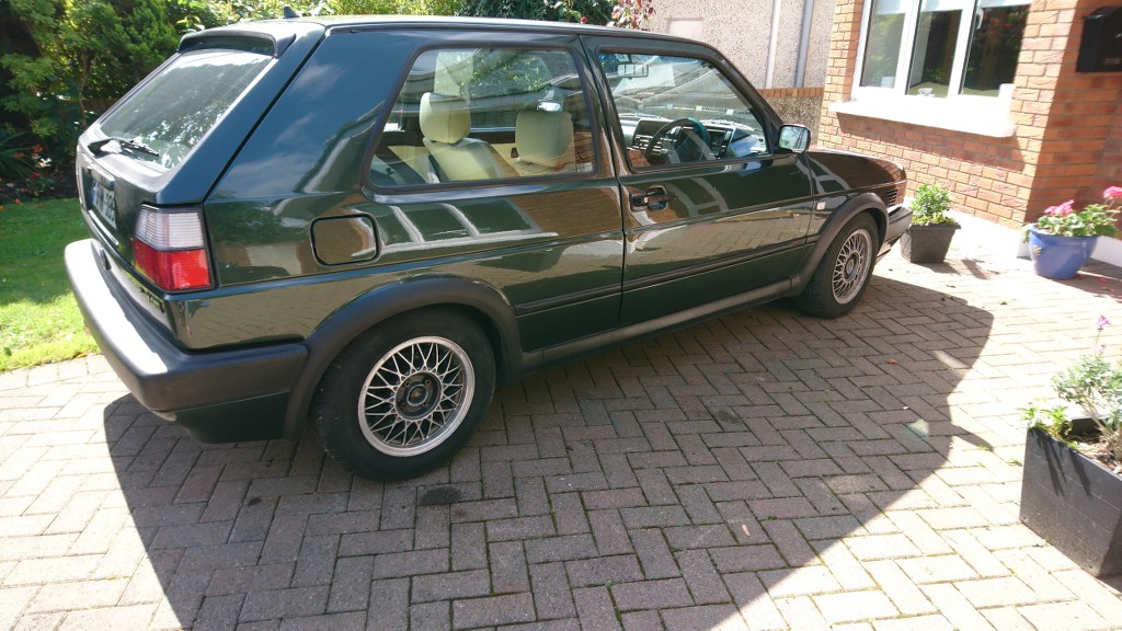

    How it sits now as of 7th September 2020:

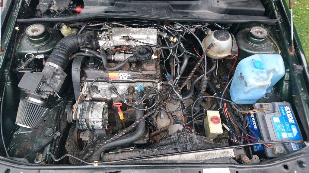

    Removed the k&n cone filter and fit a standard airbox and new filter. If anyone wants this kit let me know. Comes with bracket to hold AFM in place too.
    Fixed the level sensor on the pump. As you can see it looks like the car was sitting up for a while as the pump is very badly corroded.
    Got rid of the single wiper conversion. The wiper arms Retro Spares gave me had a bit of surface rust, so I cleaned them up, primed and painted.
    Tidied up some of the engine loom, although I'm picking a replacement one during the week. The one currently fitted has been out of the car at some stage and domestic insulating tape is all over it....

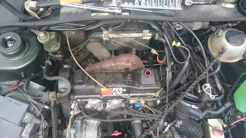

    Bled the system and got the engine up to temperature but the temperature gauge was still reading at 3/4. I refitted the old sender and it reads at 1/4. So I checked the resistance of the blue temp sensor for the ECU and that was reading 80-90*C, so I reckon the old sensor is toast and the new sensor is faulty to begin with. Serves me right picking up an Intermotor one.....

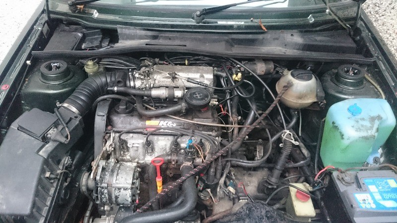

    I took a quick snap of the new loom fitted, it still needs a bit of tidying; cable ties need to be replaced as they had all been cut even though they are the reusable type. I'd love to pull the engine and subframe tidy it all up properly, maybe thats a job for the winter or next year.
    I also had a look at the timing, luckily a friend was on hand to help me keep the engine above 2000 rpm to test. For the life of us we could not find the timing mark on the flywheel when checking for timing. We killed the engine and turned the engine over by hand from the crank pulley but when we found the mark it was way out of alignment with the cam and crank marks?? I thought the flywheel could only be fitted one way?
    Anyway,we used the timing marks on the crank pulley and casing to set the timing then. Although I had nothing to compare how the engine was pulling too, Tristan went for a spin recently and although he said it sounded healthy and pulled well, it was still flat in spots. The timing was set at 4* BTDC, which I was happy about. It meant it was an easy fix for a bit more power. Adjusted the timing to 6* BTDC and took her for a spin. Wow! It pulls like a train now.
    I just need to sort the exhaust leak at the manifold and it will sound as good as it moves.

    So I took a spin down to Halfords to pick up some H4 bulbs. These Bosch ones are advertised as 18 but 7.50 with the trade card.
    When I was changing the bulb though I noticed the front cross member was all wet.....
    At first I thought it was the water pump but on closer inspection it turns out the radiator is weeping from where the plastic end tanks mate to the aluminium core. A crappy picture but you can see where it has been weeping for a while. Looks like I need a new rad and that the new temperature sensor is in fact working correctly. The car must be climbing in temperature due to the loss in system pressure. Anyway on the hunt for a rad I go. :(
    Supplied and fitted in 1991 I reckon....
    Definitely seen its day
    Cross member could do with a clean up too, I'll do that when fitting new bushes ;)
    New NRF radiator
    Somebody... also pointed out that my fan was orientated incorrectly, so rotated so the
    plug is at 12 o'clock.
    All fitted rocking and rolling
    Temperature gauge is still dicky though :mad:

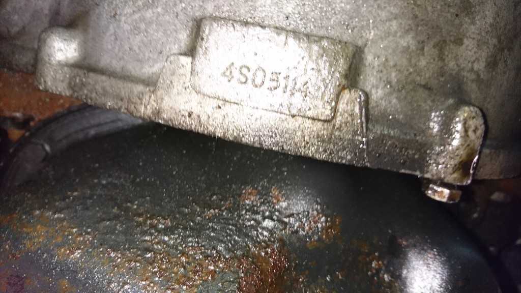

    Nothing mad to report, well except that I discovered there is a 1.6 diesel gearbox fitted to the car.....
    So another item to add to the list of things that need to be replaced for standard items.

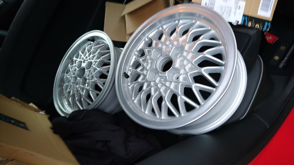

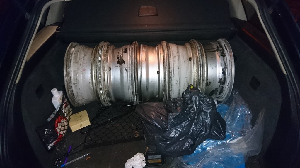

    A friend was nice enough to lend me a set of 14" rims so that I could sell on the 17" ones that were on the car. It looks so much better with the smaller wheels on it. I have 15" RA's bought, I just need to collect them and give them a quick DIY refurb.
    Unfortunately I havent had a chance to test out the comfort of the smaller wheels and bigger tyres as my fuel pump seized after I ran out of fuel last week. I finally got to removing the supply pump and reservoir last night. It sounded like a box of smarties when removed, there was so much debris inside the reservoir.

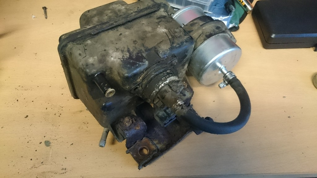

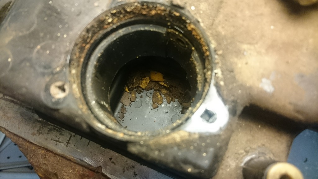

    When I removed the pump from it this is what I found :shock:
    I managed to clean out the pump and give it -12v and it came free, so a nice quick fix. Ill strip the rusty bracket off the reservoir tonight, clean it up and give it a fresh lick of paint before refitting.

    So a lot has happened since my last post, I just haven't had time to post updates here on the forum.
    I got the pump and reservoir cleaned out and it has been good ever since.

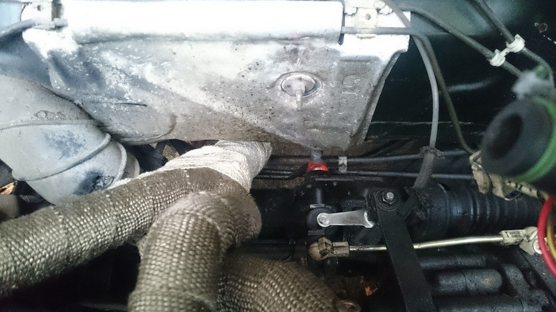

    I then start focusing on the exhaust leak I had.

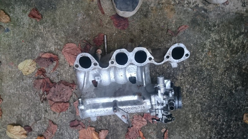

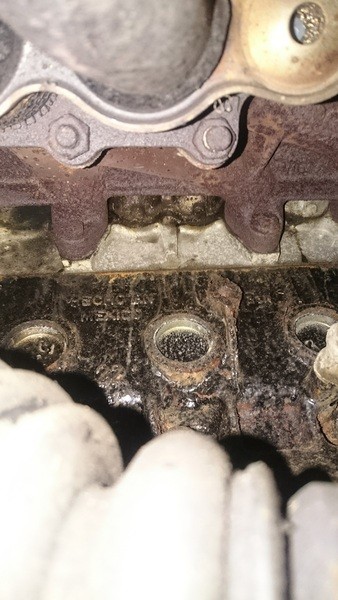

    Intake manifold out

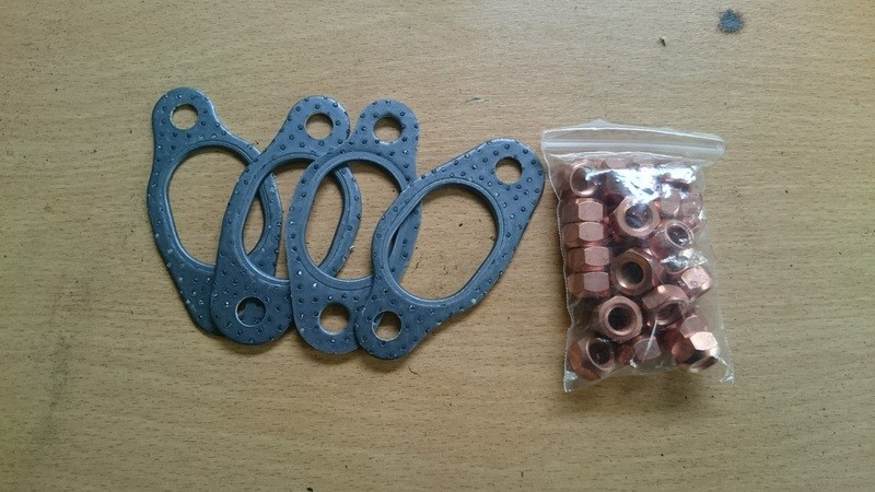

    I have a full system to fit so out came the standard manifold and a stainless one was installed with heat wrap for good measure. The manifold is from a different brand than the rest of the system I have so I will have to get a small piece made up to join the manifold to the front silencer.

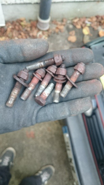

    Old hardware removed, studs came out with the nuts as usual
    New nuts and gaskets

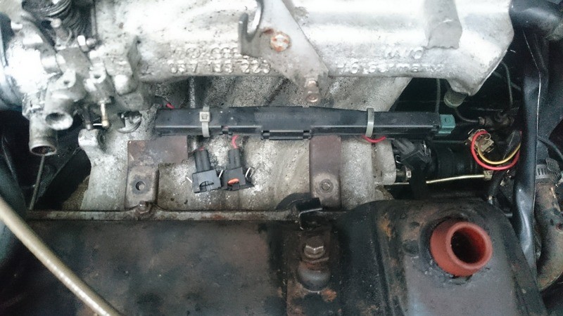

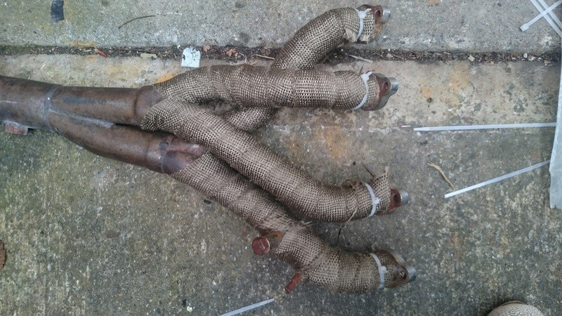

    Replacement injector harness with cover, mine was cracked and broken in places so Tristan came to the rescue here
    Getting wrapped
    And fitted
    All back together
    I've still to fit the rest of the system and still have to remove the scorpion exhaust system that is currently fitted.

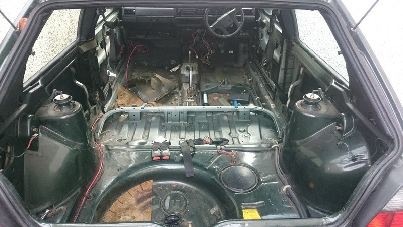

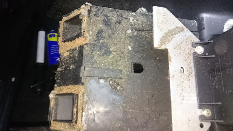

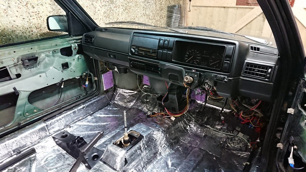

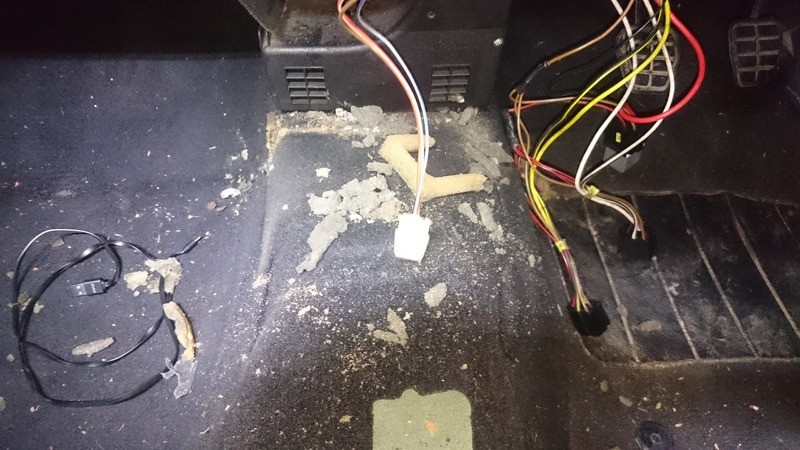

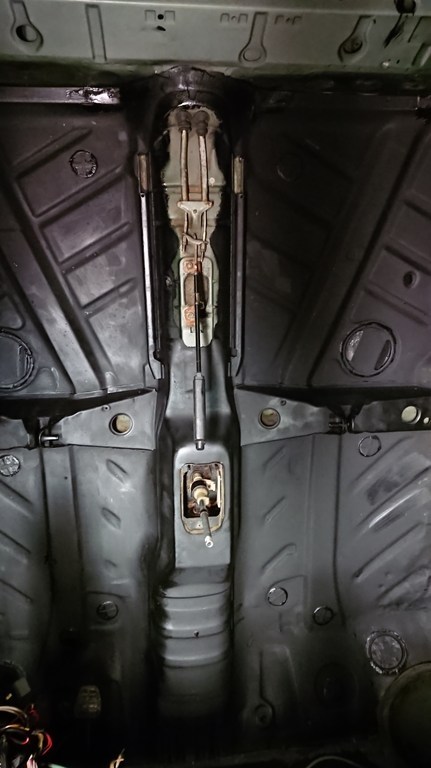

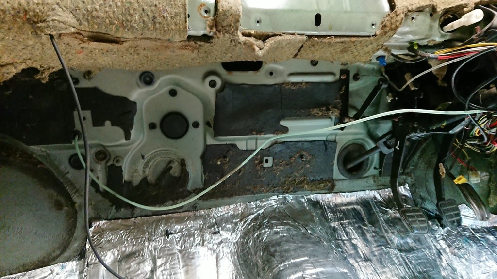

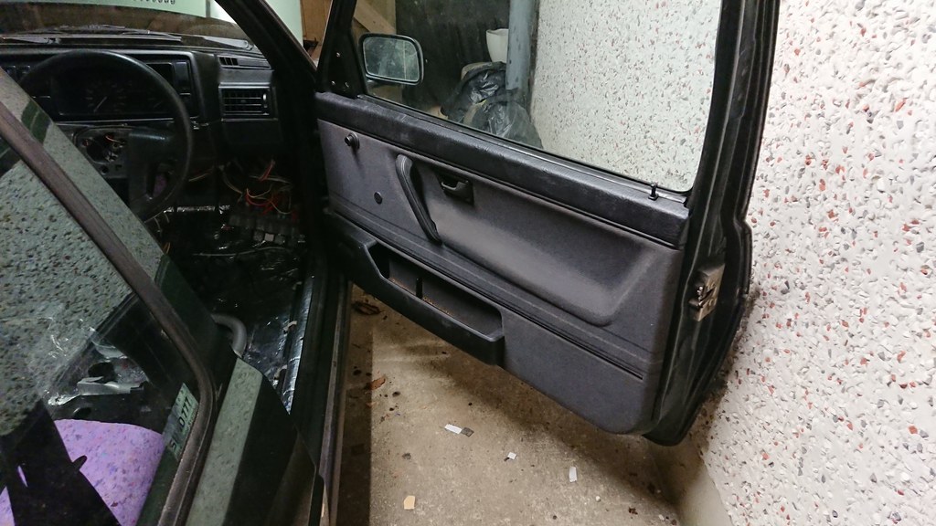

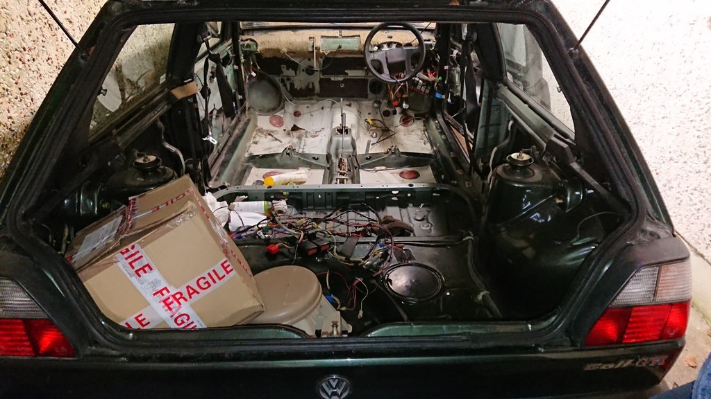

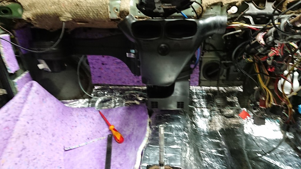

    The cream leather interior sold soon after this so I took the oportunity to remove the carpets to give them a good clean and tidy up the wiring behind the dash. Things escalated from there and the whole dash came out to allow me to tidy the wiring as best I can and to replace the heater core.
    Start of carpet removal
    Crude that fell down from behind the dash
    Most of the underlay was broken and falling apart so out it came
    Carpet removed

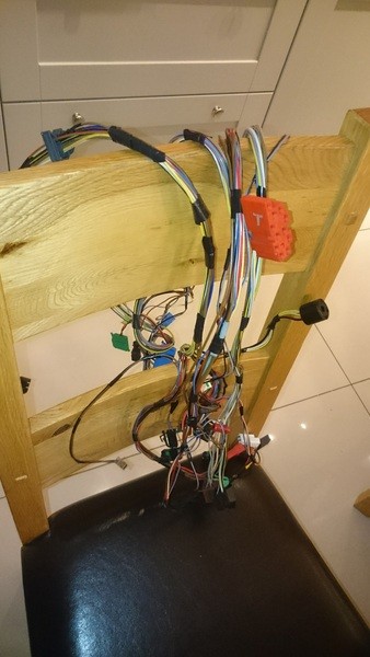

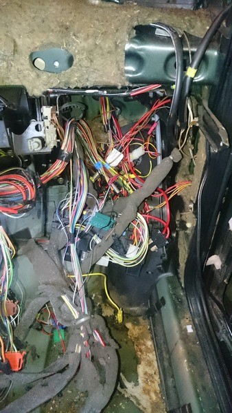

    The dash was removed then and this is the mess that the PO has left behind
    Out with the interior looms and tidied them up

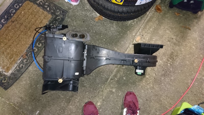

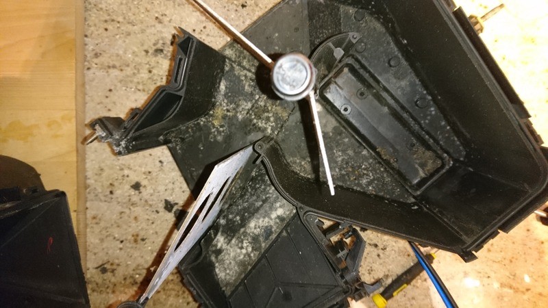

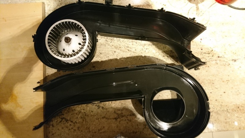

    Removed the blower motor and heater matrix
    Its all cleaned up now. I just have to pick up some sticky fabric pads to place on the flaps and then put it all back together.

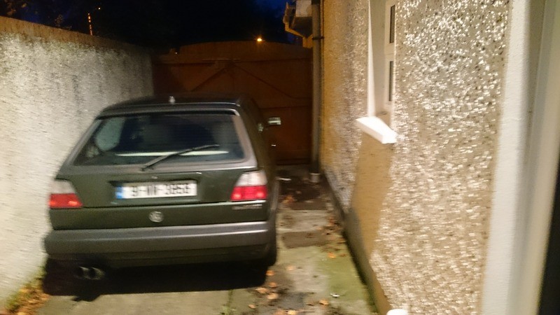

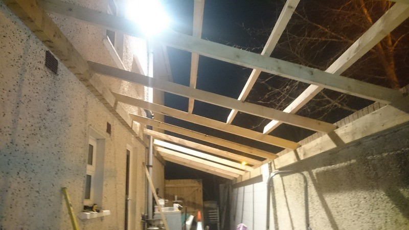

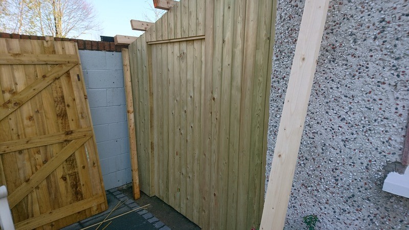

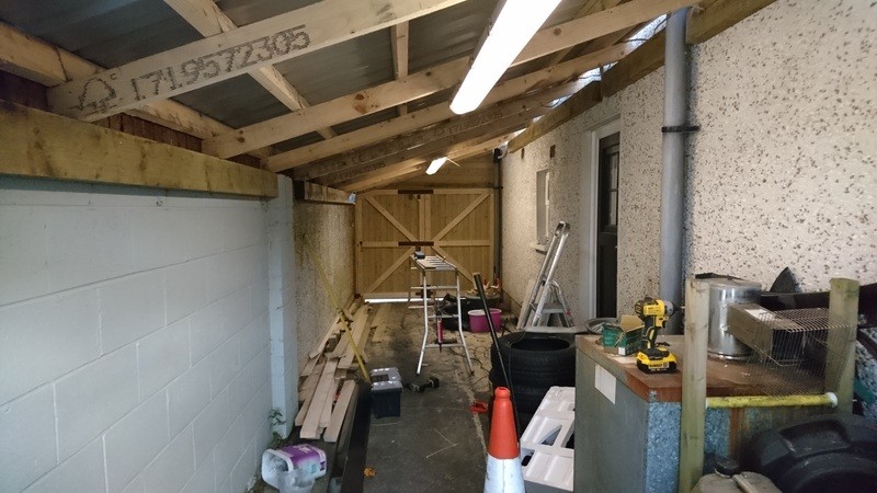

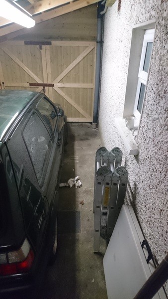

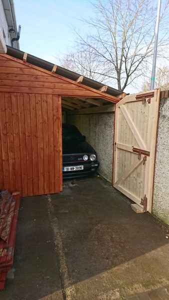

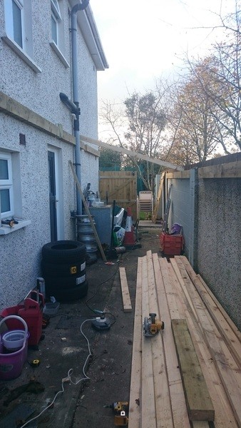

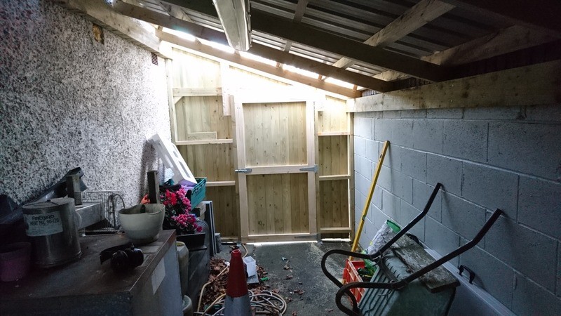

    So in the middle of all of this and with it getting darker earlier I wanted somewhere to store the aul mk2 and be able to work on it in the dry. What started out as simply sticking up a lean to with some clear PVC sheets soon became a project all on its own....
    This was where I was working on the car before the 'lean to' started
    Wall plates up and test rafter
    Rafters and Purlins half way done
    Made up new doors and took down the old rotten side gates
    You can see in this photo also, I am one sheet short. Additional sheet got delivered yesterday so I should have it all buttoned up tight by the end of this week
    Peeka Boo
    Space is still a bit tight but at least its dry and I can stick a blower heater in there.

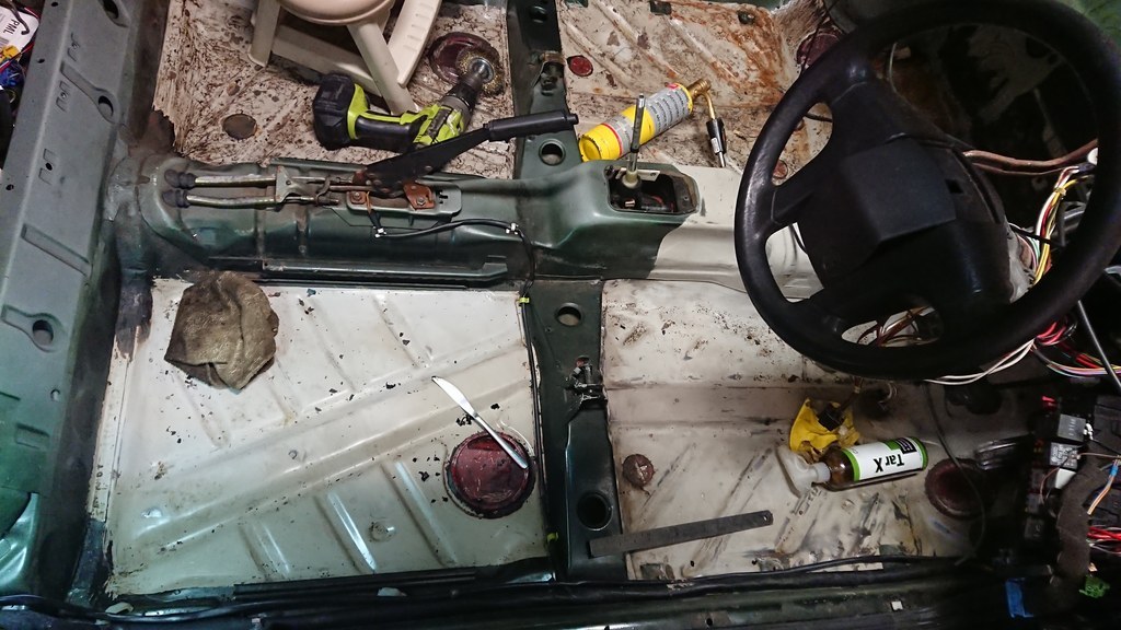

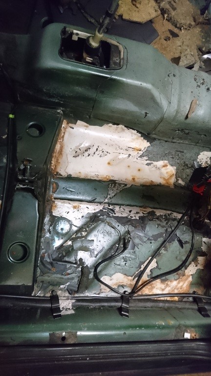

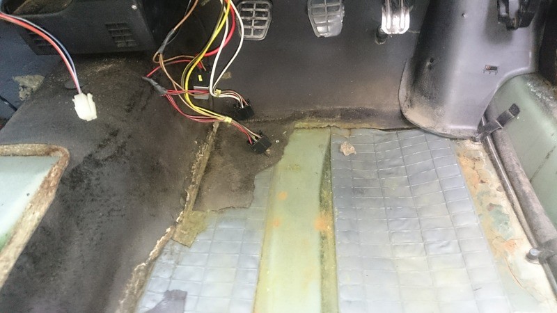

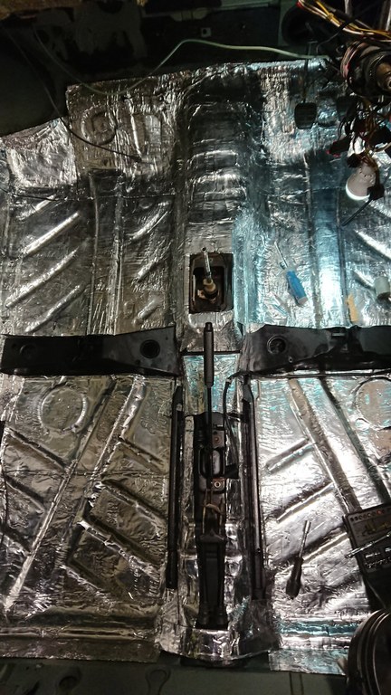

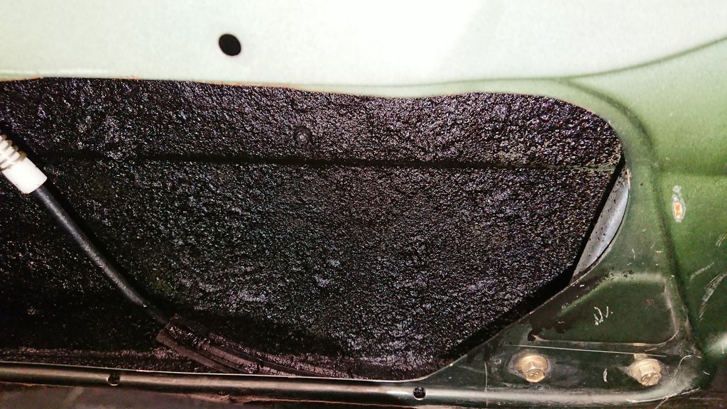

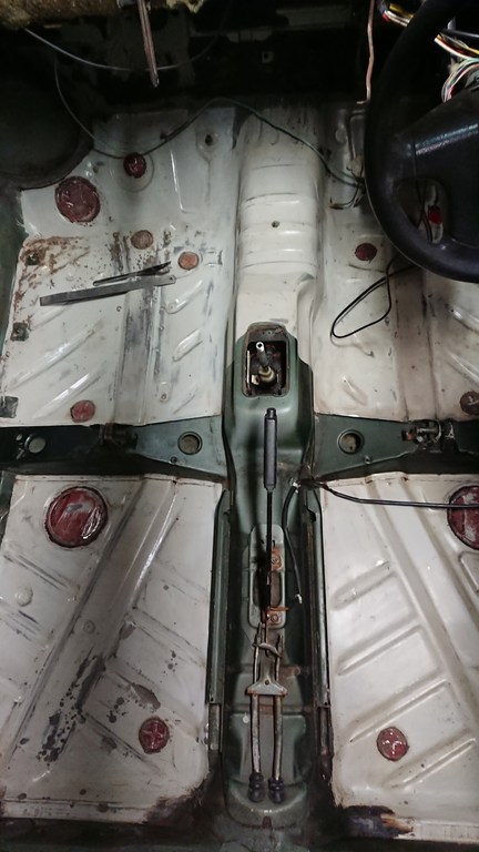

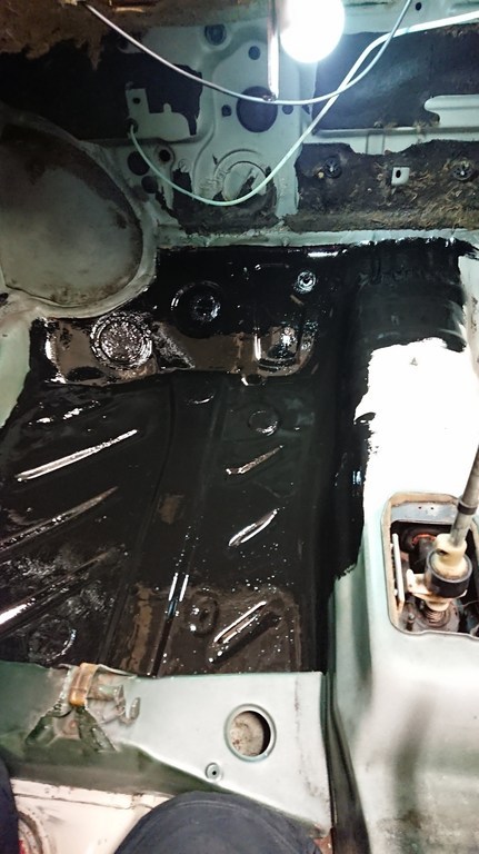

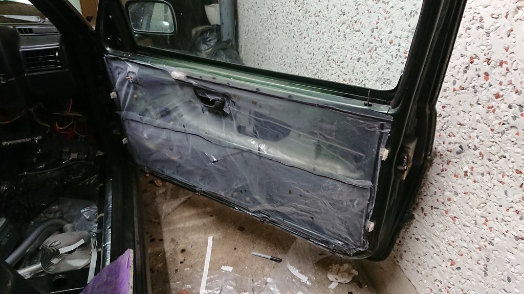

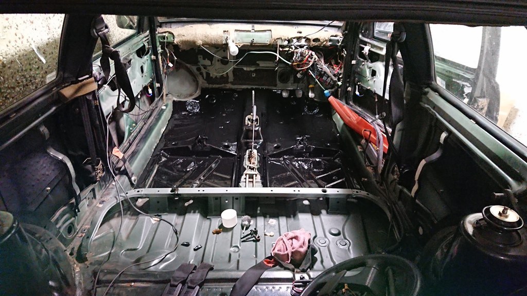

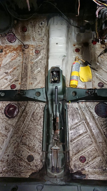

    Progress has been slow and steady on this. I am still working away at removing the tar from the floor pan inside the car.
    I found most of it came up by just scraping away with a steel ruler or kitchen knife.
    Other bits needed a bit of persuasion with the blow torch.
    TarX was also very handy for cleaning up the bits of tar left over.
    This is how I left it last night, might try and do the passenger side tonight.

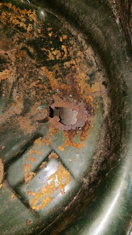

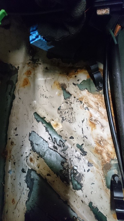

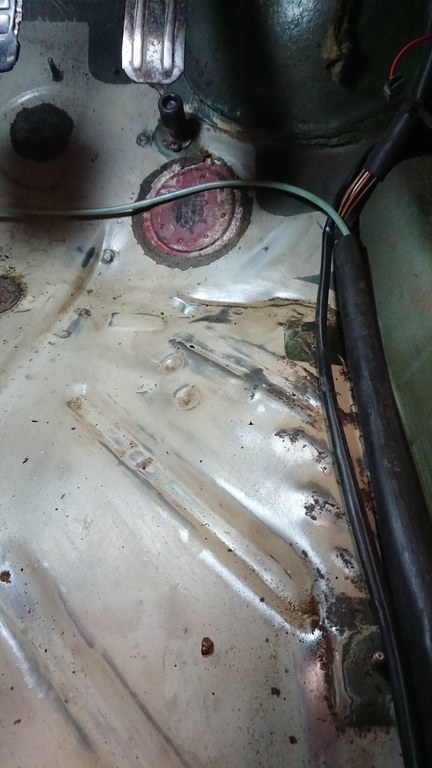

    Alot of the rust in the above pictures was just surface rust and came off easily with a rub of sand paper. I did however find two issues that I need a bit of help with. This is all new to me so if anyone has any pointers on what better way to do things or how to fix the two issues below, please let me know.

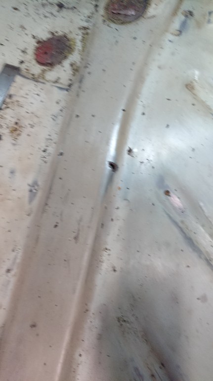

    On both sides of the car, this section of the floor pan seems to have been pushed up. I reckon it was an incorrectly placed arm for a two post lift that did it. The two section are not were the mounting bosses are from the assembly line. Do I try and reshape it myself, get a pro to do it or does the piece need to be cut out?
    You can see the first 45* line from the top has a raised piece. This is more or less the same on the passenger side also.

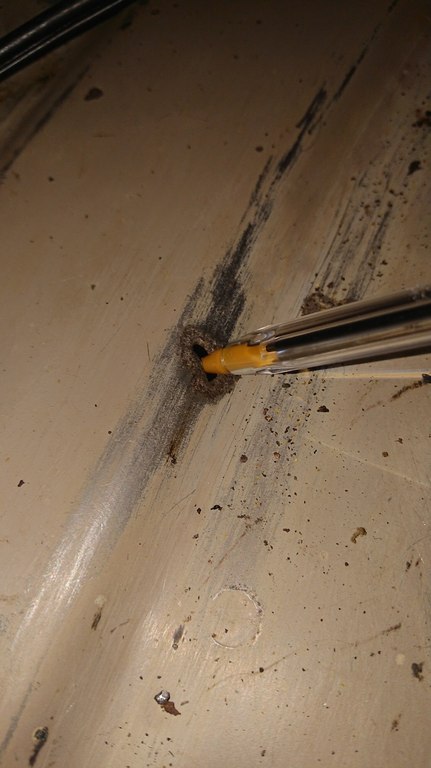

    The second issue I have found is a small hole in the beam that runs from front to back. Will I just weld it up and sand down?
    In other news I sent off my BBS RA's to be refurbished in Wheel Wizards over Christmas.
    There was a good bit of work involved as they were all more or less badly chipped.
    I couldn't be happier with the finish.

    Got a bit more done on the green machine. Sanded and cleaned the passenger side floor pan, so its ready for sealing now.
    I just have to seal up this hole on the driver side.
    I drilled it out to 8mm. This evening I'm going to make up a small metal patch and ill glue it in place with panel sealer.
    I cleared out the rest of the car so that I could check for rust and have it ready for cleaning this evening. Thankfully there is no more rust to be found bar a small bit on the surface under the passenger side tail light.

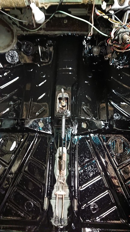

    Got the first coat of POR15 applied last night. It is awesome stuff, I brushed it on but you would never know. It must have some self levelling compound mixed in.
    I forgot to remove the handbrake assembly and wipe down but ill do it tonight now that the rest has dried.
    This was the floor this morning. Pretty happy with it. For a small tin it has some serious coverage! Ill paint on the second coat this evening, let it dry and cure for a few days and then I can start sticking down some new sound deadening. I also went ahead and ordered the Newton Commercial Carpet underlay kit. To go to this much effort and not do it right would be wrong. I can still use the foam underlay I bought to pad out behind the dash and under the rear bench.
    During my cleanup before painting, I discovered this in the spare wheel well :( Ill have to get a cut from another car and have it welded in. Its not the end of the world as at least I can still get the car back together and drive somewhere to be fixed.
    Got a bit more done in the last couple of evenings, painted on the second coat of POR15 on Saturday night and let dry/cure until mid week.
    Stuck down some new sound deadening, maybe I went a bit overboard with it but every little helps sure.
    I added some sound deadening to the firewall as well before sticking some of the domestic carpet underlay to it.
    Heater box back in with new heater matrix and all flaps relined. I had to replace the heater control cables as well as the previous owner had stretched one of the cables by pulling the flap against all of the crude that had gathered at the base of them. You can see the build up in a previous post. RetroSpares came to the rescue again with some spare parts for me.
    And then got the dash back fitted last night. The majority of time taken was making sure there were no snags in wires and then trying to keep the looms as tidy as possible behind the fuse box, its still a bloody mess!
    Next on the list is to steam clean the inside of the doors and rear quarters. Stick some new sound deadening in and then wax oil the lot. Once that is done and the Newton underlay kit arrives I can finally start putting the carpet and seats in.

    Started into wax oiling the doors and quarters last night. I ran out of waxoil so decided to get the driver door all buttoned up. It was a nice milestone to hit as these door cards are replacing the re-trimmed leather ones that were there.
    Wax oil applied
    New membrane fitted with new reusable adhesive, I picked up two rolls from Amazon here
    And the door card fitted with all the bits and bobs. I need to give it a wipe down and hoover but ill leave that until I have the rest of the interior fitted.
    I picked up 3 more cans of wax oil this morning so I should get the other door card back on the passenger side and the cards of the quarters.
