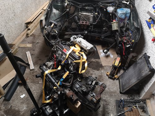

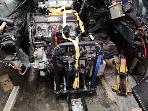

    So shafts off and ready for extraction
    I don't have my engine crane here at home nor did I want to bring it home again. Space is limited and they are a monster even when folded up. So I got creative, I had this trolley in the garden shed that I lifted with the trolley jack.
    And out and it came, simples

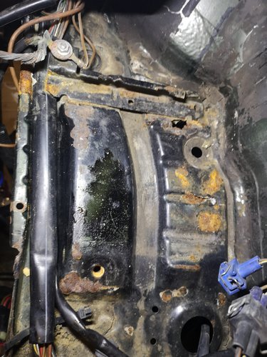

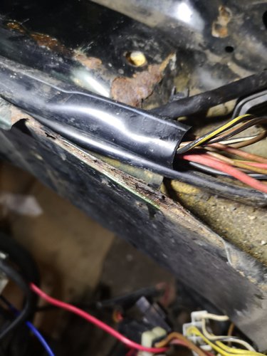

    So this is the extent of the rust. There is a few small areas of surface rust that just need to be sanded back and repainted. The battery tray area is by far the worst though.
    What do you think?
    For this lip on the chasis leg, I am thinking of just building it up with the welder and grind to shape?
    As for the battery tray, should I just replace the small sections or cut out the tray and fit a new one?
    Maybe what I will do is, strip it all back to the metal and see how bad it is first.
  10. rubjonny
    yeah first step grind out all the rot and see whats left. the tray looks pretty good really prob will only need a couple patches

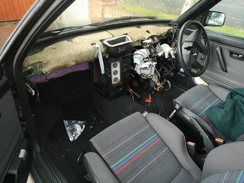

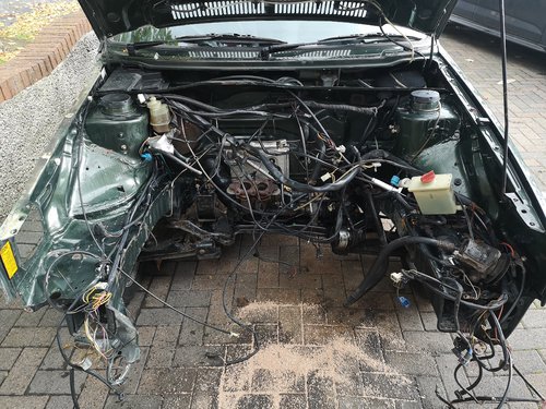

    Plenty more progress has been made over the weekend. All of this prep work is really so that I can work on a bunch of stuff over the winter without having to push the car out each time to remove something. The car will be pulled back into the garage this evening after I take the passenger side wing off.
    I think that because I'm going this far with the strip down, I may as well overhaul the whole A pillar forward. So paint sub frame, refurbish the steering rack, weld the captive nuts on the rear bolts of the wishbone, and I've a list of stuff that I either want to paint or have powder coated.
    Engine split

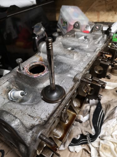

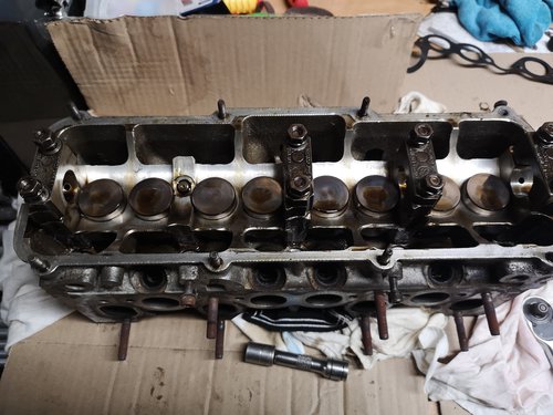

    Camshaft and Valves taken out of the head

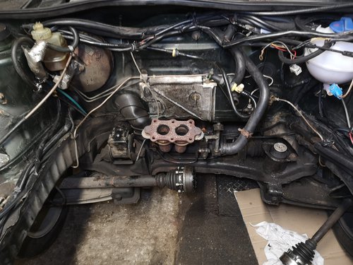

    Scrubbed the engine bay of grease and gunk
    Dashboard out, so that I can reroute some wiring

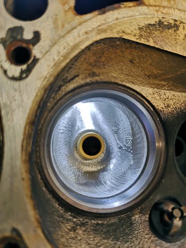

    I'll drop the cylinder head down to the local machine shop tomorrow to get the guides removed.
    After that I can start working on a bit of porting. Managed to bag myself a Metabo variable speed 110v die grinder on eBay for €80, I just need to get some burrs etc now.

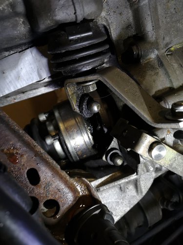

    New grease and boots for the driver side shaft (passenger was rebuilt last year)

    No real updates other than I've gotten the guides pressed out of the head, and the carbide burr has arrived in the post. I'll have a go at some porting this week I think.
