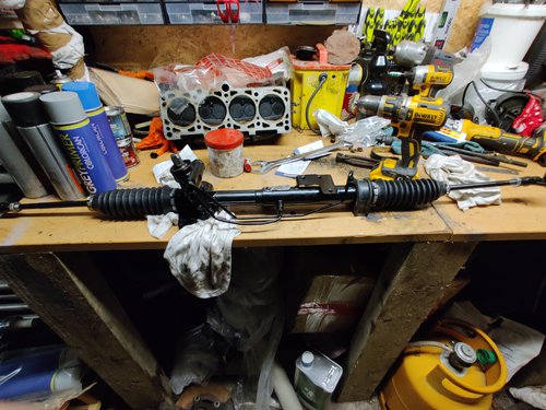

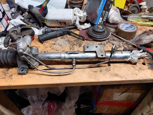

    Nothing much to report. I cleaned up the power steering rack as best I could last night to get it ready for a fresh coat of paint. I've just the section under the bracket where the gear selector relay ball attaches. I've made a right aul mess too!
    A few hours work and I didn't even manage to strike something off the list :lol:

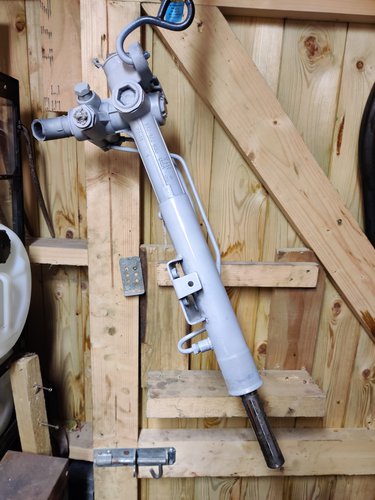

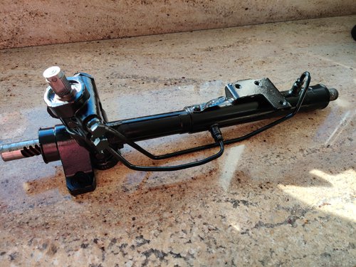

    The steering rack got 3 coats of primer and then 3 coats of gloss black. It came up pretty well.
    Built up the rack with new inner and outer tie rods, new bellows, and new clips.

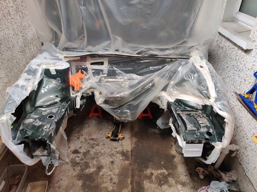

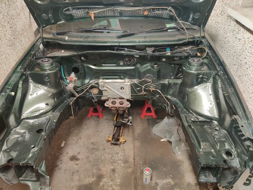

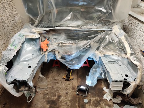

    I also cleaned up some parts of the engine bay that had some surface rust. A few coats of primer, base coat, and clear coat, and I think it turned out well enough. It was my first time spraying something like this, and I've a few lessons learned. Top of the list is that I should have masked off at natural sections in the panels, in this case I ended up with some lines where the old paint meets the new. Not to worry though, I'll know for next time.
    Prepped
    Primed
    And coated
    There is still some rust underneath the battery tray. I'll leave it for now and if I have time I will cut it out and weld in a new piece. For now its painted and sealed so should be fine, if I leave it until next winter.

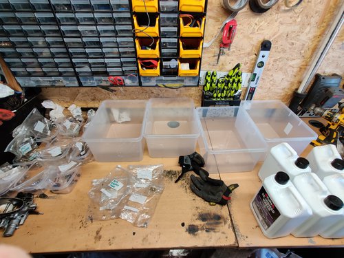

    So as I am still waiting for parts to arrive, I've started to get a system ready for stripping and plating my brackets and bolts.
    Tune in at the weekend to see how it all turns out!
