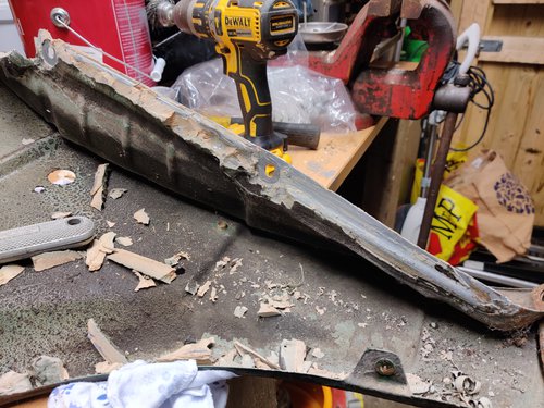

    Cleaned up the surface rust under the driver side A-pillar
    I scraped back the original seam sealer by about a 1cm as I wanted to ensure the new seam sealer created a proper em seal ;) You can also see where I have scraped off the sealer around the seam between chasis leg and cabin. When I was removing the old wing I used a stanley blade to cut through the sealer. What I didn't know was that there was a seam there and I had cut the sealer right on the seam. So to ensure the seal was not compromised at the seam, I cut back about 1 cm from there and scraped some out the seam also.
    Cleaned back the sealant on the wing also to ensure the new sealant will be able to do its job.
    Sealant applied to bellow the A-pillar
    And the replacement wing fitted with new sealant
    As you can see I am no good at body work [:v:] Comments/advice greatly appreciated.

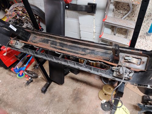

    Made a pile of stuff to get media blasted and powder coated. Aluminum parts are getting vapor blasted.
    Stripped down the front bumper to get blasted and coated too

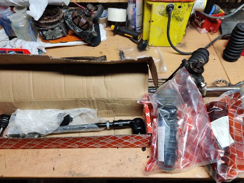

    I then moved on to stripping down the steering rack for a freshen up. My steering felt a bit light so I was fully expecting play in the rack but there was none. I'll have to investigate the steering rack itself.
    I was debating stripping the rack down completely, but from what I have read online it's a whole world of pain, and quite a number of seals that need to be replaced. It seems in good working order so leave well alone.
    I had added new tie rods and tie rods ends to my list of things to buy, but discovered this lovely box of parts that I must have purchased in the past. Nice one! One less thing to buy..
    Next up is to clean and paint the steering rack.
