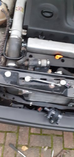

    Almost forgot, in the week got the auxiliary pump out and fitted a mk5 one, much quieter and works, only a pic of old one in process of removing because tea was on the plate, then got dark and rained.

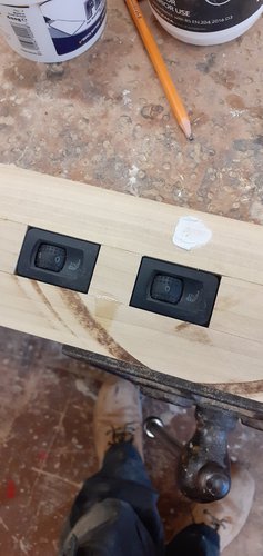

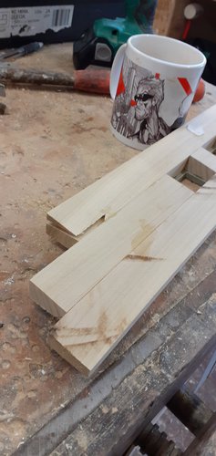

    Not being computer savvy or access to 3d printing I've played with what I know best and gone old school in starting a mount for the seat switches. 20211022_153207.jpg
    Half six this morning made a wooden panel at same angle as the mk4 switches. Bit of sanding to do, followed by cut to size and texture paint and hope it will look OK in the centre console. 20211022_153301.jpg
    Other option may be passat switches and fit in the dash, after slightly enlarging the hole, they sit vertically instead of horizontal, but haven't been out and about to find some yet.

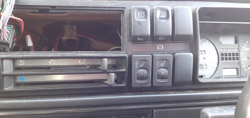

    When I fitted the TT seats the plan was to wire the heating elements up, loom made previously and fitted today, along with passat switches in the dashboard, had to slightly trim the switch holes with a knife as they are about 2mm bigger, loom runs down to the centre console then out under the carpet to each seat, then supply switches with +ve, earth, ignition +ve and illumination.

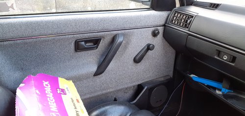

    Swapped the last two door cards between the golfs so Allie's Green one has the complete Driver interior in it, not mismatch. In time I will retrim the white golfs ones to a nice fabric, have an idea, so watch this space. Grey tweed for now though :(

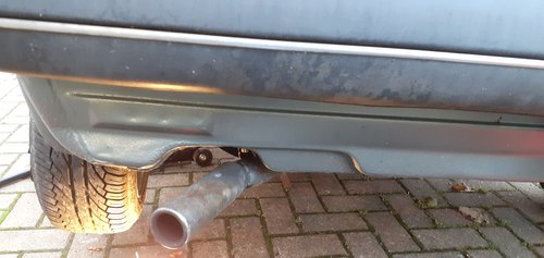

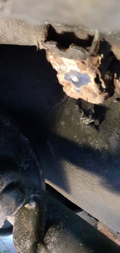

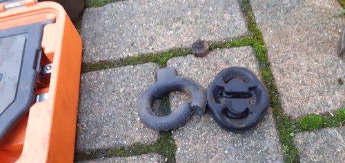

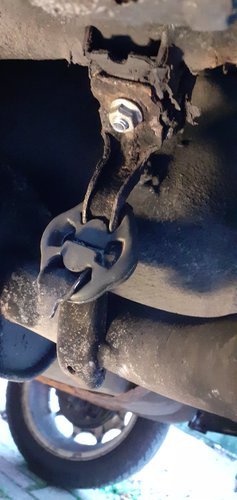

    And after that, I've been getting mrs Dodgys golf ready for its mot, washers topped up, rear wheel bearing tightened (have a new one, just in case it doesn't work) and whilst doing that found another exhaust rubber snapped, the one before the backbox so changed that and thought the rear one looked iffy and the nut holding the bracket was a little loose, went to tighten it and it sheared off, was able to grind flat and drill it out to fit a nut and bolt along with the new rubber. 20211121_151830.jpg 20211121_152559.jpg
    And the offending mounts. Also aerial plug reinstated to the stereo properly as it had been damaged, now replaced and reception good. 20211121_152641.jpg
