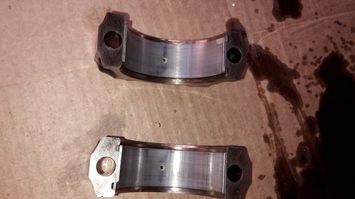

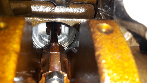

    Some things still bother me, like on cold starts i hear a faint deep knock, goes away when warm that could be piston slap. When i got the block i measured 0.08mm with the new pistons, the manual says 0.03mm. Few days ago i removed the sump and plastigauged the rods(0.038-0.045mm, picture down, side play 0.15mm) and four main(0.030-0.045mm) all were in spec. Could be wrist pin to rod, but my old motor from witch i got the rods was fine, so i suspect piston slap.

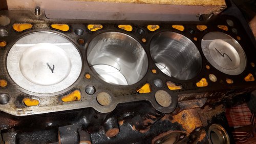

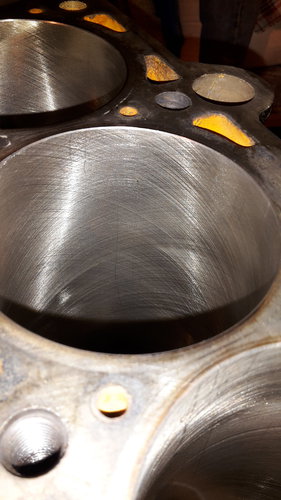

    Another thing is it has low compression, about 8 bar on all four, i could put my finger on the spark plug whole and block the air and even feels like its pulling my finger in, although cam timing is correct. The pistons are still wet with oil after 1000km, does not seem to use oil.
    Ring gap was 0.45-0.50mm.

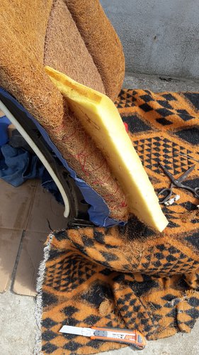

    And i fixed my saggy seats backrests, that grass is rotten, maybe i will fit some of them recaros.[:D]

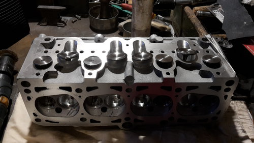

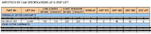

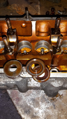

    I ordered a Autotech 270 cam and will modify dual spring seat from GU or AAM head to fit my obd2 AGG head with single spring.
    I have to buy new lifters, are they the same dual spring vs single? I think they are different from what etka says. But again this could have something to do with the valve 7mm vs 8mm.
    Will i be fine with AGG obd2 lifters?
    How about this https://www.skdeziner.com/autotech-...hydraulic-lifter-cylinder-heads-p-132826.html

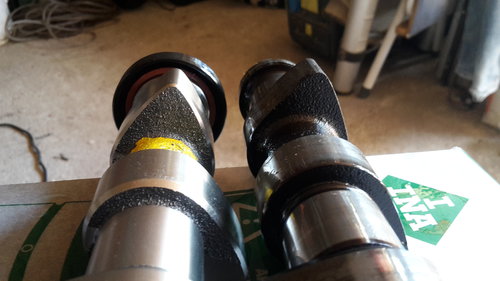

    The cam arrived, i may have gone a little mild on it. Hopefully over the weekend ill put it in with new ina lifters, may fix that piston rattle on cold! [:D]
  13. rubjonny
    yeah looking at etka the tappets change based on age to match the valves & stem seals
  14. davidut5 Forum Member
    Oct 14, 2018
    78
    Romania
    Yes, agg only came with 7mm valve stem so only one part number.

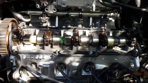

    I have installed the cam, but i am dissapointed. Butt dyno feels a decrease in power. Hehe, i guess it needs a tune and/or adjustable cam pulley.
    Top rpm afr climbs to 15, so looks like fuel sistem is not doing its job.
    Also a good point the mk3 lifters are 20gr lighter than mk2 1.6 ez i had, 72gr vs 52gr.
    I gave up on my ideea with dual springs after i meajured both dual spring 12.1mm until coils bind on the mk3 aam, and 13.1mm on single spring agg head until coil bind.
    Idle got a little worse, not too bad.
    AGG cam has 10.6mm lift and Autotech 270 has 11.4mm.

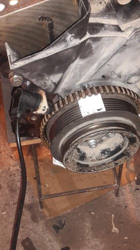

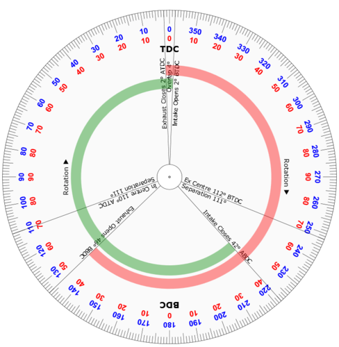

    I have found true tdc using modified spark plug, and flywheel mark is spot on. I have to measure cam lift 180"
    after tdc cyl 1 for cam intake/exhaust valves to be equally open, if i got it right.
    Autotech says cam has 0 overlap but a degree wheel calculator comes up with 4" overlap.
  20. Jon Olds Forum Junkie
    ok, 4 crank degrees when both are closed, quite a mild cam then, so you have to look for full lift inlet at 110 degrees and exhaust at 111 degrees, I think.
