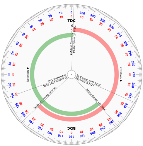

    Lobe centres are 110 on Inlet and 114 degree on Exhaust...
    Infact you could say its both on 112 degree and 2 degree advanced at the cambelt pulley > the inlet opens sooner and the exhaust close sooner
    Altough here the 2 degree advance has been been done on the cam itself ( location of the cam pulley )

    Okay so exhaust close was off by 4 degrees, it is negative two.
    First i have to fit the printed diagram with 0 to tdc, then align intake center at 110atdc on diagram, after finding intake center with a dial gauge. This should be good, maybe check the exhaust center too. :thumbup:

    Dont worry, set the Inlet @ 110 and ignore the exhaust... as there is nothing you can change to the exhaust timing on a 8V...
    Its a base setting to start with, for best performance you can try some degrees advance or retard to find maybe a few extra pony`s > as long there is enough safe distance between valves and piston

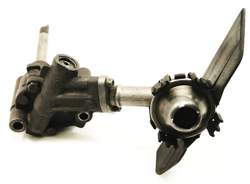

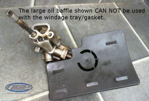

    When i replaced the oil pump i replaced the oil baffle from the 2.0 which has oil squirters, could this affect oil splashing cylinders to alter cylinder lubrication? The 2.0 oil baffle is bigger, covering most of the crank.

    If its a roadcar, both the large plastic from the 2.0L engine OR the ABF windage tray will do.... and avoid the crank is slamming into the oil

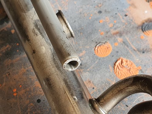

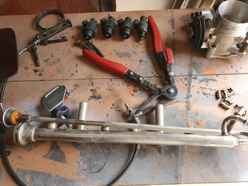

    Found the problem, never seen, heard, or expected this! Broken injector rail! Internal return pipe going to regulator broke, so all pressure escaped to the tank via return.
    I think it had a leak for some time as it took some turns to start, so pressure dropped to 0 every time. In time it broke completely so fuel pump could not keep up with the leak.
    Turns out fuel pump is very good, got up to 6bar.

    How is this possible without leaking ? Weird ! Glad you've found the problem...
